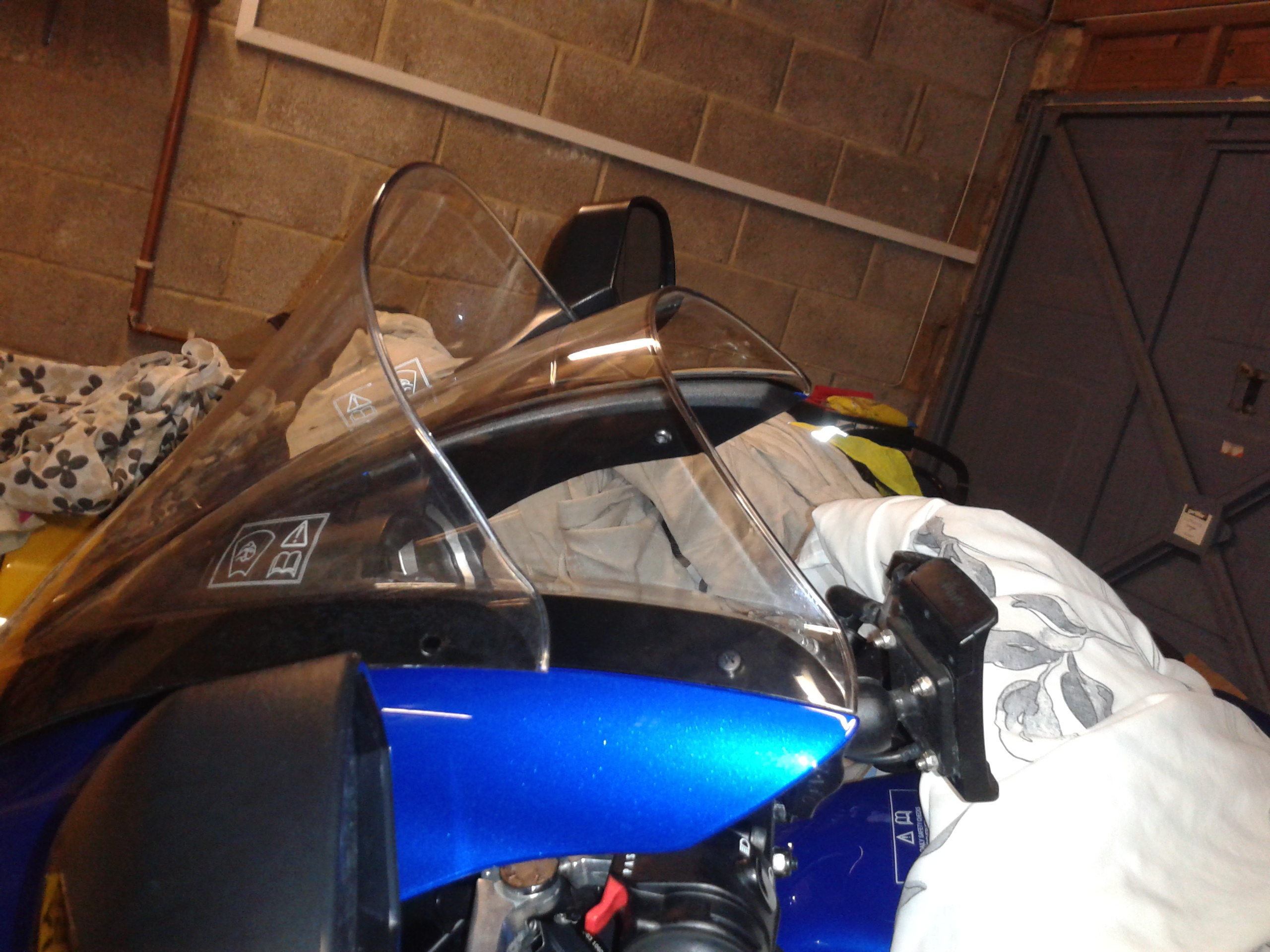

    That's probably part of it, but I'm not sure it's the whole story. I tried crouching right down behind the screen expecting that the flow would then be directed above my head, but I still found it very noisy. The touring screen that my bike came with curls up towards the vertical, possibly affecting the quality of the air that it sheds as well as where it directs it. You can just make out the profile of the touring screen in the image that takes you to this Sprint section of the forum. Is this similar to your zero g screen?
    Here's a photo showing the two screens.

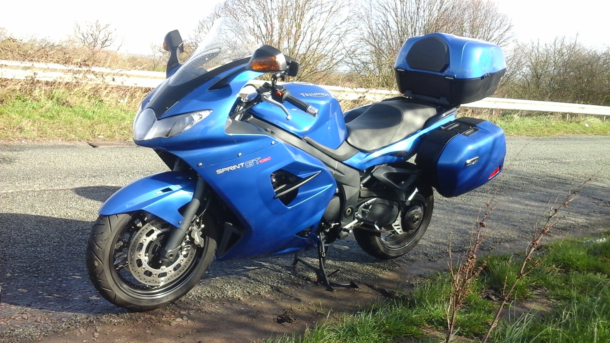

    And here's a photo, as promised, showing my bike in all is glory. Touring screen fitted.
