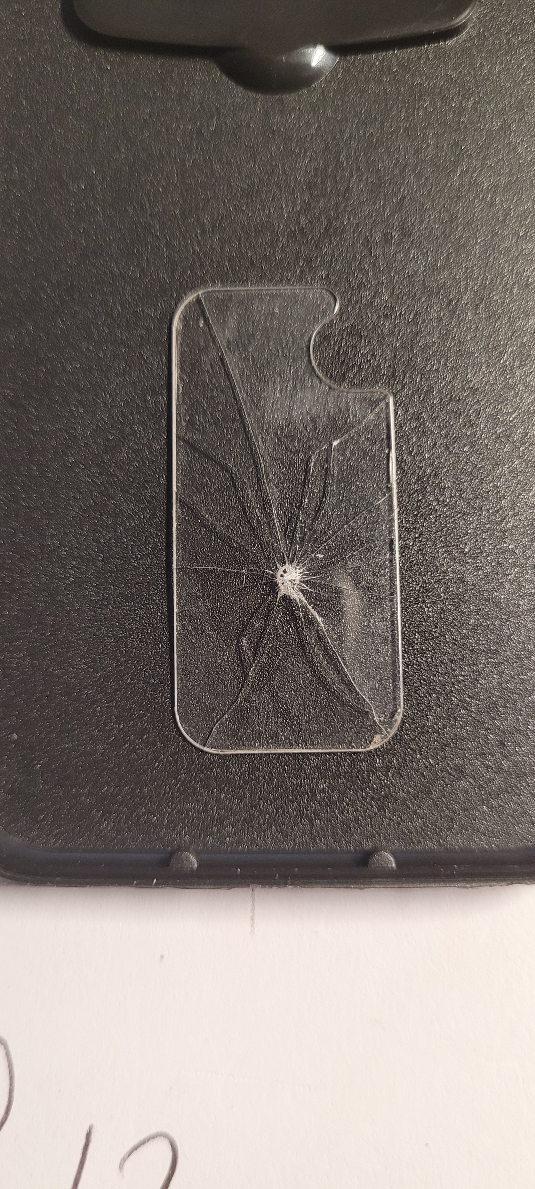

    [QUOTE="Eldon, post: 648268, member: This means the phone sits in landscape with the camera lens nearest to the clutch lever..... bad idea!
    The run out above has again damaged the camera lens. This is the 2nd time this has ocurred. The first time it chipped the actual lens hence after replacement I fitted a lens saver.
    Hopefully this time its only the protector as I've just ordered the replacement.
    £2.99 protector
    Lens last time, was £20
    Beware![/QUOTE]
    Here you go for a pic.
    This is a Samsung S20 camera lens protector changed tonight and hit on last Sundays rideout.

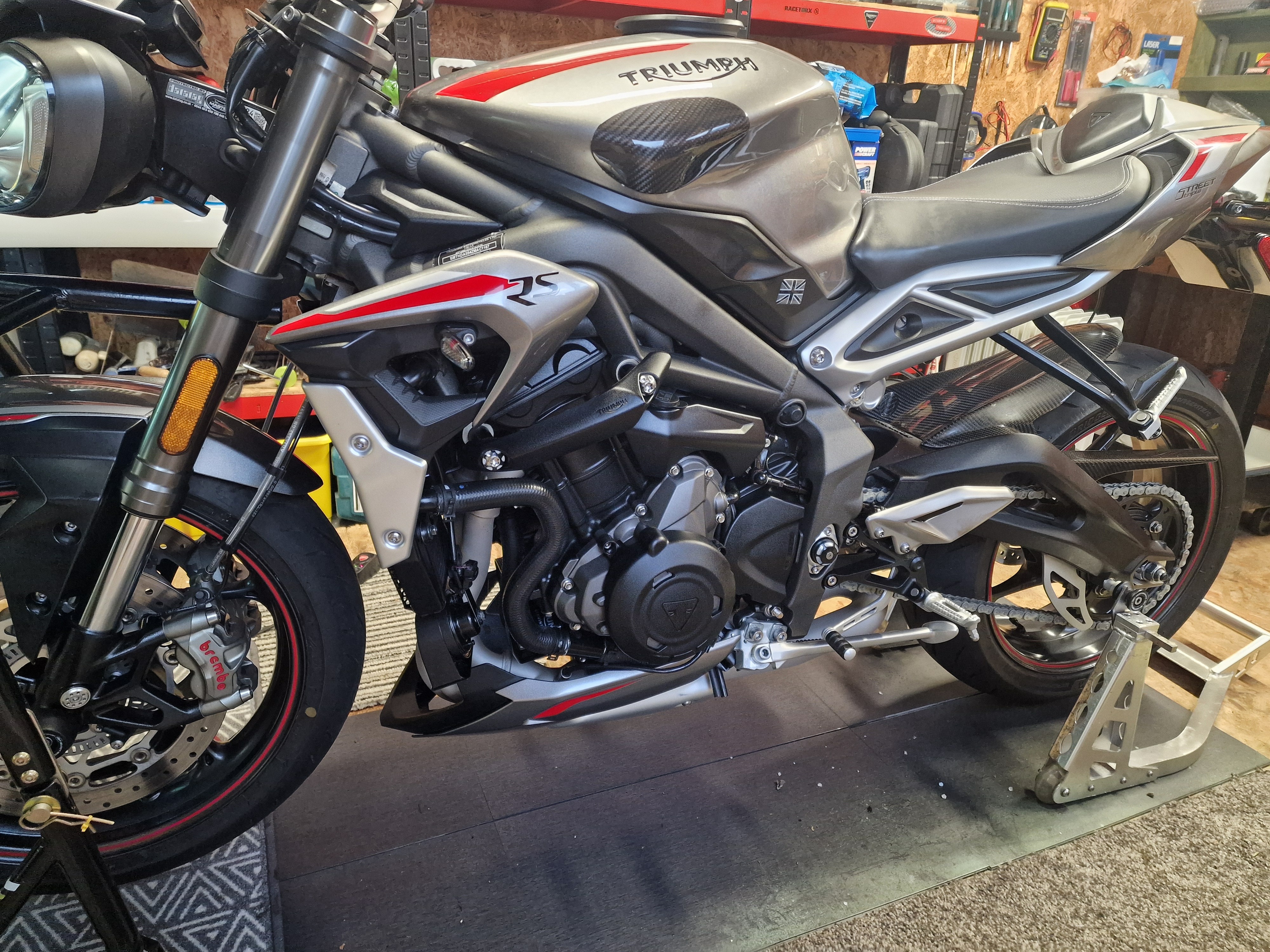

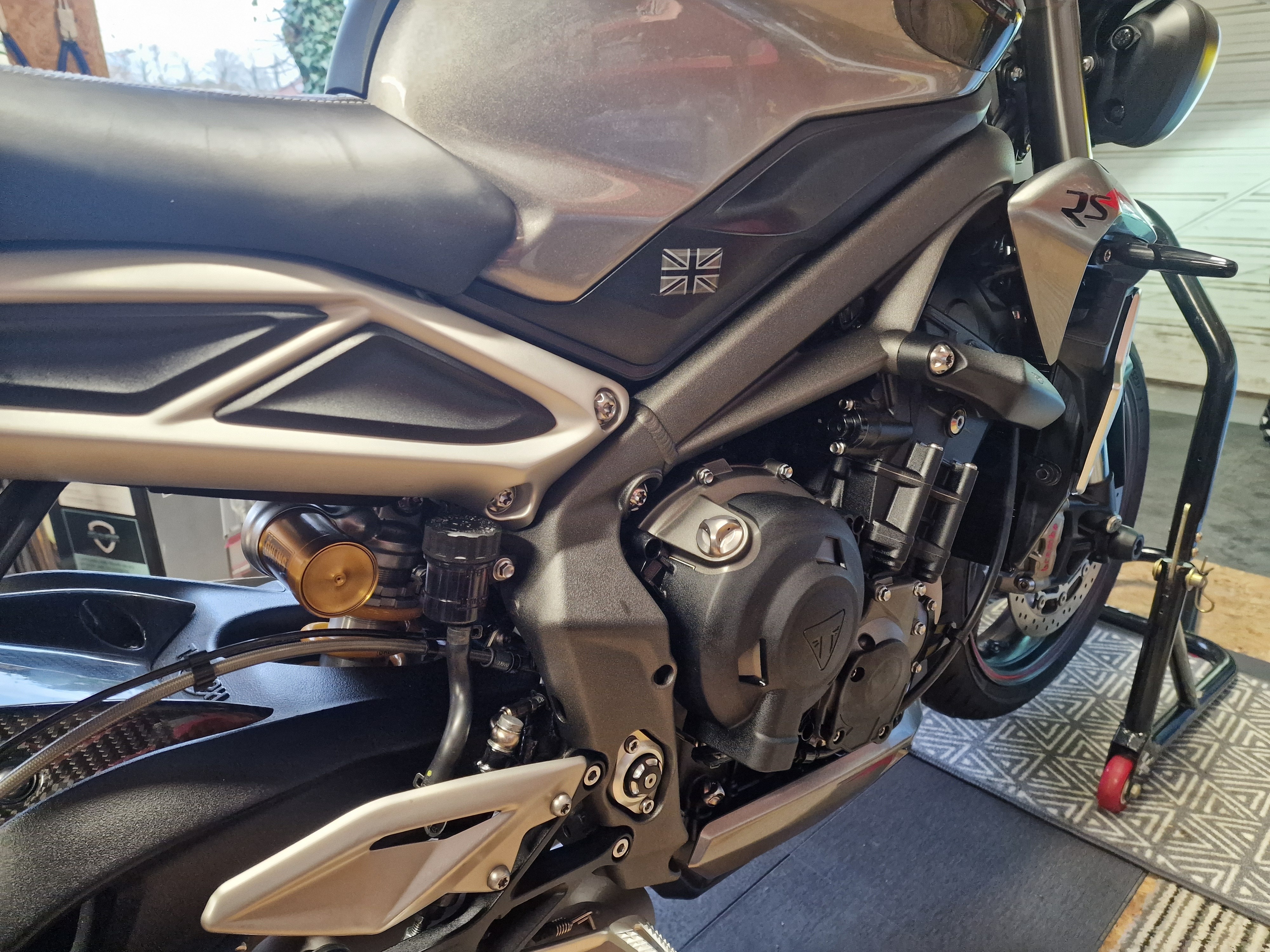

    Well, not quite " mine" now, but was.
    The radiator had sprung a leak and so a spare from a friend was purchased.
    Whilst me (dad) set to resolving the old one, eldest son set to fitting the replacement.
    This was the issue, the threaded boss, which apparently is quite a common leak area.
    This is after I'd solder repaired it.
    He fitted the replacement.
    All pipes on ;)
    All bolts tight ;)
    What do you think dad? :blush:
    Err, well it would've been better if you'd fitted the fan first :joy:
    By which time I'd finished the rad repair so the original went back on :cool:

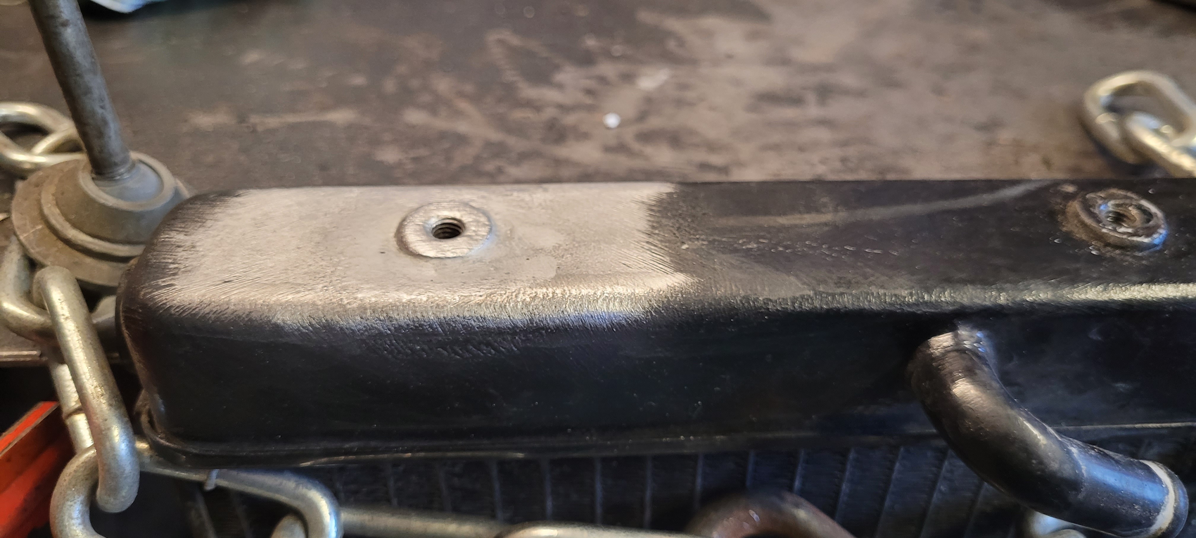

    @Iceman thanks, although I've already completed it last sunday.
    I used an Alubuild 300 product that has a 300⁰C melting point and uses no flux.
    The top nutsert fitting had a very minor weep, which apparently is quite common, have you come across that before?
    Here's the soldered job prior to painting.
    And the finished item being rebuilt.

    Hi Eldon, yes I have seen it before, mainly on Street Triples, glad you got it sorted.
