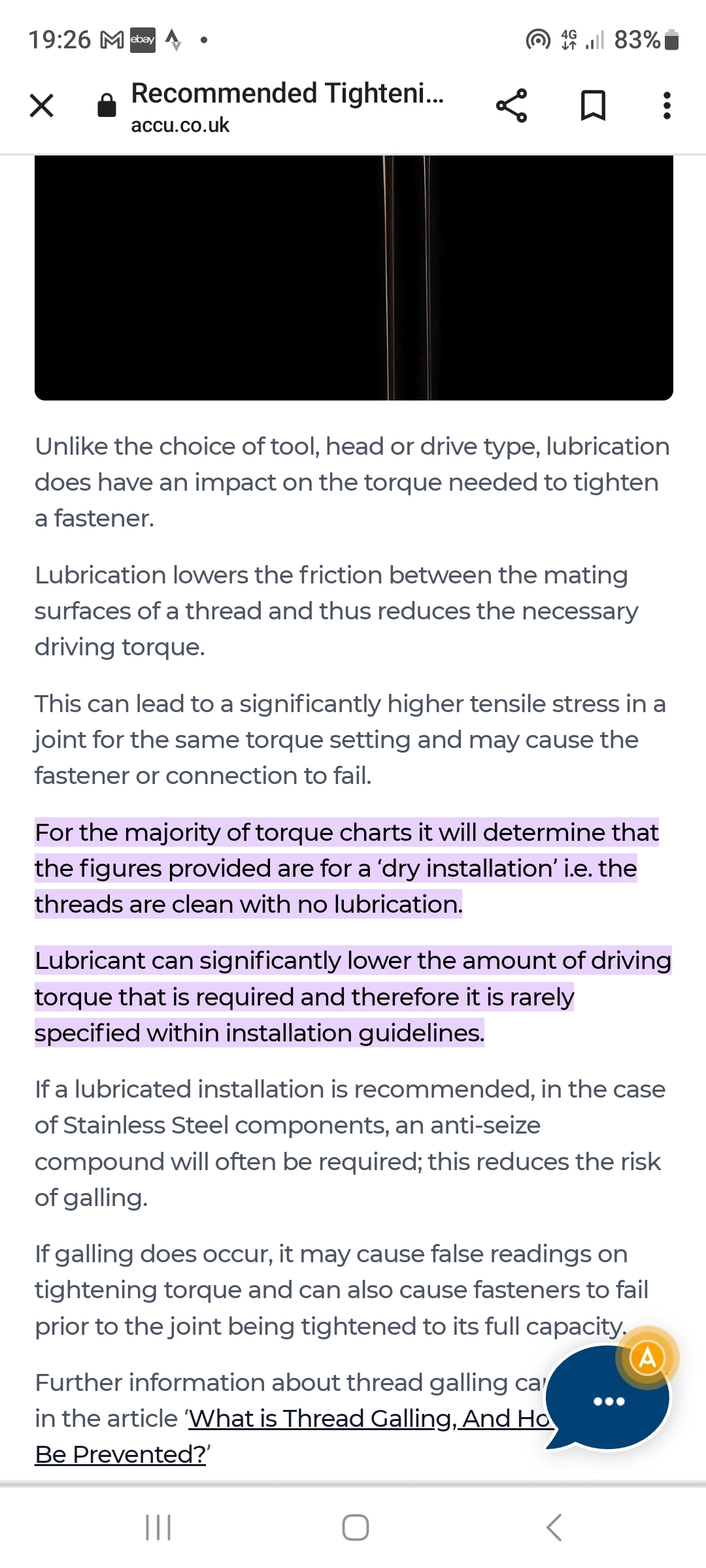

    The conflict here created is the torque setting of a dry verses greased fitting.
    Naturally when a fitting/bolt is greased it will be tighter with grease on, even if torqued to the same setting, so the use of a torque wrench is something of dubious value.
    Personally I put plugs into alloy heads with a touch of grease, to minimise dissimilar metals corrosion, then nip by feel using a short grip on a ratchet.
    Each to their own, but you using grease and a torque setting is of debatable value.

    Interesting, so would you suggest the torque value in the manual is based on a dry plug (even though lubrication is the norm) and should be reduced to say 10 Nm, rather than the recommended 12 Nm value being based on a lubricated plug?
    A question to triumph (in fact every manufacturer) maybe that applies to multiple fixings that are assembled with a lubrication applied as part of build up.
  8. Eldon
    Eldon Elite Member
    6,752
    Simple answer yes!
    I agree with what you wrote there.
    Friction is the real issue here and lubrication is skewing any provided torque settings.
    I had a similar discussion years ago with someone regarding car wheel bolts. I always put a very slight trace of grease on the thread, being careful to keep it off the conical seats as that's what locks the bolts/nuts. Torque applied to the bolts will now make them tighter than intended by the manufacturer but seeing as we are discussing steel bolts into steel threads then I don't see it being an issue.
    Into alumuinium alloys i.e. spark plugs, it may be wise to back off the torque setting slightly as you suggest. ;)

    Dry versus lubricated threads.
    @Boothman et al a quick Google search popped this up for info.
