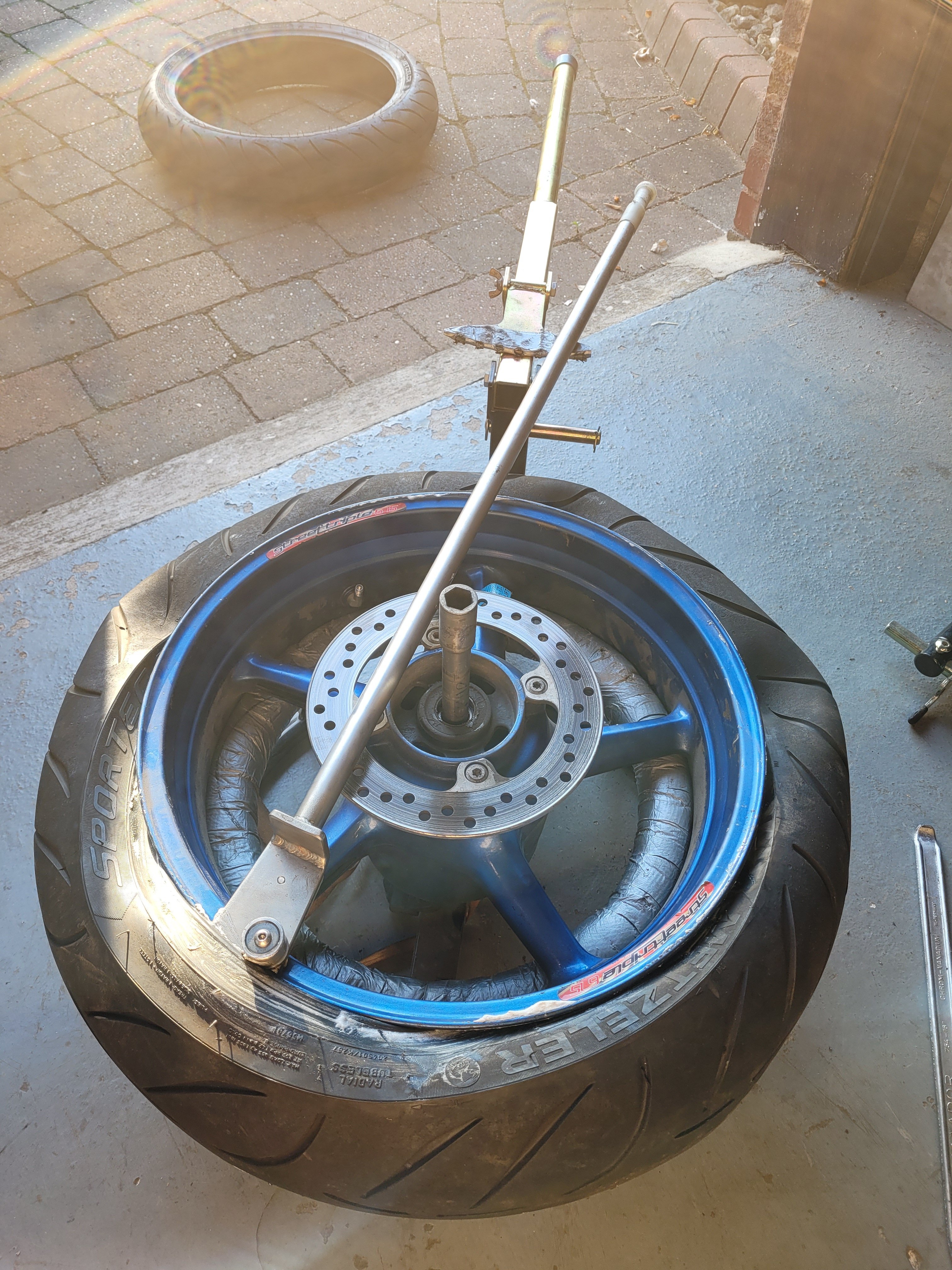

    So decided that the other day was the last one this year for the 765 and time to bring the 675 out.
    Both are due an mot in September and it seems pointless with the 765 just parked in the garage over winter so sorn done, rebate being processed and then tax the 675 tomorrow, 1st September.
    Mot booked for Friday so time to get it ready. It was wearing a set of Racetecs which are great in the dry but not so good in damp patches under trees etc plus they've had their day. A quick browse through the rack and I've got a choice of x2 sets of new Michelins or a set of near new Metzeler RRs.
    Decided to fit the RRs as had these on a 675 before.
    A mate had bought a new tyre tool which looked a good design so I'd borrowed his powdercoated mild steel item, blatantly copied it and made myself a fully stainless steel and plastic version. This provides fully plastic coated contact with the rim coatings.
    Two tyres off and two back on. Quick fiddle with switches, horn, brake lights etc function check. Dip oil and check coolant then we're good to go.
    765 sulking round the corner.
    Proper recycling, note old previously crashed (was bent) 675 front spindle now machined down and providing centre pivot for tyre bar.
    One down, one to go.
    Adding a bit of knurling to aid grip for when, not if, blathered in tyre soap :rolleyes:

    Without the simple tyre press, breaking the bead is nigh on impossible without marking the rim. With the over the centre arm, a simple press and the bead pops in a controlled fashion. I have added further pipe cladding to the lower support ring so that side is well protected.
    The problem then is levering over the visible area of the powdercoated rim without marks or scratches. Plastic cut pipe things can be used but they are not only a faff but not infallible i.e. slip off and away we go.... oh FFS :worried:
