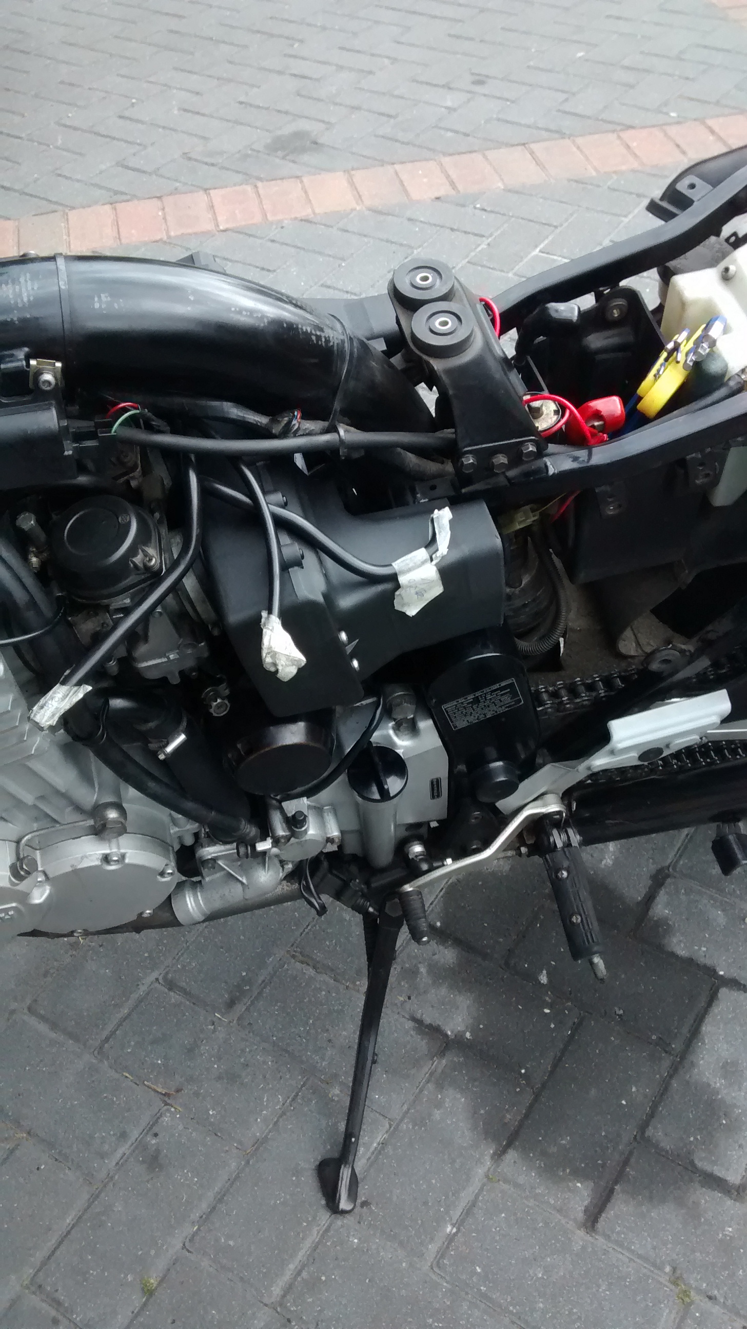

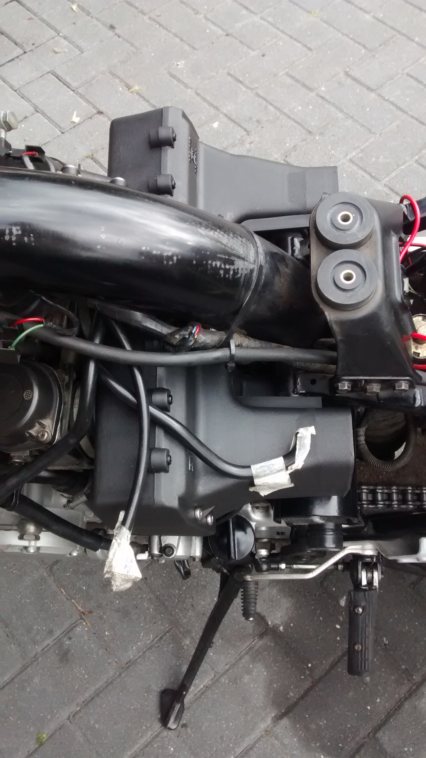

    Finally got round to replacing the air filter on the Trident, having put the job off for a week or so. As many on this forum will know, this entails replacing the whole airbox assembly which is in effect a sealed unit. I know you can split them and fit a K&N filter but I went for a complete replacement.
    It is a bugger - there's no way round that - tank off, hoses disconnected, throttle and choke cables disconnected at the bars, carbs off (slide out on LH side) and old airbox out. (and very little room to do it in).I fitted new rubbers to the carbs and the box as the old were a bit brittle and cleaned out the two "witches hat" fuel filters in the inlet hoses.
    Tips for puttting it all back.
    1. Fit the crankcase breather pipe to the front of the airbox BEFORE you put the carbs back! (or you will be taking them off again).
    2. Fit the carbs to the head first and tighten the clamps and then try (haha!) to fit the airbox onto the carbs. Warming the rubbers with a hairdryer finally did it for me and the use of a little washing up liquid.
    3. When refitting the two halves of the throttle control and trying to keep the cable in place - note that the forward most half has a stud on it and the bars have a corresponding hole in them so it only goes on in one position.
    4. Route your inlet and breather hoses properly when fitting the tank back on - make sure they are not trapped or twisted.
    5. Best to label these when taking them off (masking tape works) see pics. You have two inlet, two breather and one vacuum pipe.
    Good luck to anyone else trying this! Have cold beer ready! IMG_20150716_174549267.jpg IMG_20150716_174554146.jpg
