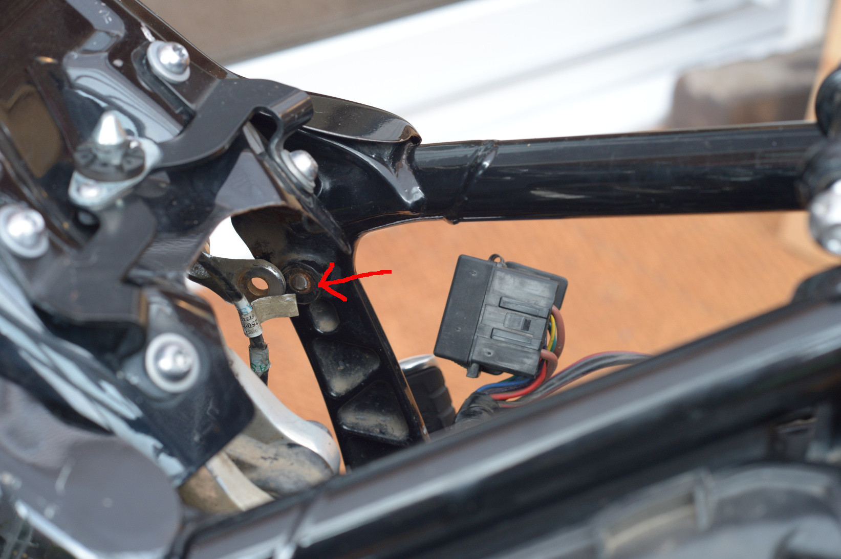

    On getting back I found the top bolt of the two holding my left pannier rail had fallen off and pannier was flapping about. The bolt also holds left air box and clip for wiring but all seems OK. It's come loose before and I had I tightened it after using threadlock about a year ago but that was obviously not sufficient.

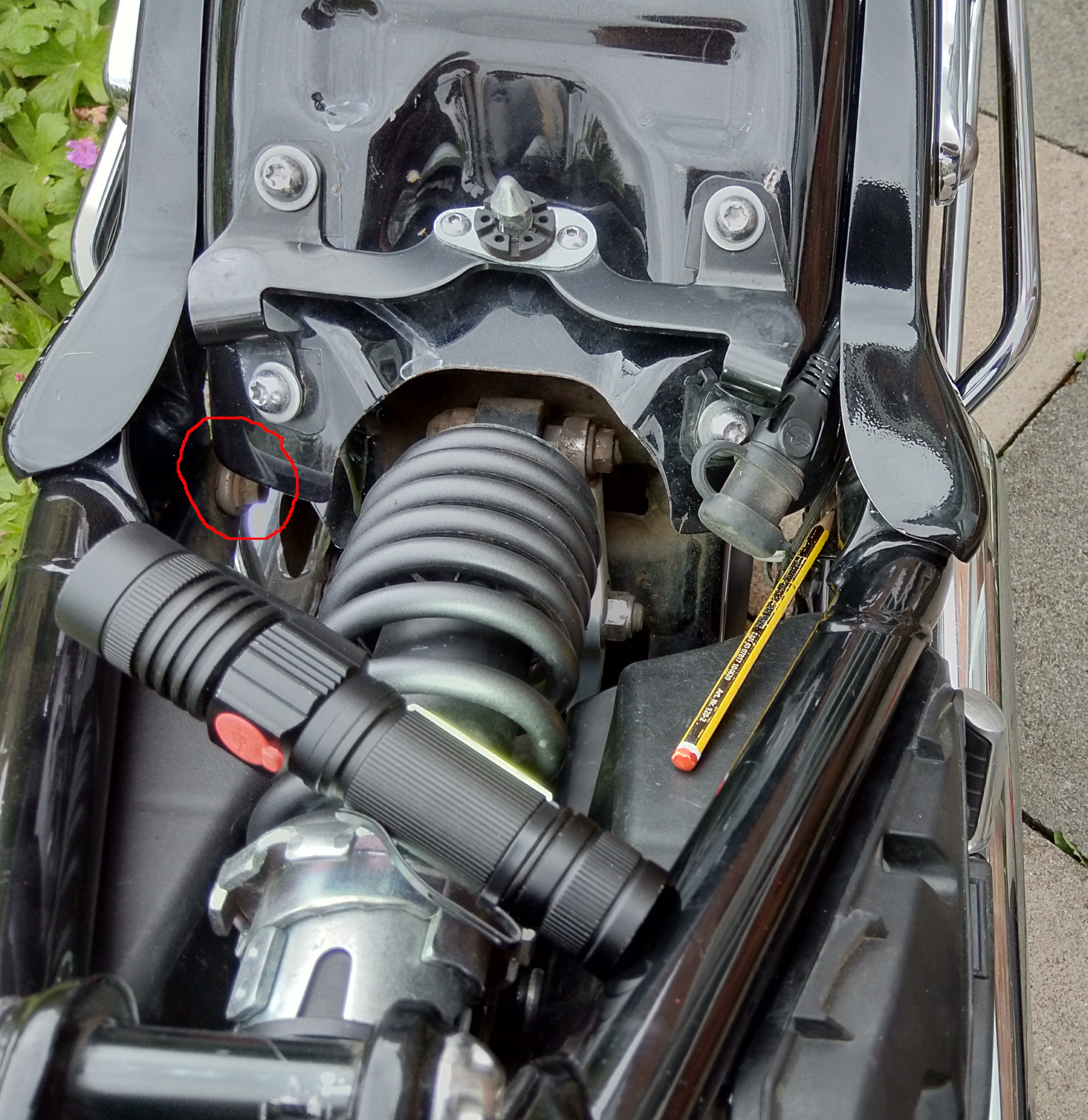

    So, today I came to replace bolt that 'dropped out' only to find it had sheered off level to frame :sob:
    So I have a sheered bolt, in a blind hole on the inside of the frame, which is inaccessible to tools without removing the whole back end probably. Going to have to find professional help for this, and someone willing to take on such a horrid job.
    In pic below, pencil points to sheered bolt, red circle is the good one on the other side.
    • WTF WTF x 2

    Yeh, local bike mechanic spent a couple of minutes looking over things and came out with what I thought when examining the problem, i.e. nigh on impossible to access, and 'what a shit design'. He suggested going to an engineering place he uses for difficult stuff, but on reflection I think I'd be happier trying myself. I'm retired and have nothing else to do, so can take days meticulously dismantling rear end and trying things out.
    As the airbox seems pretty well mounted by the front bolts, if I can't extract or drill out the sheered bolt satisfactory, I can come up with some bracket for the airbox attached to other fixing bolts. That would then mean having to bodge some pannier rails attached to other parts of bike for use when touring.

    drill and tap the other side?
    By going clockwise on the opposite side, it'll be anti-clockwise on the other side?

    Hole doesn't go all the way through unfortunately.

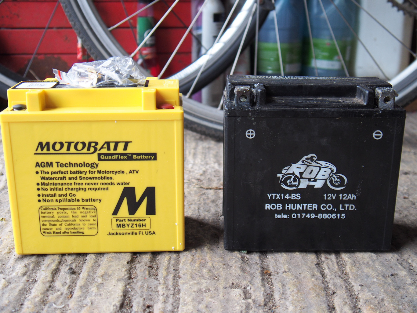

    Finally got round to replacing my 17 year old battery in my trophy. I thought I might be pushing my luck going for 18.... Old battery still came up good on my optimate charger but it felt like it was turning the engine over a little slower than normal when cold. I tried to get a higher capacity Yuasa battery from halfords click and collect but they incorrectly tried to give me a lower rated battery at the checkout. I guess it's easy done as the only difference in model number is the inclusion of an H. Anyway they couldn't get the H version for 2 to 3 weeks so I used tayna.co.uk. They had a motobatt version for less so I went for that. It was great service ordered late friday, delivered sat morning.
    Took the opportunity to install the optimate charger lead as I've always taken off the seat and used the crocodile clips (for 17 years as I bought the charger at the same time as the battery....). The new battery has 4 poles so I thought I'd be smart and connect the optimate lead to the spare 2 poles. I hadn't really thought it through as the poles on the motobatt were lower than the battery case. So I cut down and filed some bolts to fit, doh, fly leads wouldn't fit because they hit the battery box sides... So I had to bodge a fit with longer bolts and a nut to lift the connectors above the case... I should have just used the 2 other poles which had a C frame added to lift the terminals up above the case already. But being pig headed has always been an attribution of mine....
    Only drawback so far is that it's 0.5kg heavier than the old battery and considering the trophy is a bit heavy anyway it's not the best idea to add weight.

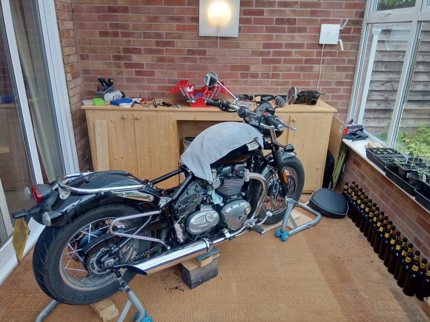

    Today I wrestled bike into the conservatory using makeshift wooden ramps and a 33 point turn, so I could begin work trying to extract sheered bolt.
    After removing left airbox and rear shock I realised that swingarm didn't drop enough out the way to allow access for drilling out bolt, only 8cm clearance until the suspension linkage mount,
    I'm not sure I want to remove swingarm, probably would with the help and moral support of a mate, who also suggester an option of him welding another bolt on for extraction purposes.
    For now, I'm resorting to beer again, and seriously considering just making bracket for airbox and making my own pannier support attached to other places. (Would be more suitable for my panniers too).
    Tomorrow I may try the extremely long shot of cutting slot in end of bolt stub and using screwdriver bit in ratchet to unscrew it. Could use clamp or other method to hold bit in slot and help stop it turning out.
