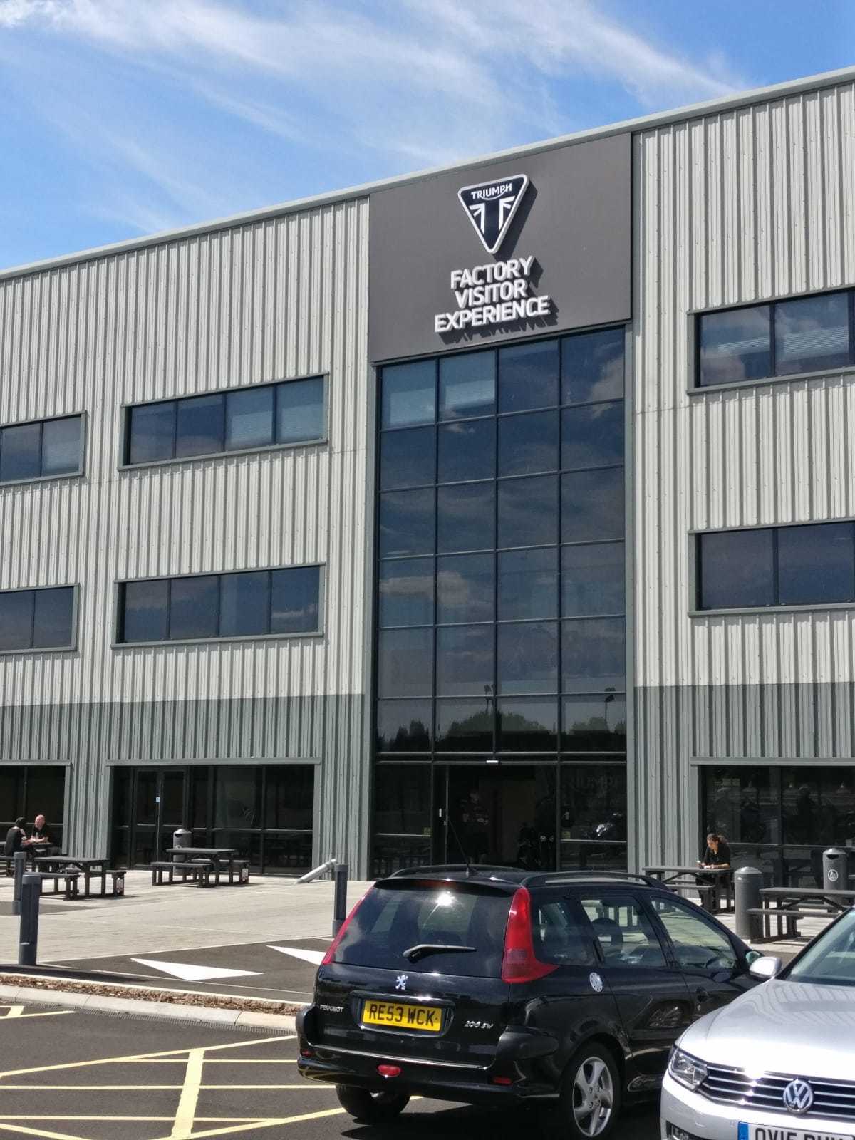

  4. Rspete
    Rspete Elite Member
    Jun 17, 2018
    1,794
    743
    Durham
    Went to the triumph factory to see how they're made, Was absolute class.

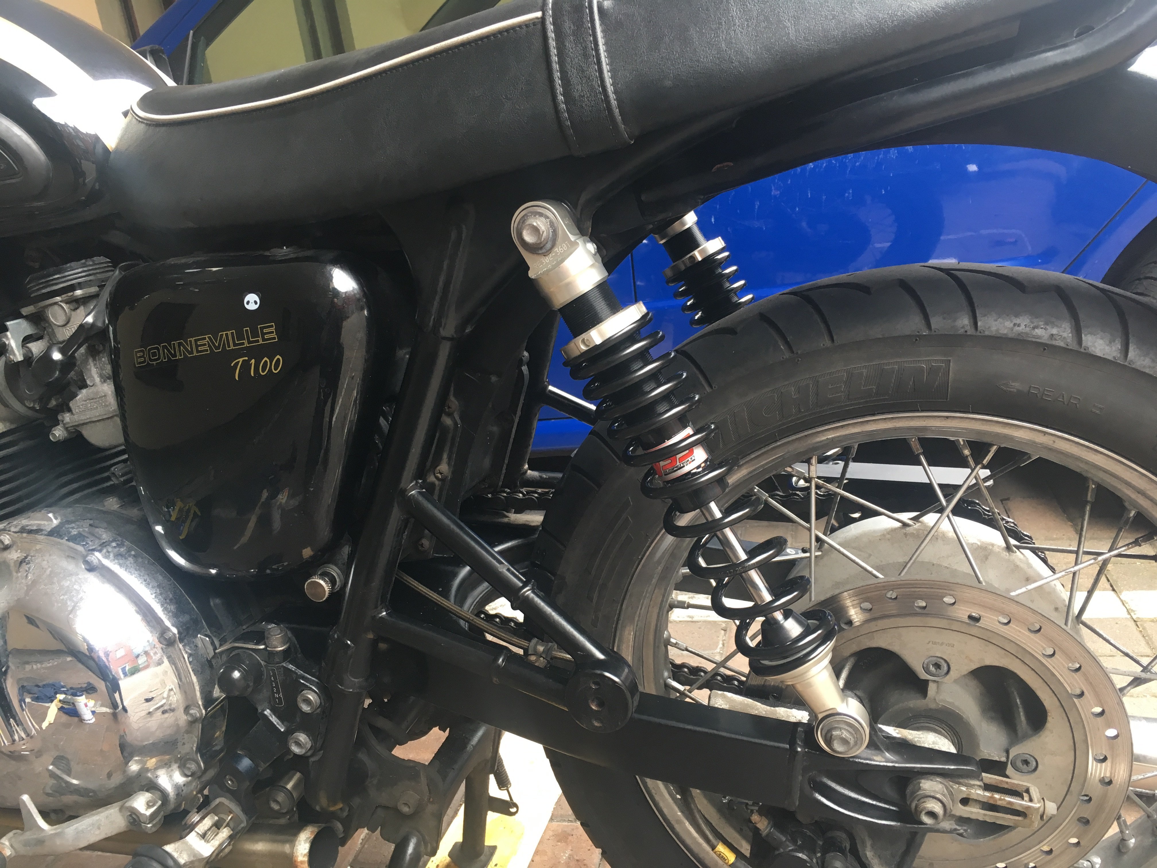

  7. Mischa Vladivostok
    Mischa Vladivostok Well-Known Member
    Feb 9, 2015
    234
    Dublin, Ireland
    Job done. And a real improvement, I have to say.

  9. Mischa Vladivostok
    Feb 9, 2015
    234
    Dublin, Ireland
    It doesn't make any difference, and the instructions from TEC were very clear about that. I mounted them that way to improve the view of the back wheel.
    That's just a gas cannister, supposedly to prevent the shocks from bottoming down. A very leaky gas cannister. o_O
    (web searches show a lot of people had the same problem, even though they mounted the shocks "the right way".)

  16. Rich Bryce
    2,993
    Jock Stew ended up riding with a completely empty one. It made his bike dangerous to ride. George at TEC has built his reputation/USP on low cost value, but too often the components and complete builds he sources are too shoddy. There are some components on bikes that you should not compromise on.
