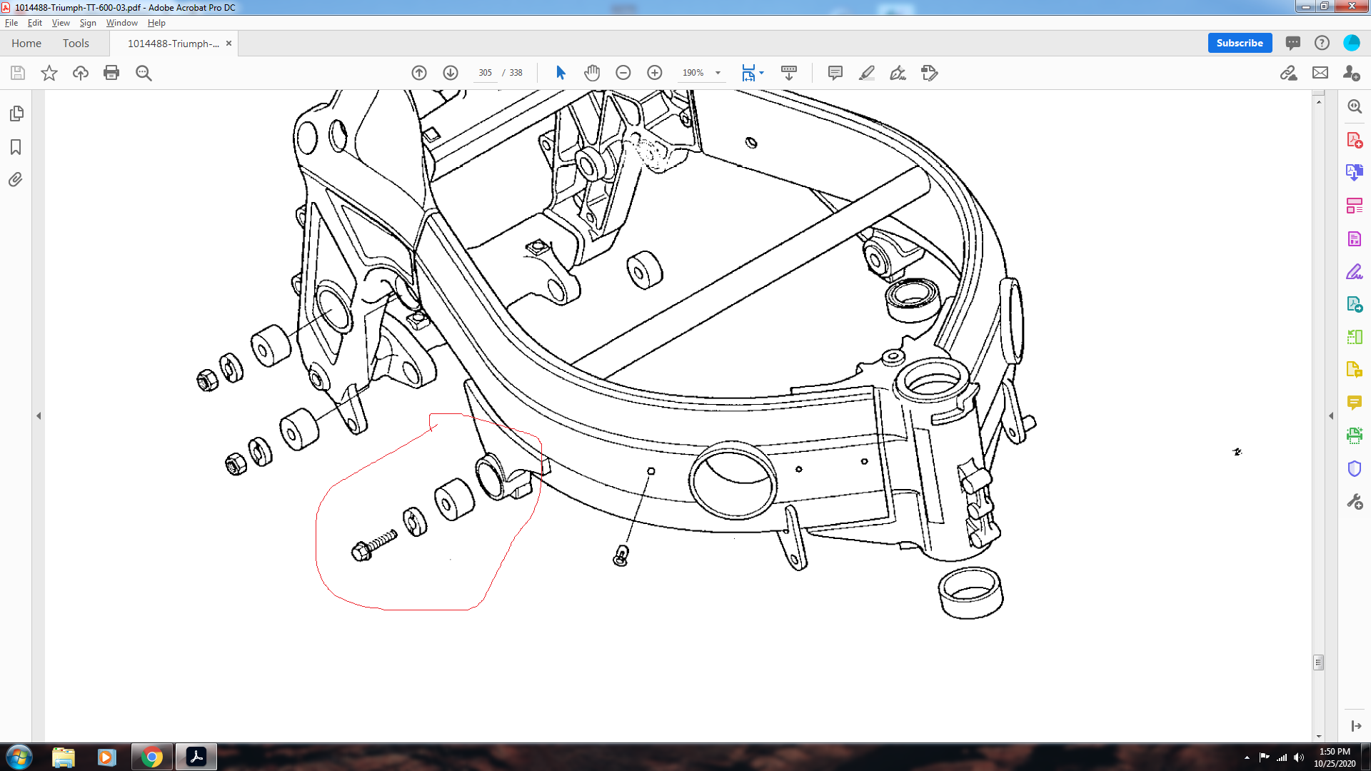

    but my question is the virgin side has a castellated nut and Allen key fitting inside that looks like it fits the frame to the motor, the other side which had the crash bung only has an Ali bushing that a long threaded bolt goes through securing the delrin bung to the frame.
    circled in red in the screen grab
    presumably it should be 2 sets , 1 each side.?
    thanks in advance Mark
  4. martingw1
    martingw1 Member
    Dec 12, 2014
    50
    Your assumption is correct, they should be the same both sides. What you refer too as the virgin side is original, Triumph refer to it as "frame to cylinder head mounting bolt" The procedure is fit the rear engine bolts from the left side first, then fit and tighten to 40nm the left hand cylinder head bolt, tighten all the castellated nuts on the right side to 4nm, then fit the right side cylinder head bolt and tighten to 40nm, fit the nuts to the rear bolts, tighten to 70nm, then tighten the castellated bushes (triumph call them engine mounting adjuster lockrings) to 45nm. Hope this helps.
