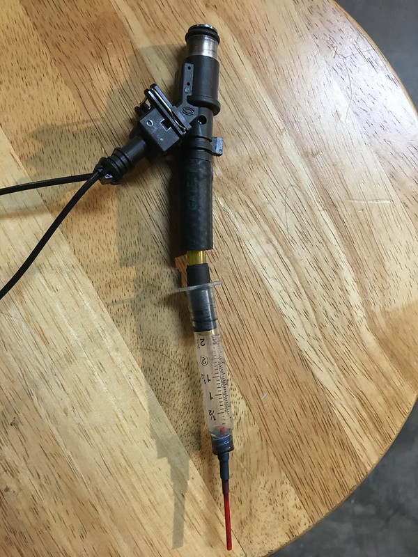

    Fuel injectors open when powered up. So jury rig a connection and access to a battery and fuel pump, hook up a fuel line to the pump , put something inert and none corrosive in a "tank" put injector into top of tank , switch fuel pump on , no leaks, then briefly trigger injector. Should get a good neat spray , anything else and it'll probably need more cleaning.
    You can back flush , put rubber tubing over exit/nozzle and pump in reverse , most injectors have filter built into them , a very basic strainer.

    a bit heath robinson setup but only one of the four injectors function when connected to a can of carb cleaner and a 12 volt battery.
    i am waiting on the used replacements i bought from ebay CA.
    when they arrive i will check them in he same manner.

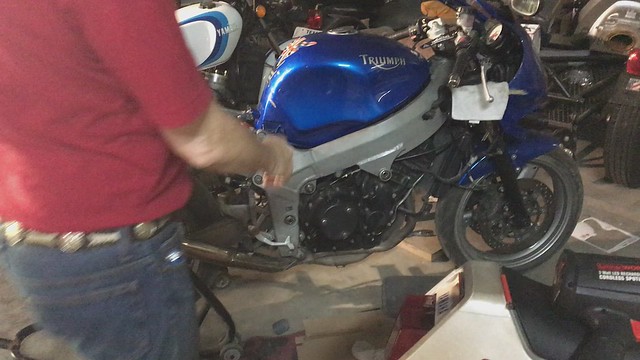

    first time running in at least ten years.
    fresh fuel rail and injectors and it started on the second try with a bit of throttle.
    still missing the purge valve and canister.
    will probably need balancing etc but chuffed
    thanks to all for the help and advice

    The tank had rotted out and all the crap had found its way through to the injectors and then sat for over 10 years ..but running again now Need a new chain and sprockets and will be able to test ride up the street
