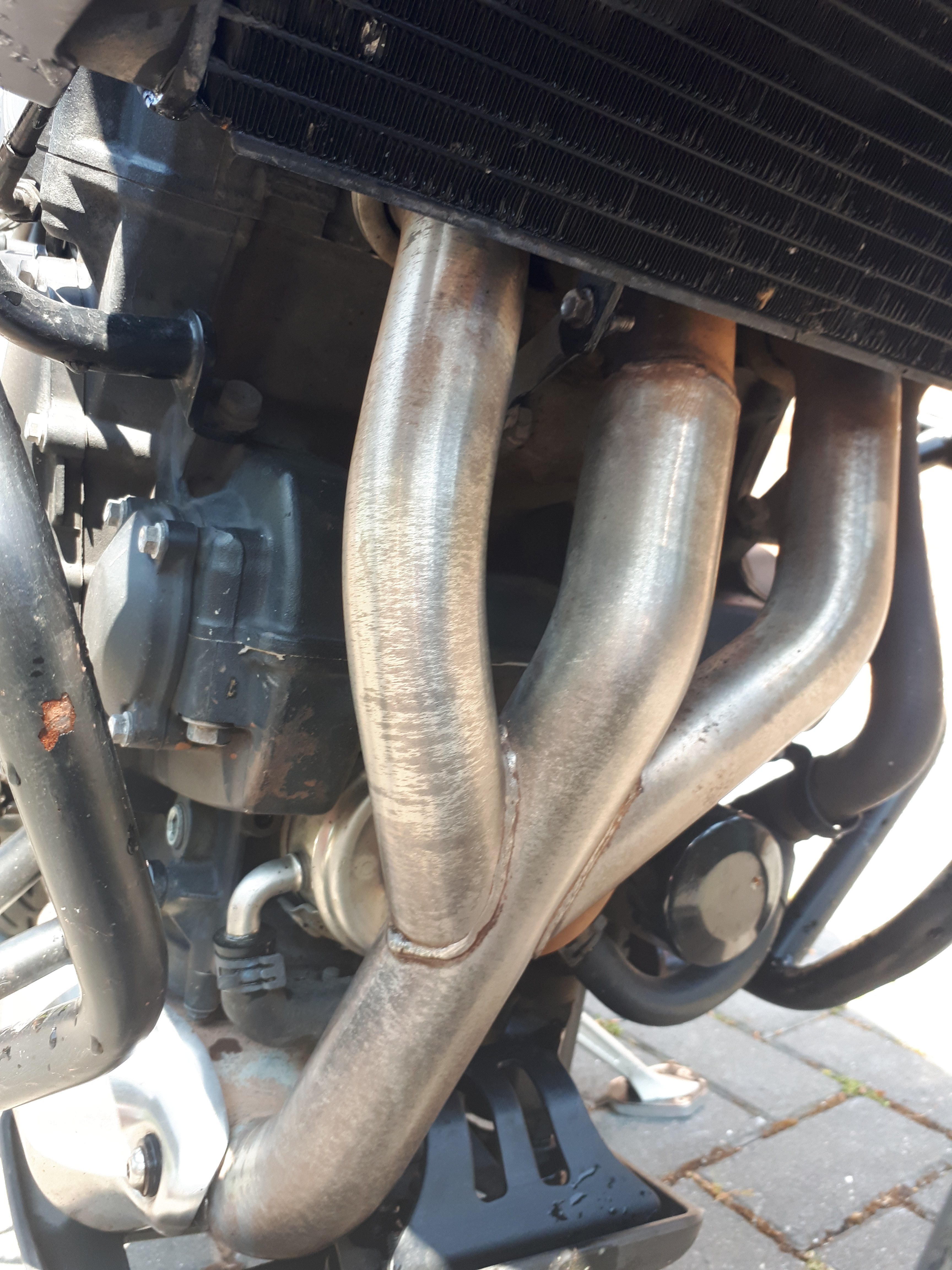

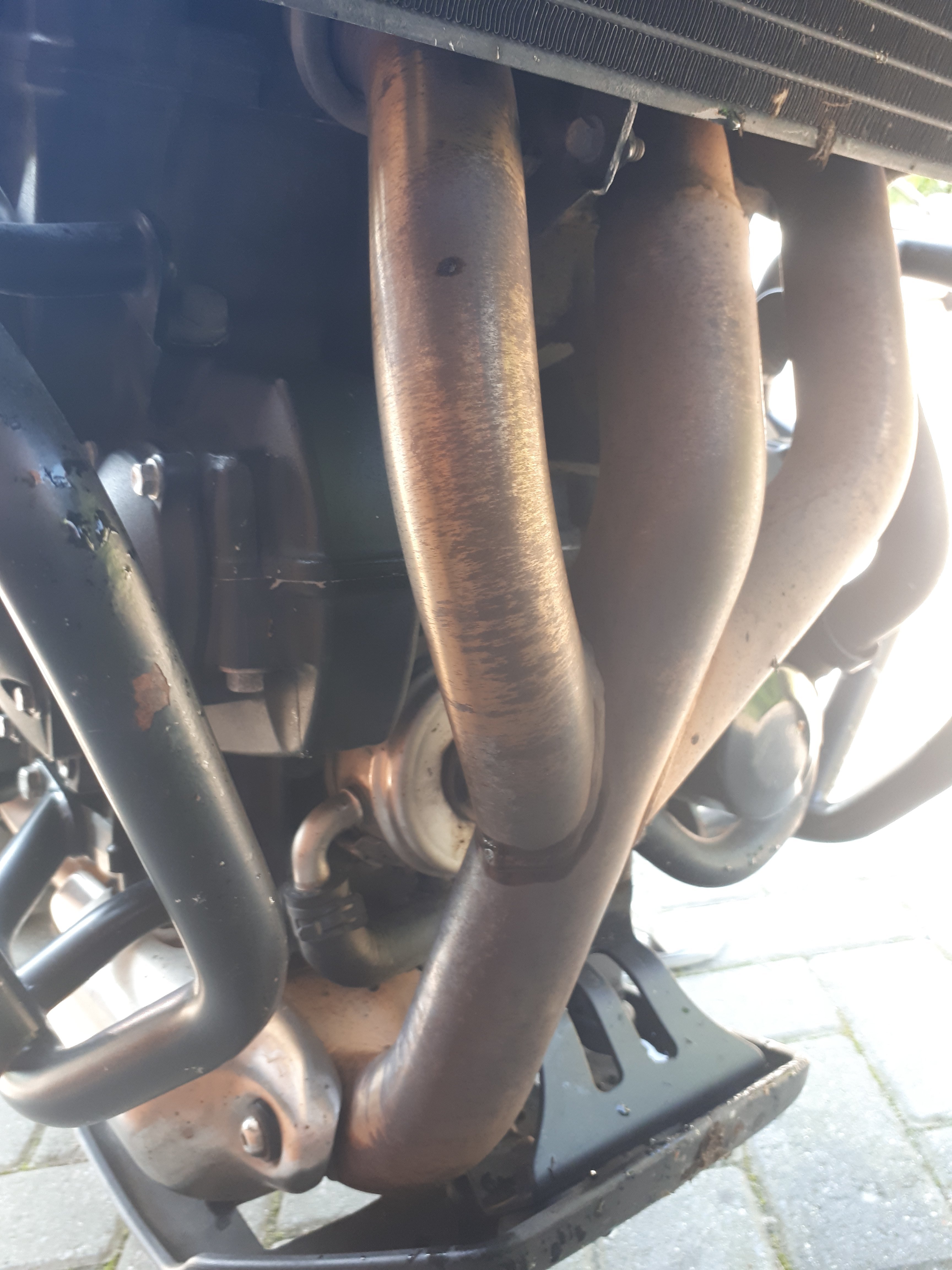

    Tried it on 19500 miles worth of Tiger pipes.

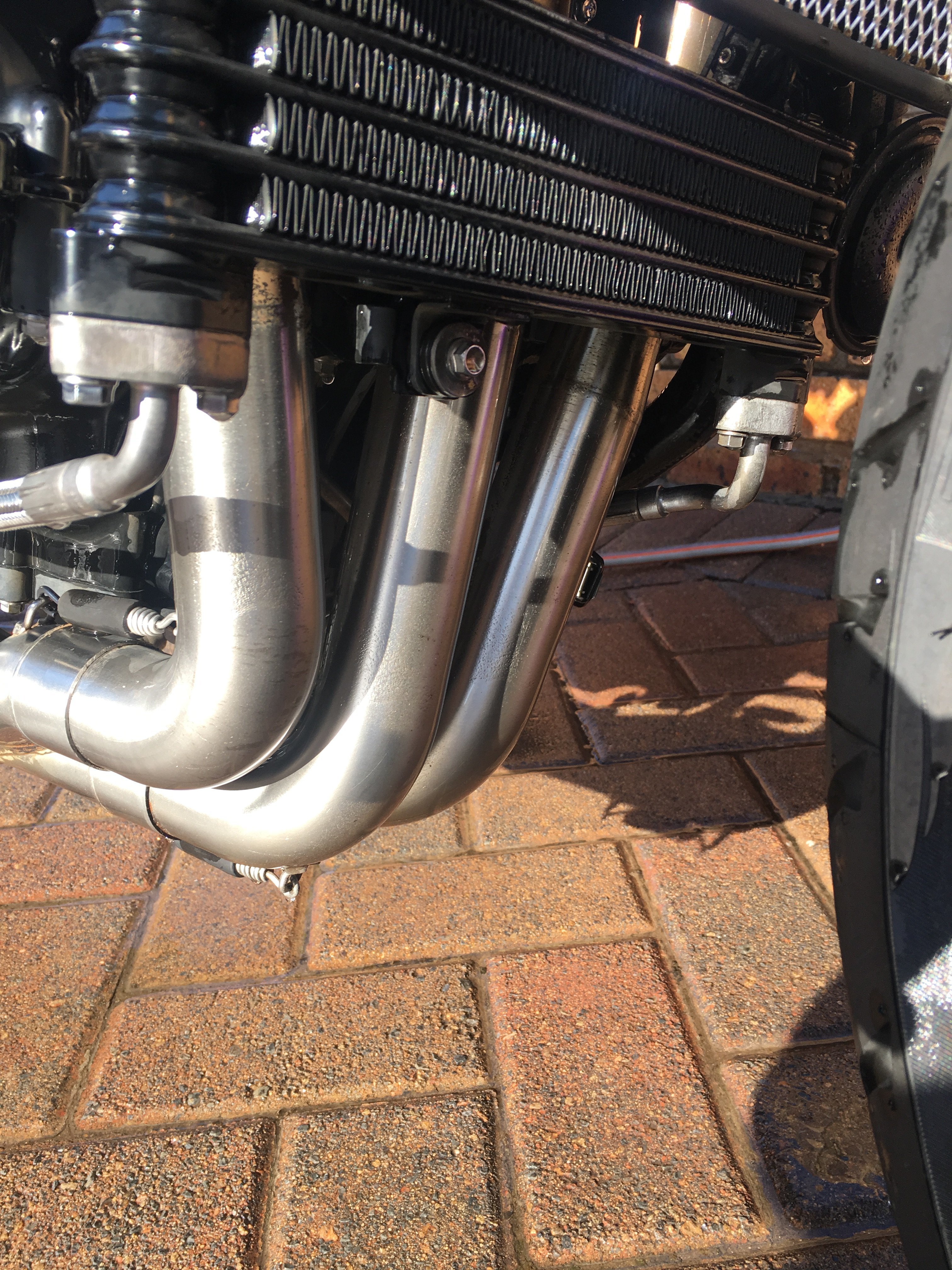

    So I tried this today, works a charm, some advice for anyone thinking of doing it, I would rather remove the system first thereby allowing proper access and reducing the risk of spilling or spatter on unwanted areas like for example your precious paint job.
