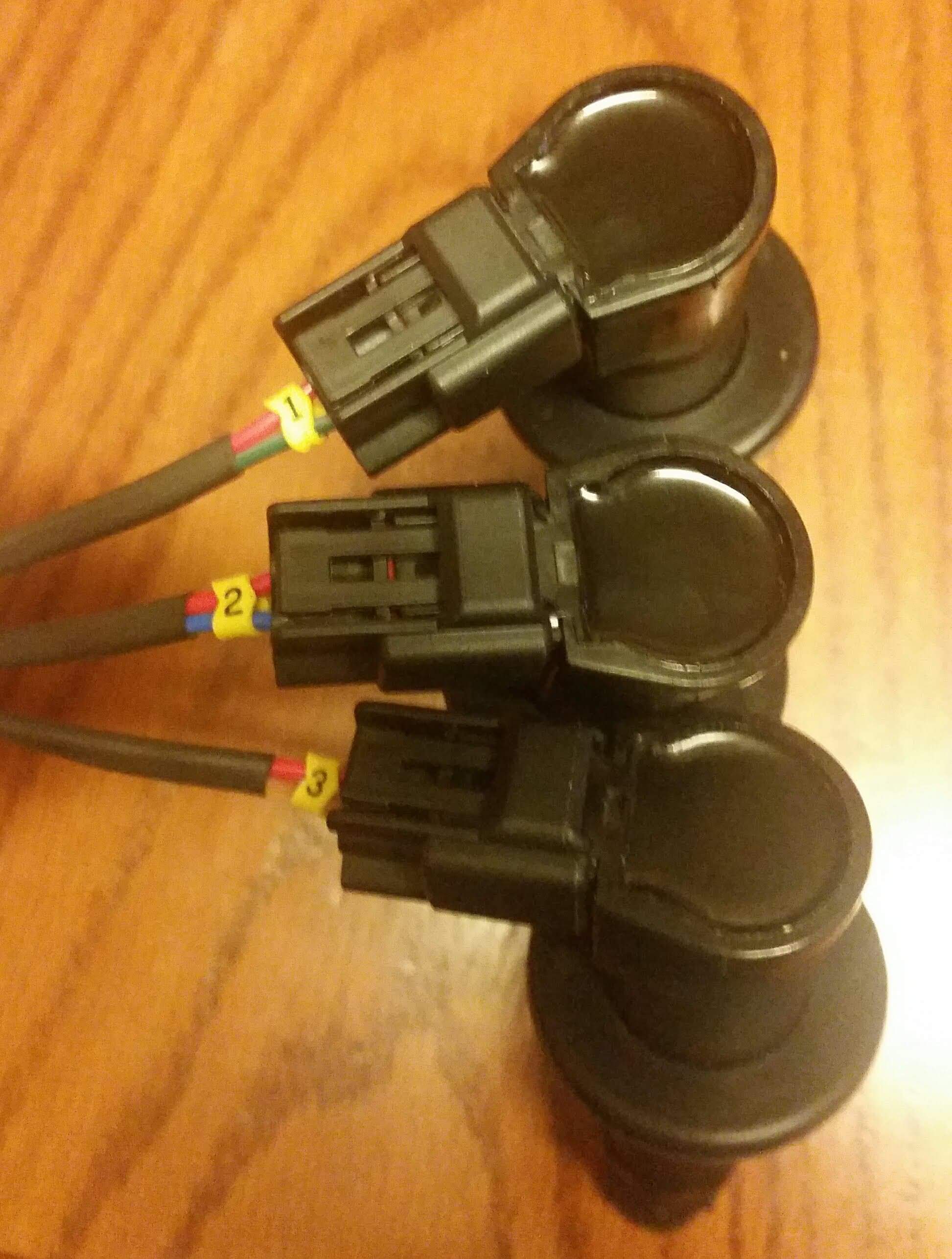

    https://m.imgur.com/gallery/QFBZHTO[​IMG]
    Problem solved! Thanks everyone for the tips. Problem was the ignition coils. Just changed all three and problem gone! I bought three PVL copy coils from Sprint Manufacturing. First i was little suspicious, but i got this e-mail from them:
    We have sold several hundred of these Taiwanese coils (single and twin outlet) and only very recently had a failure on x 1 single (USA) and x 1 twin (Sweden). I don’t think the PVL coils are any better than this, but they were original equipment on Triumph at one time. All types in stock so choice is down to you.
    Regards,
    Trev."
    I did small ride and everything looking good. Idle is nice with warm engine. So if you own hinckley 3 cylinder and these symptoms sound familiar, you know what to do.

    Only just seen this but the OP described classic Gill ignition coil failure. You get a low speed misfire (less than 2-2,500 rpm) spit on one cylinder and it can be hard to detect which - especially with balance pipes. It then gets progressively worse if you are slow to suss the culprit.
    The very fine wire in the coil breaks and loses continuity as it expands with heat. At higher revs and marginally higher voltage it jumps the gap just as it does in the spark plug.
