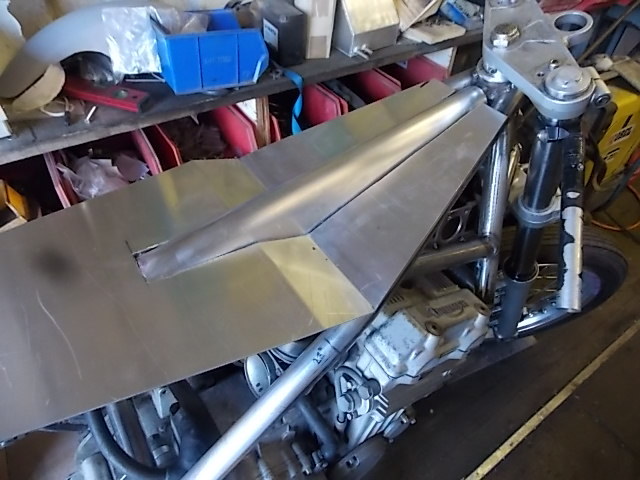

    Thanks....got a bit more done on the frame today.....fairly happy with it and so far, no major cock ups!

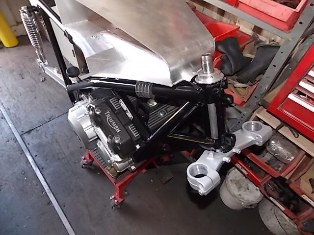

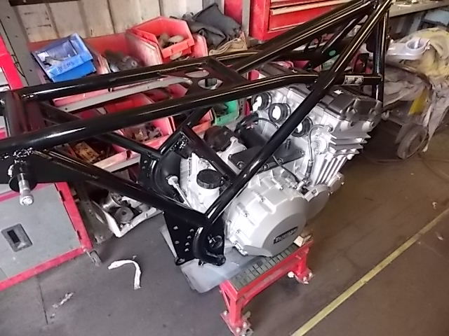

    Frame came back on Friday and got a quick paint... no twist in it but had curled in a bit at the bottom mounts from the heat.....no bad thing though really as it gives a nice tight fit, had to spring it out by a couple of mm using a bit of studding and all the bolts lined up!
    Halfway through making the tank as well....

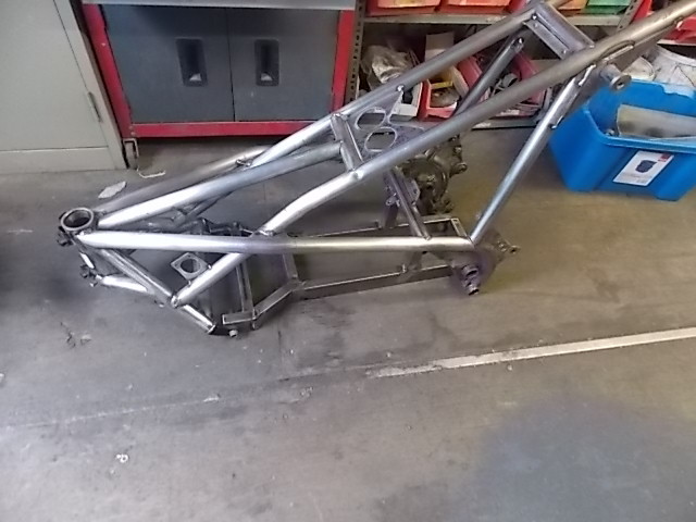

    Some more progress.....

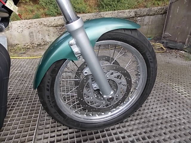

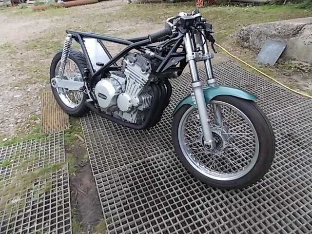

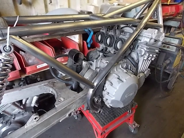

    Got a lot more done over the last few days....making the new wiring loom at present.....with a bit of luck should be able to fire it up in a week or so....see what the £15 a pair silencers from Kempton jumble sound like!!
