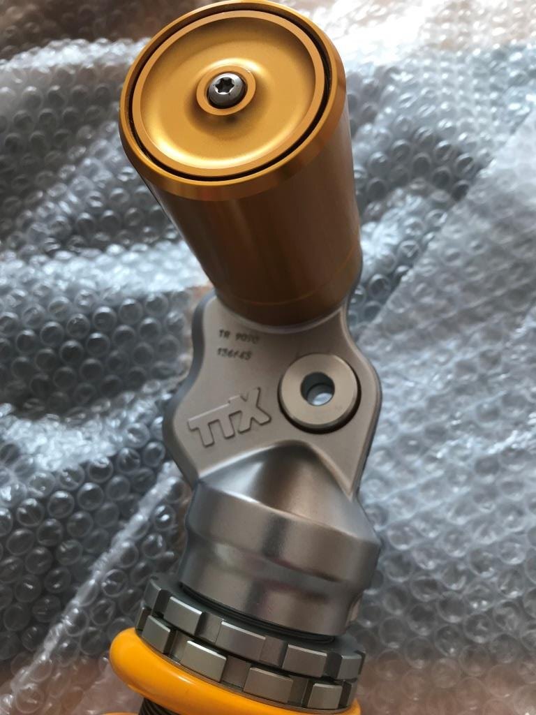

  6. m4ppy
    m4ppy Well-Known Member
    Aug 7, 2013
    52
    I found out the hard way that most suspension shops in the UK wont touch the ohlins shock on a triple. I have an s and picked up a new ohlins cheap and wanted to re-spring but the places I tried couldn't compress the spring due to the placement of the remote reservoir. All said yes until they had the shock. Called a few deallers and they advised a replacement.

  9. m4ppy
    Aug 7, 2013
    52
    Send them a pic of the top of the shock, over the phone they all said they can service, when they got to see the top they couldn't as the triumph shock has the reservoir as part of the top mount so they can't put it in a spring compressor
    I even tried maxton who build shocks and they couldn't with out making an attachment.

  14. m4ppy
    Aug 7, 2013
    52
    That I did and it's an issue with the shape of the top mount used by Triumph, it wont fit in to a standard compressor. The reservoir and mount are one piece stopping it from sitting in the cup on the jack used. I tried 3 specialist including ohlins and they can service and re-spring TTX but not the OEM model made specifically for a speed triple. They can do the street no problem.
    I sold the ohlins and got back what it cost me and the OEM shock so I'm not out of pocket and the maxton setup I went for is amazing. Rode the bike today after putting it back together (bike has only done a 100 miles) and it rides so much better. I am a heavy rider and the revalved forks and new shock done for my riding style and weight are sublime. It's really transformed it into a great bike to ride.

  16. m4ppy
    Aug 7, 2013
    52
    in case any one else is looking to get the ohlins done, attached is the top mount to send to see if the compressor they have will take the triumph shock.
