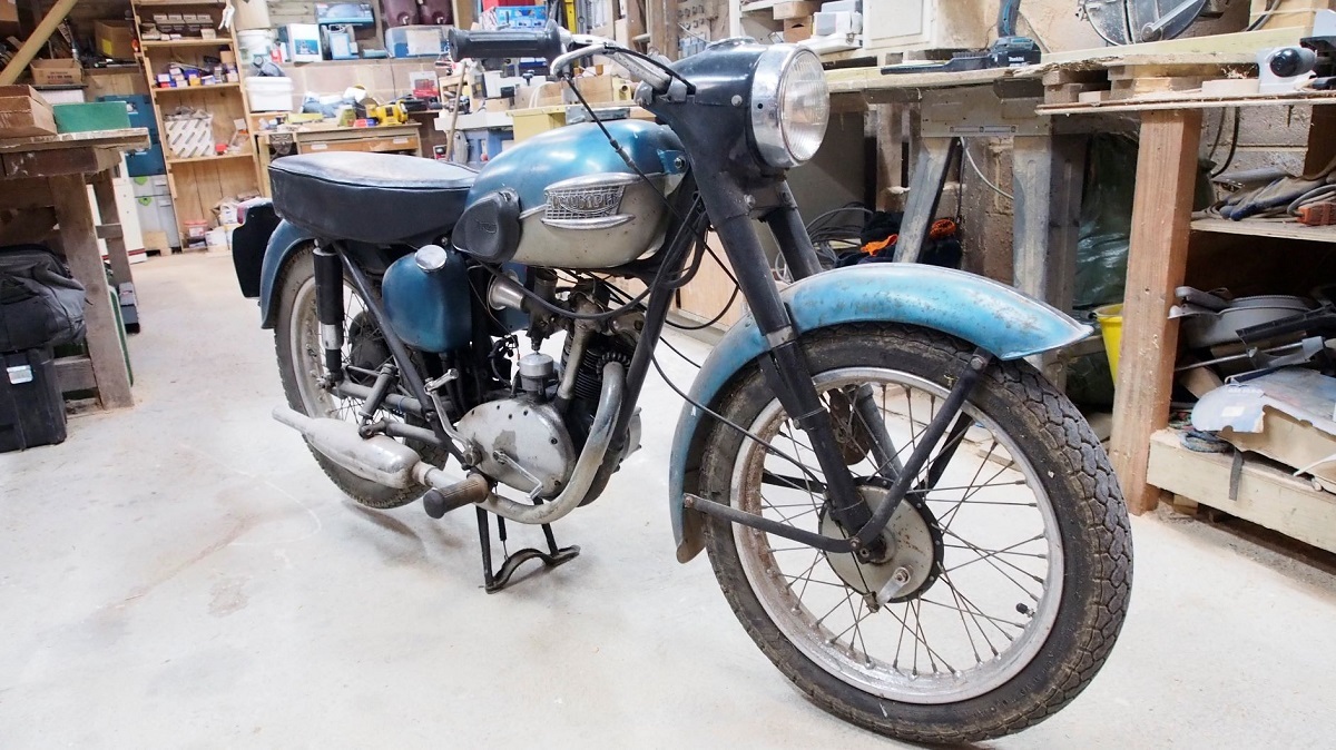

    Finally I have sorted that picture! It wasn't long ago it was in quite a few bits. But I've been busy and its been collecting dust since I made it look like a motorcycle again! I'm planning to get it running then take it apart again and do a mechanical restoration.:grinning: I actually don't want to re-spray and all that. Quite keen to make it into a usable bike that I look after but use. If I make it too shiny I will be scared to use it!

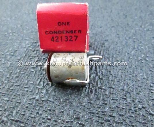

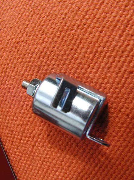

    Ok, sorry to be a complete and utter numpty. But does anyone know if I can use the later style condenser, on the ealier style distributor? It seems that the early style is simply not available. If it is doing the same thing with the electrical. then I could just cut the extra connection point off in order to make it fit and then work?
  5. Helmut Visor
    6,330
    https://www.draganfly.co.uk
  6. darkman
    7,639
    If you can make it fit it will work :)

    turns out
    Ok ive been worrying about nothing then haha! So used to little details on modern equipment scuppering progress. I just assumed that it wouldn't work. Ill order one of the later ones and update you chaps on my progress! She'll be running soon im sure! :grinning: Thanks for the help everyone!

    Hi Ed
    Re the condenser, a 6 or 12 volt will do. Irrespective of the applied primary voltage (6v 12v 24v), condensers are made to withstand the flyback or reverse EMF voltage made by the coil as the magnetic field collapses when the points open, the condensors have an insulating breakdown of up to 200 volts when new, hence you can put a suitable sized one for car or motorcycle in and it will work fine, car ones are a lot cheaper as well, anything electrical for classic bikes seem to cost more than those for 4 wheel classics for some reason. It's a lovely little bike by the way, I've been looking for one for some time now, most are over priced, seen some for 6k or more, bloody crazy, not sure if they ever sell though.
