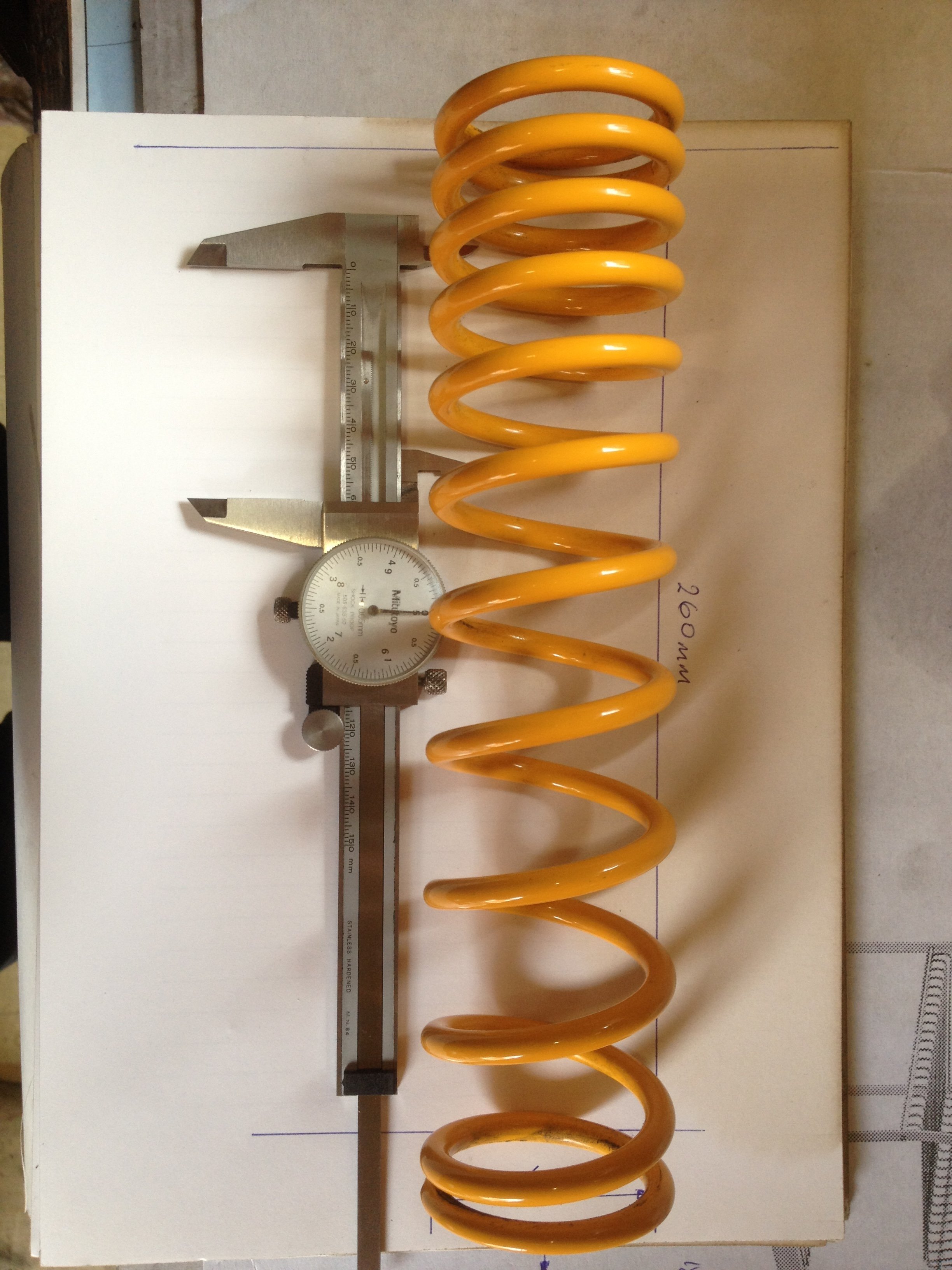

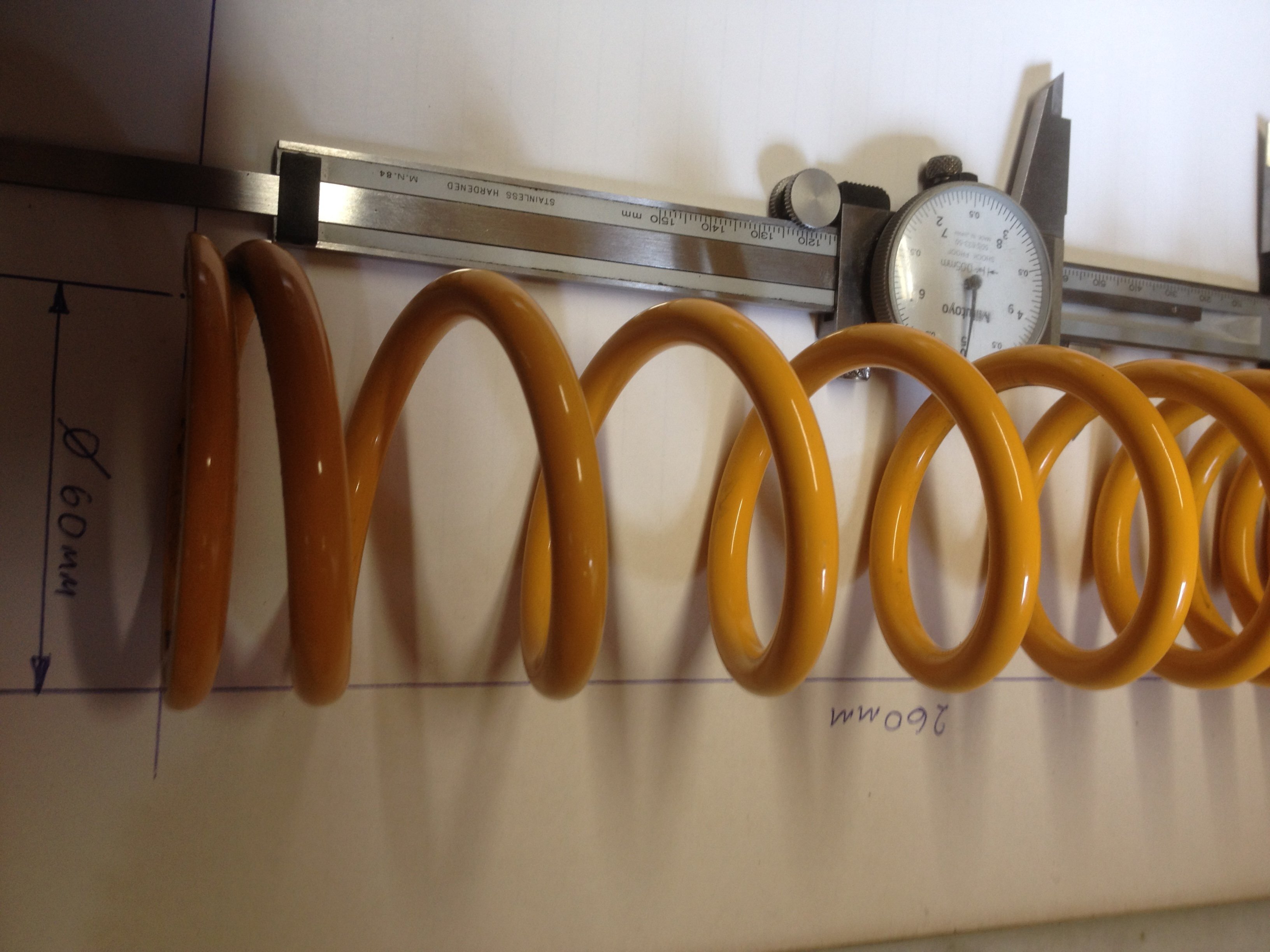

    Sounds like you are in the same situation I was. Sorry I don't know what rate my replacement rear springs are but Ikon should be able to calculate that for your weight. It is simplified as I do not carry a pillion on the TTR nor would I load it heavily with luggage - but then I still have plenty of pre-load adjustment left anyway. I recommend you discuss with ikon what they can do to reduce the compression damping on the front forks as well as reducing the spring rate.
    So rear springs are 260mm free length and have a 60mm coil dia. The material dia. measures at 7.2mm but the 0.2mm is probably the powder coating. Rears are, as I am sure you recognise, progressive whilst the fronts are linear.
