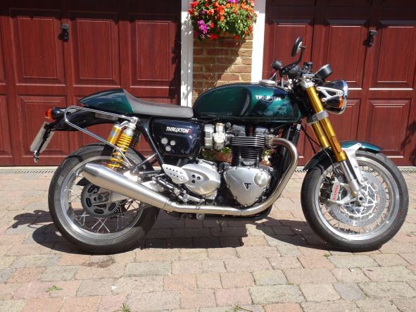

    I have a Thruxton which I bought a couple of years ago and I love it, I had a Triumph alarm fitted as well as panniers, My bike is green which I think is lovely as do others, I do not have much probably with wrist ache but then I have got long arms. I am hoping to travel from Croydon in Surrey to Newquay in Devon later this year. Good luck.
