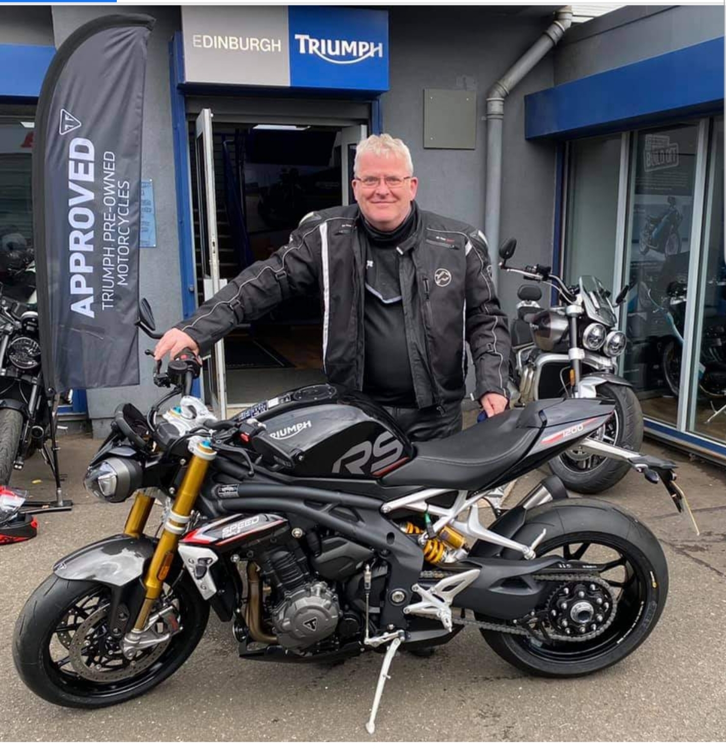

  8. 5teveb
    5teveb Well-Known Member
    Mar 6, 2021
    53
    Fife
  9. Neal H
    Neal H Active Member
    Mar 7, 2021
    174
    England
    Pics for those of us not on Facebook?
  10. 5teveb
    Mar 6, 2021
    53
    Fife
    looking a bit smug..
  11. 5teveb
    Mar 6, 2021
    53
    Fife
  12. Neal H
    Mar 7, 2021
    174
    England
    Fantastic! Mines also black, I can’t wait.
