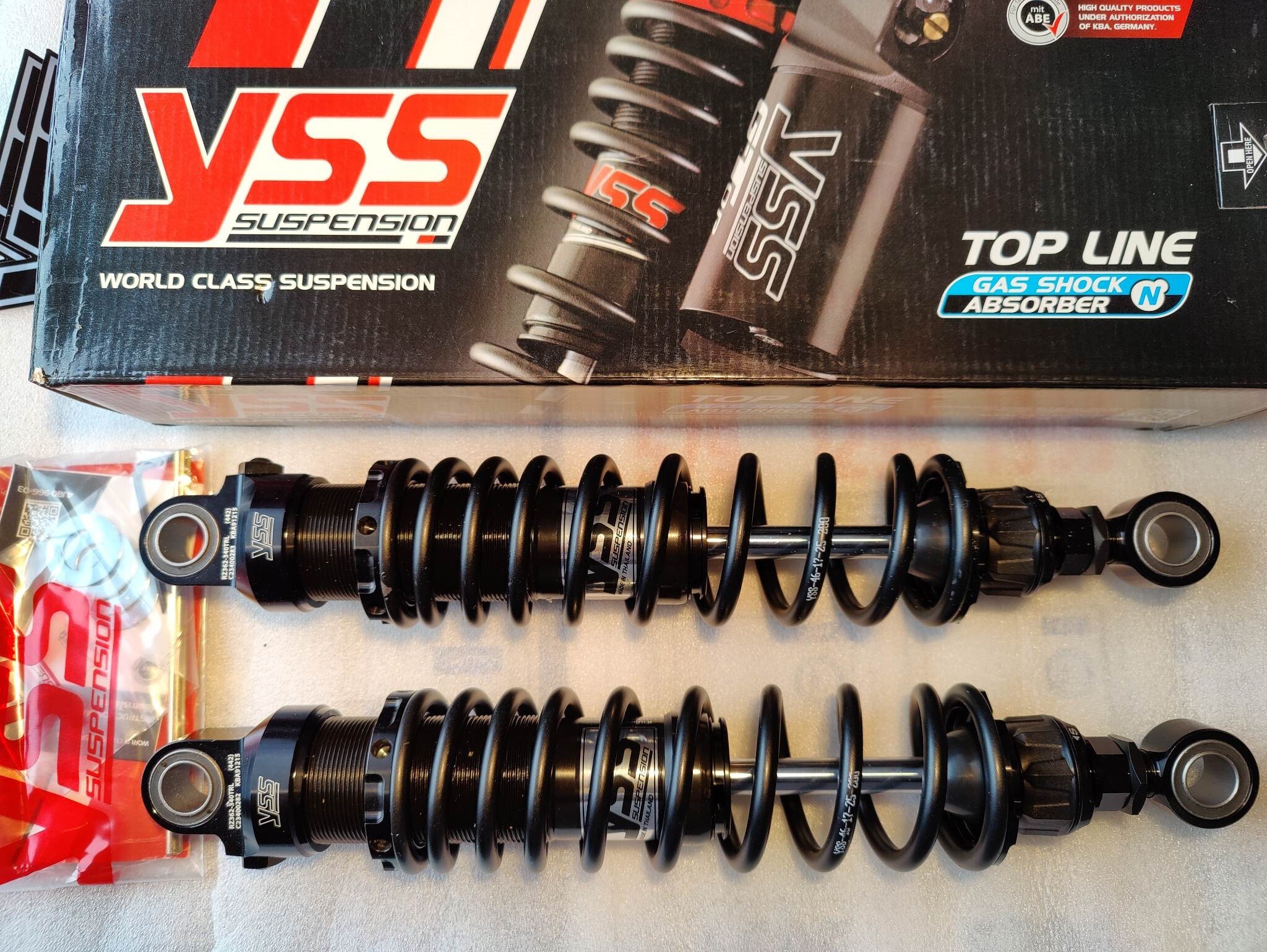

    I am not sure what you mean with it's a waste of time unless do suspension and brakes :)
    It's not exactly a high performance sport bike, and it never will be. I think it rides and brakes OK.
    I have had a few bikes with 120-170 hp, but I really don't need that anymore. I am pleased with my ST, just a few more ponies and it's perfect.
    Anyway I bought YSS rear shocks, they have good reviews. Not tried them yet, and I probably will not do so until May next year (since I am living well north of the arctic circle and the season is over).
    My mum is also rather old, turns 95 next spring. But at the time being we live in the same house, so no trips necessary ;)

    I think the brakes on a ST are not as bad as some would suggest. My problem is I'm a fat bastard - over 17st - and my beautiful wife is over 12st. At speed and on some road surfaces, the suspension would pogo and the bike could sometimes became a handful. 8.5n/mm linear springs and a set of bespoke Hagon 2820 shocks cured these tendencies. Basically, my ST is running Street Cup geometry and works very well.
    I have had YSS stuff and I rate it. As you say, the ST is no R1 and, inmho, the YSS brand delivers a real performance upgrade at a reasonable cost.
