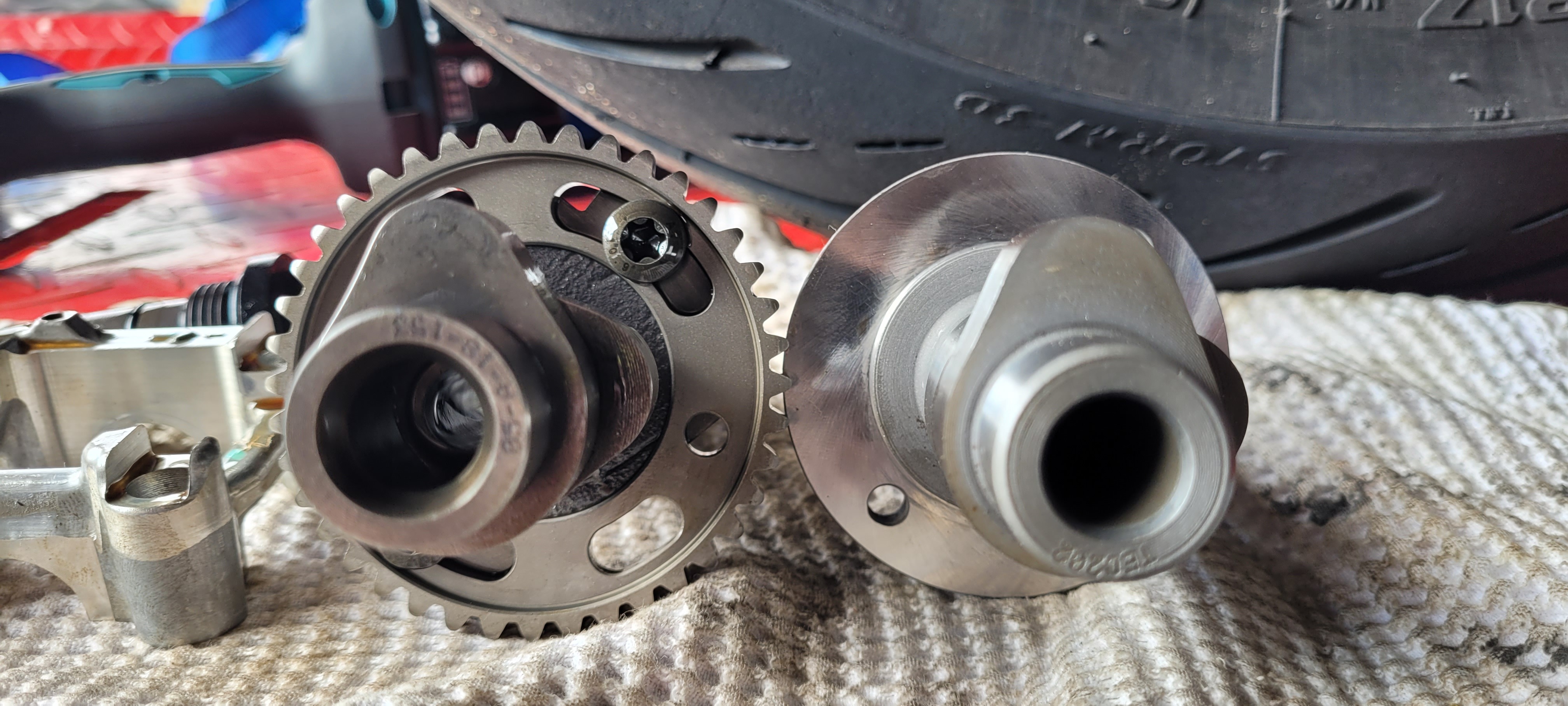

    I've now put nearly 1000 miles on the new cam and must say I don't have anything negative to say. If you're thinking of getting one yourself then just do it and it makes the riding experience so much more pleasurable.
    Note to reader: I've no connection or affiliations to Tec in anyway.
    Mpg appears to be still rising according to the dash. Previously it was running between 55-57. Now I'm over 60 mpg and each time out it seems to creep a few more tenths and I must say I'm not riding it in an economical way, just riding to enjoy.
    If you were to ride it sedately, and economically, then up towards 65 looks quite possible.

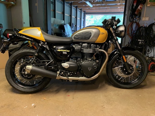

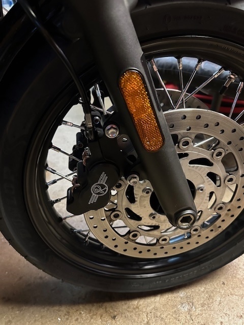

    A bit late for this but T120 rims are a direct fit to Street Twin/Cup. Then you can take the advantage of having double front discs also, just get T120 right fork slider and the brake stuff. The second picture is T120 wheels W/O the right disc on place.

    When you say 'just get T120 right fork slider and the brake stuff', how easy was that? I admit I haven't looked (yet) but I would imagine that finding a T120 front wheel with disc, a fork leg and calliper in good condition wouldn't be simple..or inexpensive. But maybe they're out there.
  8. Eldon
    Eldon Elite Member
    6,741
    The costs will soon stack up.
    Someone recently mentioned using a Honda CB1000R front left caliper to upgrade a StreetTwin.
    I did a quick search and somebody wanted £450 for a good condition pair of second hand fronts which I thought was a bit steep.

    Hi, I bought the TEC 101 camshaft in 2022 before the TEC 202-model was released. The 202 is a Stage 2 camshaft, but they are both for the same chassis numbers AFAIK.
    I recently got this answer from TEC when asking them:
    "The stage 2 cam has slightly longer duration for better performance, we're dropping the stage 1 cam as the stage 2 gives better power."
    However I guess with the Stage 2 cam you lose some bottom torque, and I don't want that.
    I didn't finish my installation of the camshaft last year, but will do it soon.
    One thing you didn't mention is that this camshaft needs a tune or remapping to get the most out of it. It's not very easy to do plug&play, so that is probably why TEC says it's not necessary. But it will make a difference.
    I have the TuneECU app and have been doing some investigations. I just hope there is someone out there that have done the proper mapping already, and is willing to share their file. It's not that hard to do an upload/flash of the ECU. I already did it, derestricting my bike from A2 license. Or else the tuning map has to be custom created for the bike and camshaft. There are some interesting youtube videos on this subject.
    Finally there is DNK Tuneworks. They can provide a custom map file, or mail-in ECU service.
    The company Raisch in Germany sell their performance camshaft with the Power Commander and their own tuning map. But the price is way up there.
    They say this on their website:
    "In addition to the assembly of the camshaft we recommend further tuning measures such as a larger air passage, cat replacement pipe, sport exhaust and of course a new engine tuning. Some suppliers sell camshafts with the information that the motorcycle would adjust itself. These statements are absolute nonsense, since the electronics only have a very simple control circuit (jump probes) in the exhaust system and also have no mass air flow meter in the intake system. Therefore a mapping adjustment is necessary (Power Commander, ECU Flash). If you want to have it Plug & Play, you can use our ready made power kits."
