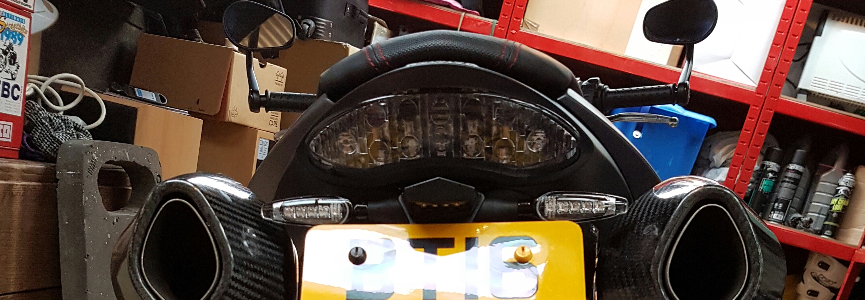

    Hi mate, I know this is a mega old post, but I have just got an EvoTevh tail tidy for mine. I have some Oxford LED Nightrider indicators, but they look like they may be too logn... what ones did you use to fit so well please???
    Cheers :)
  2. ScreaminWargasm
    Feb 25, 2017
    31
    Hello mate,
    Those are the original LED indicators that come with the Speed R in the UK.
    Doesn't your bike have original LED's fitted?
    Mick

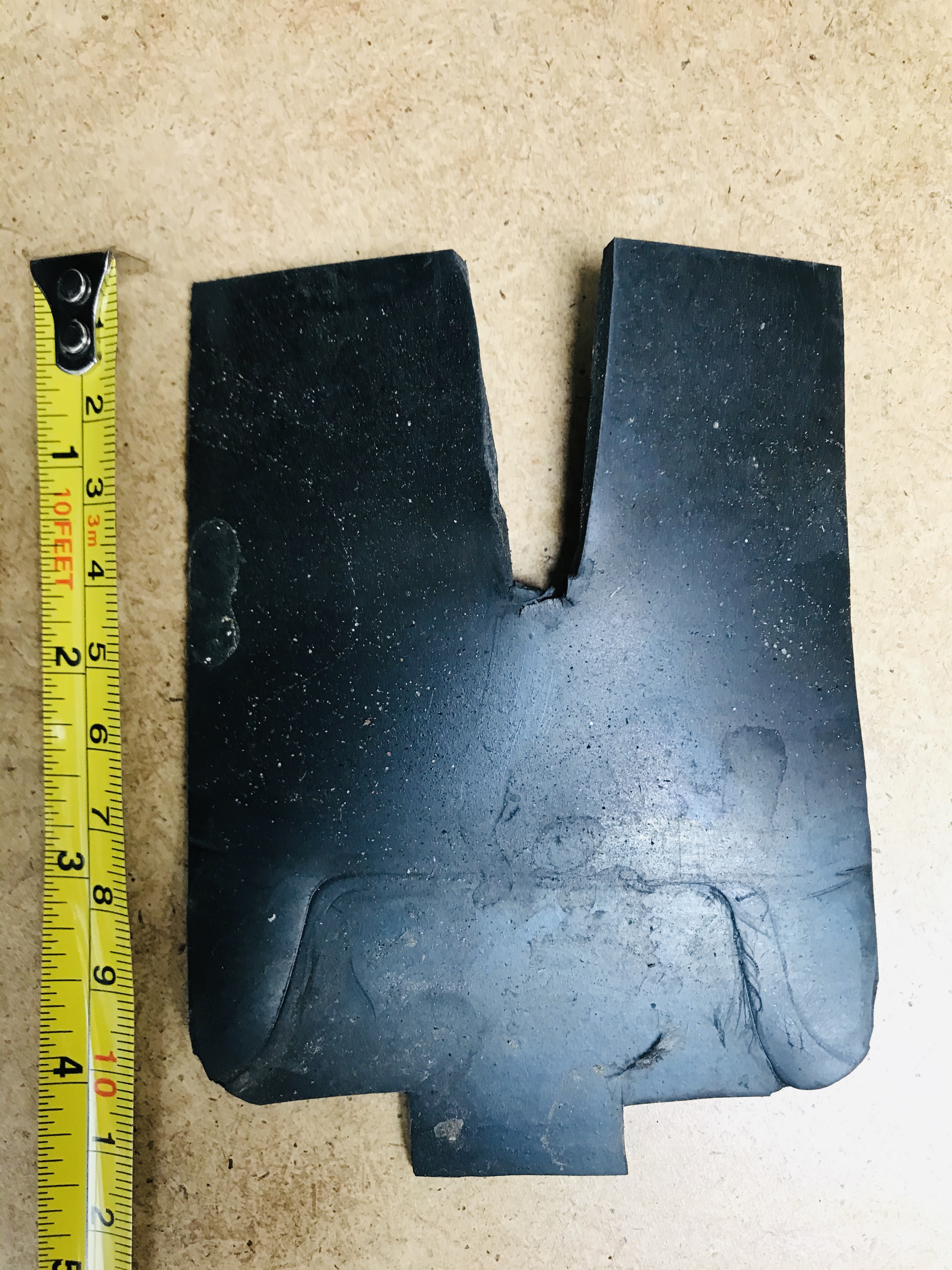

    Hi there,
    To get rid of the hole on the evotech tail tidy.
    Get a 1-2mm rubber sheet off of ebay, (10cm square), cut it lengthways so it'll slide in between the 4 screws.
    Then, cut a V shape In it that'll fit the cables (from the indicators and plate light) and then unscrew the 4 screws (on the top) a bit, slide in the rubber mat between the tail tidy and the bike (v bit first) and then tighten up the screws.
    No more leaks. Had mine on for over a year now and never had any water in the back at all.
    Was caked up with water and small stones beforehand.
    Takes 10 mins.

  16. Ducatitotriumph
    Apr 25, 2019
    2,181
    Rothwell
    Well, pics are here!
    Helps explain better I suppose

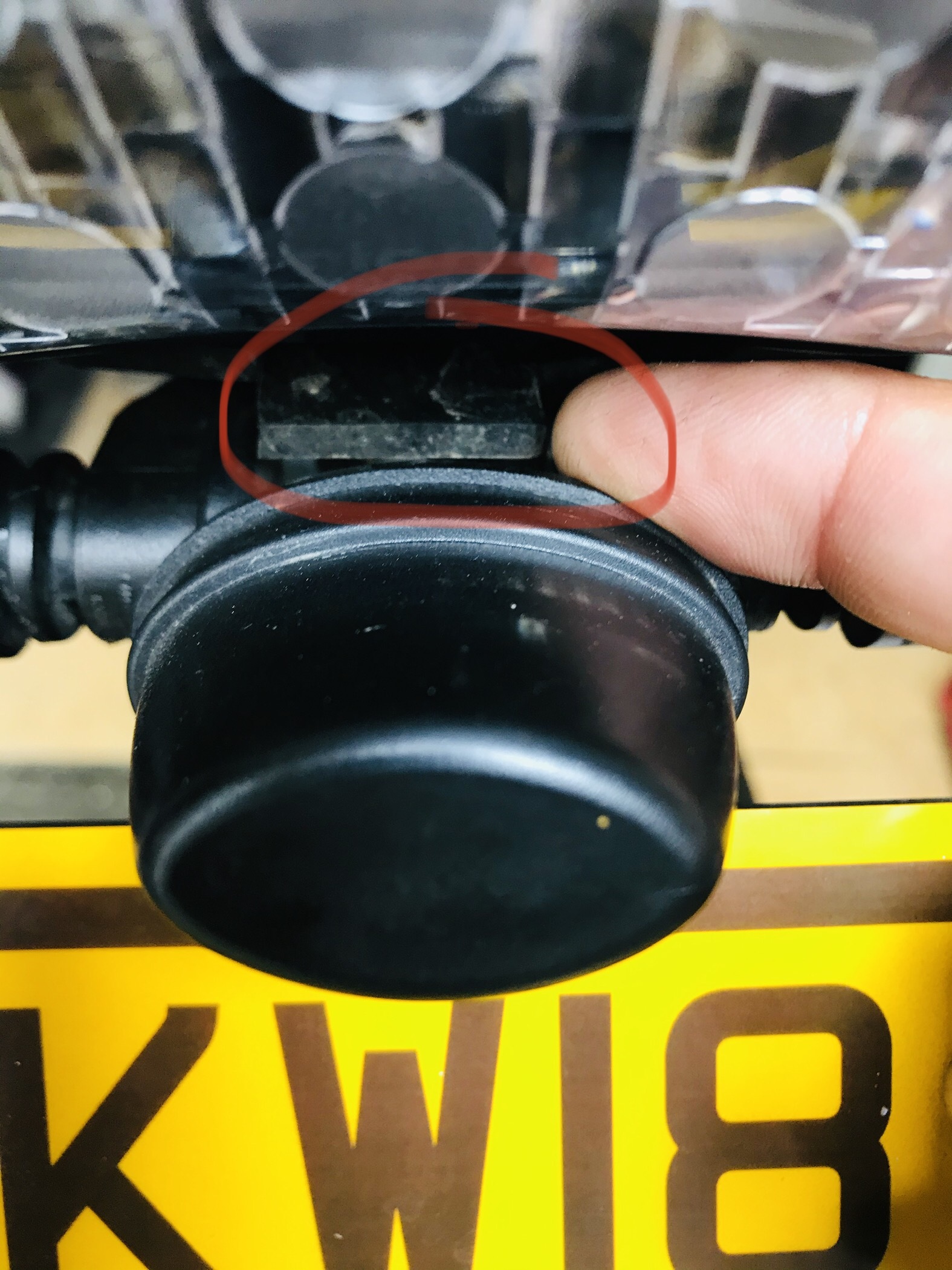

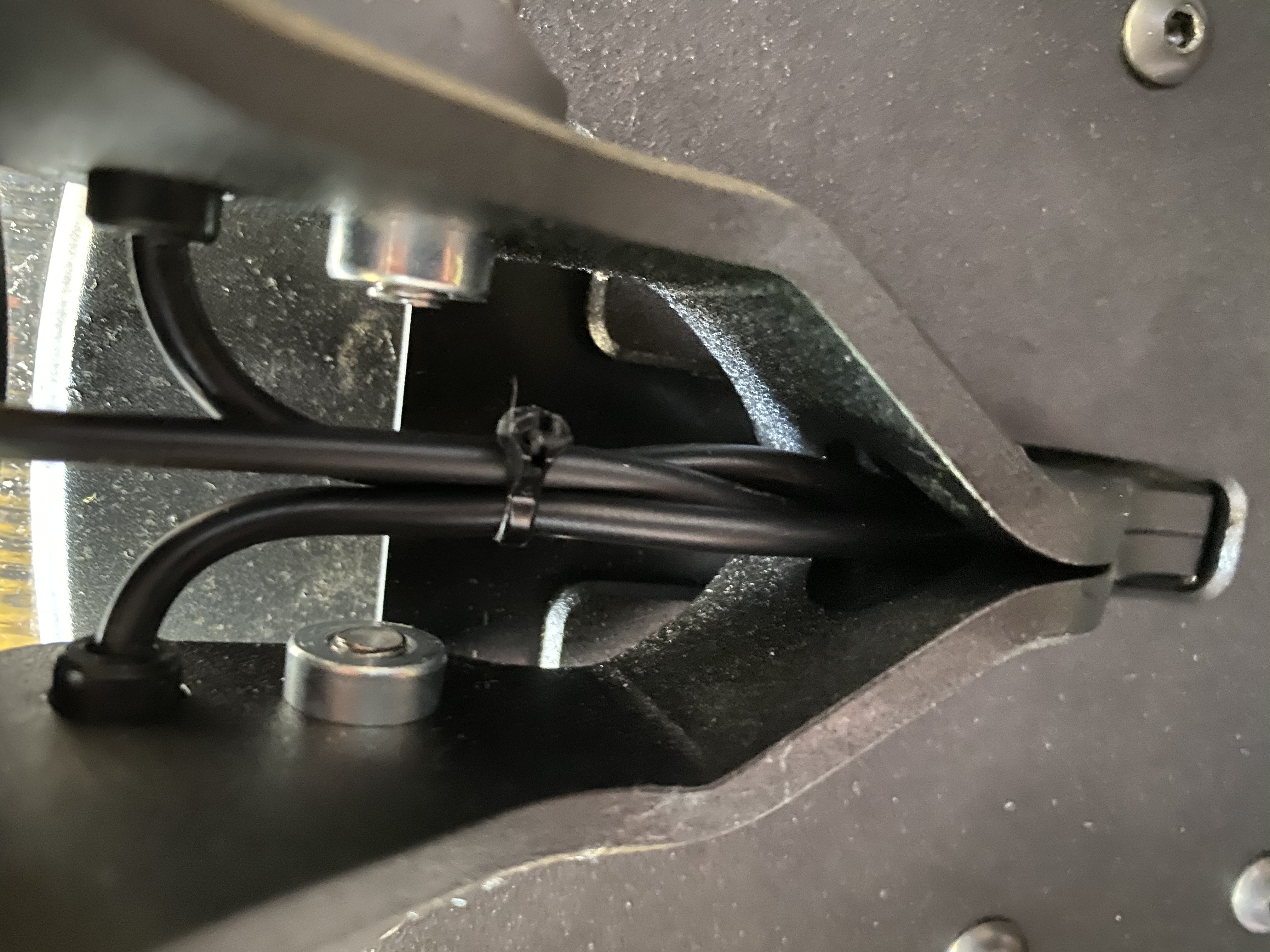

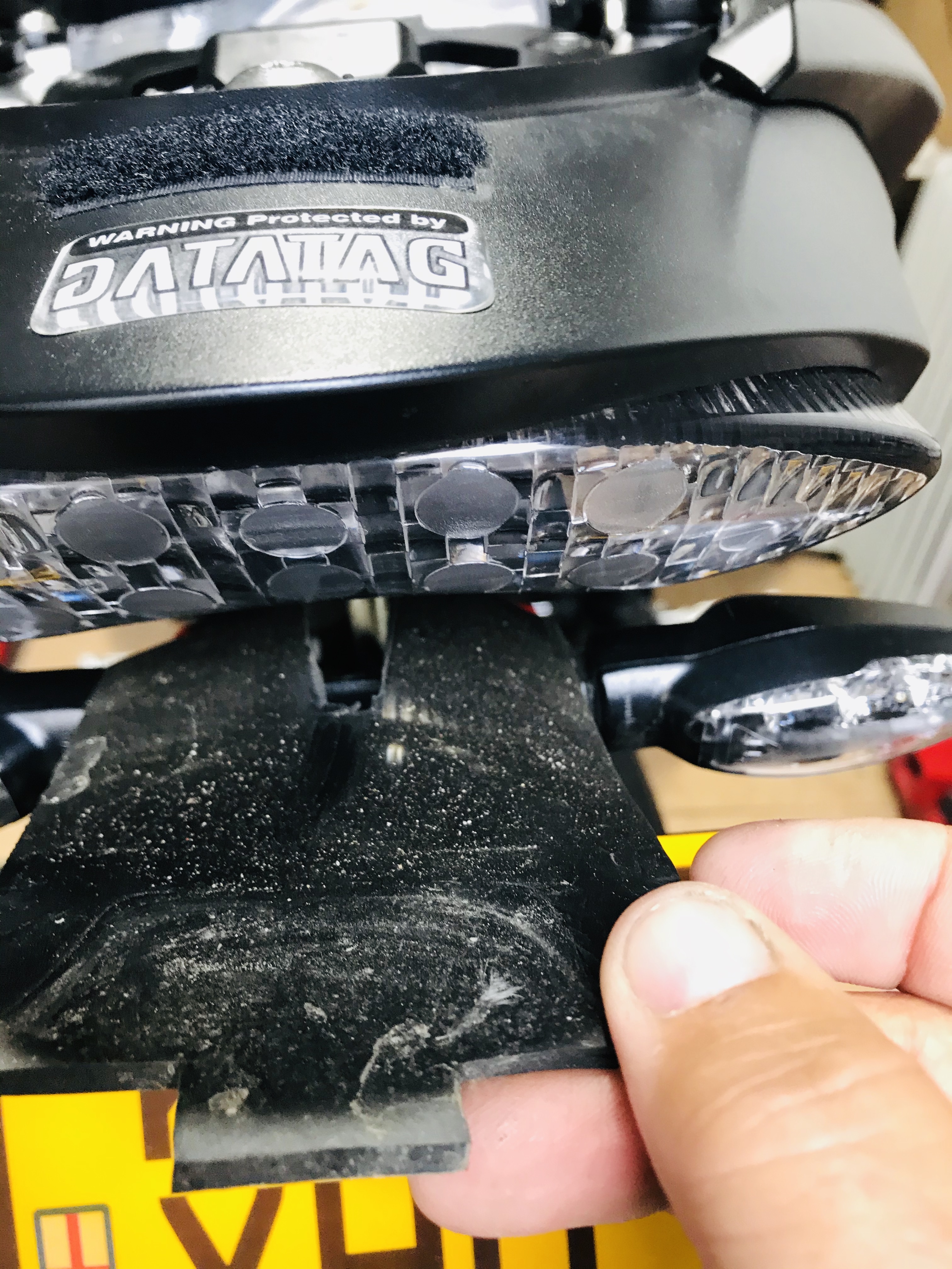

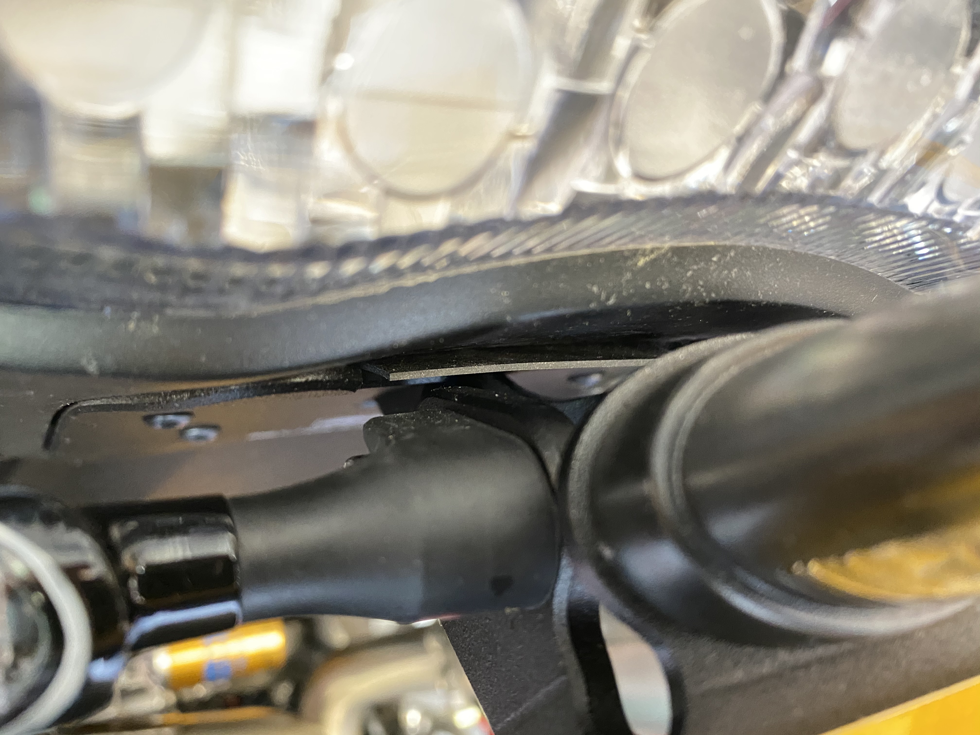

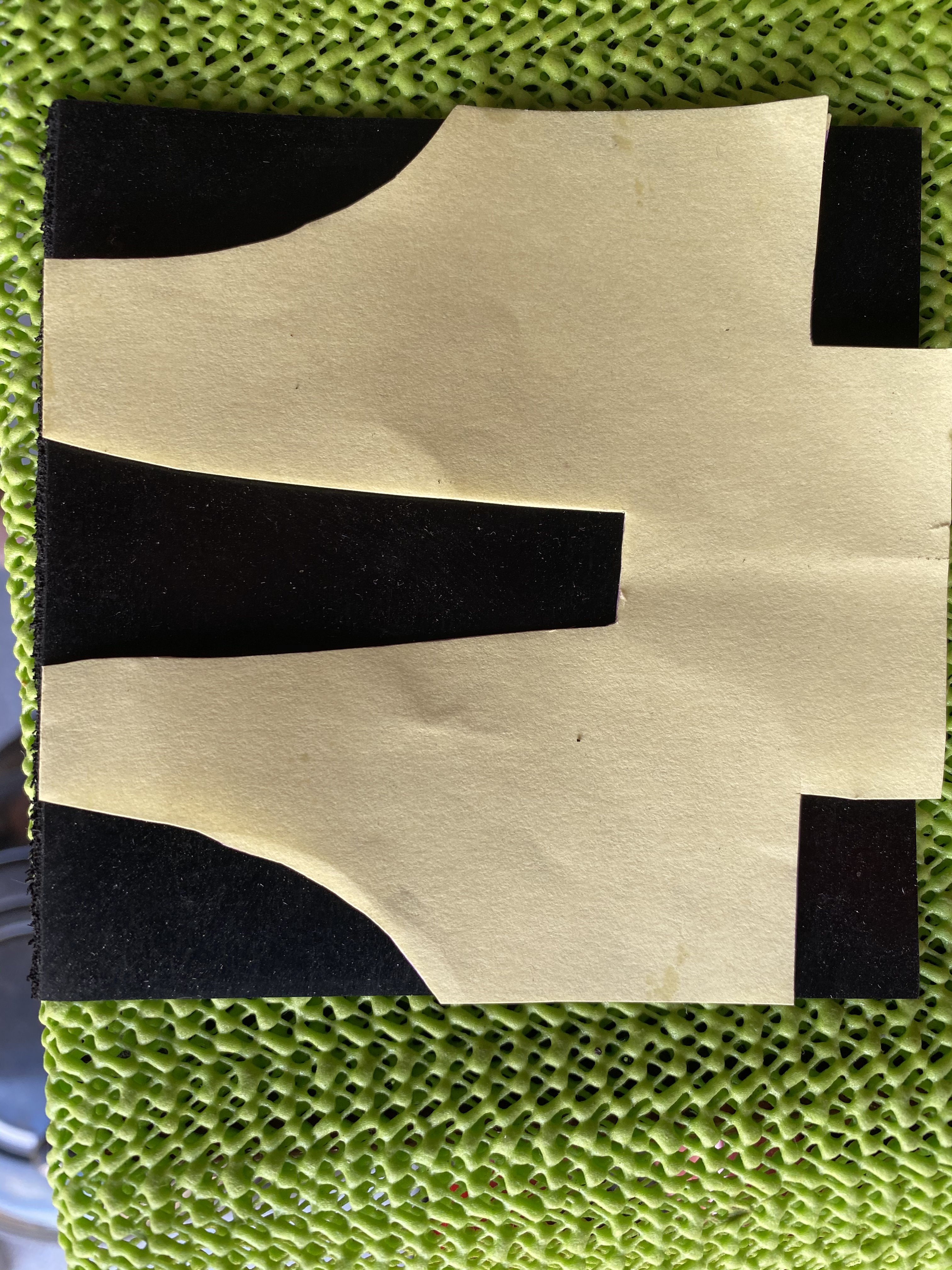

    Hi
    Just thought I should report back and say mission accomplished. I ended up doing it slightly differently I think. I ended up just removing the evotech cover, cutting the rubber shield to size and then putting the cover plate back in place which seems to sandwich it quite well, I don’t think it will move.
    I used a piece of paper first before I cut the rubber sheeting which worked out well. Looking at it now, I am fairly confident that it will keep the water out so thanks for you reply. Really easy and cost £2 if anyone else is paranoid like me.
    I have uploaded some pictures showing the back, underneath and the stencil I made.
    Hope this helps
