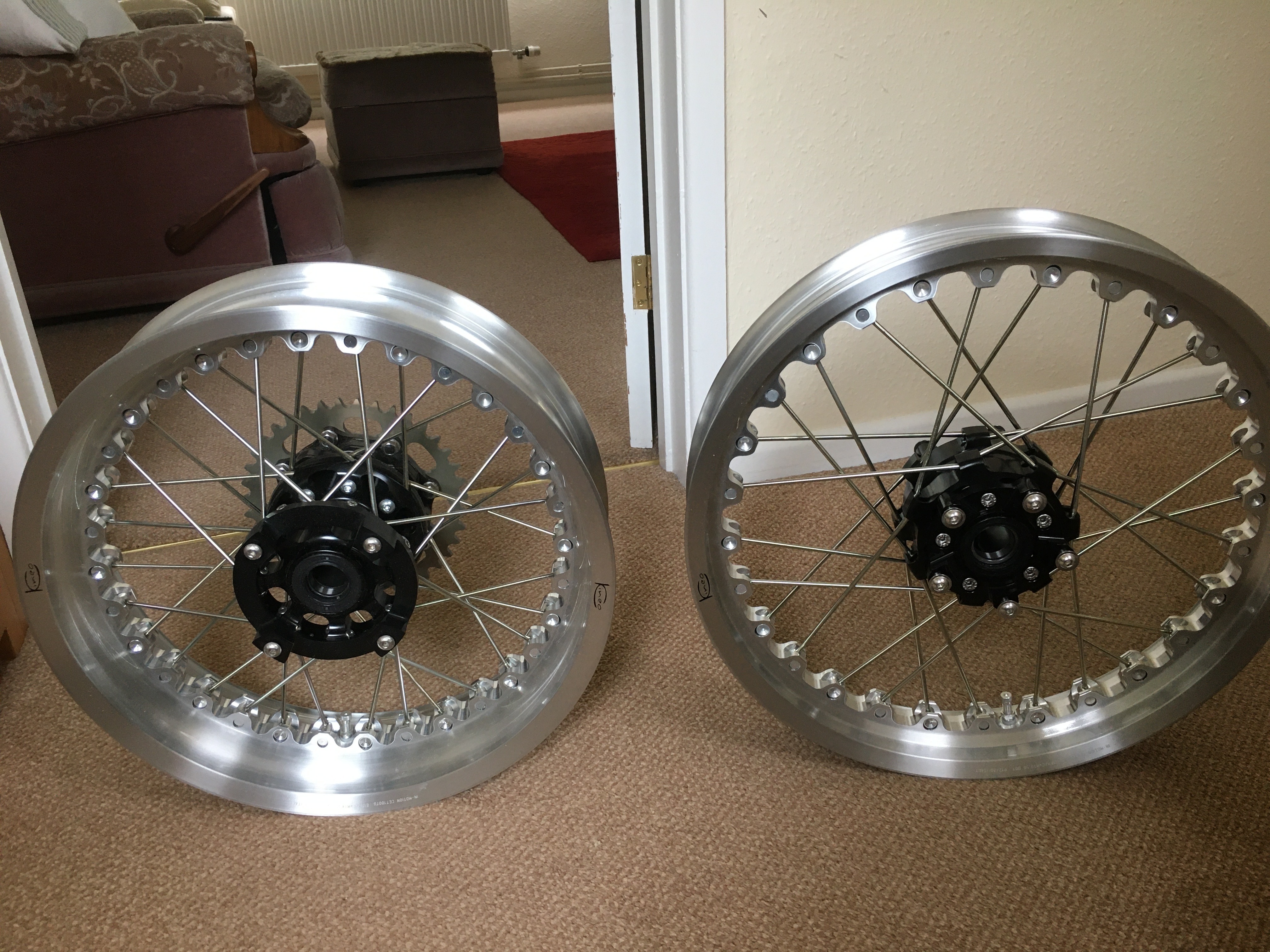

  9. Steve Hill
    Steve Hill Senior Member
    Dec 26, 2019
    557
    Somerset
    Ordered on Jan 22nd and arrived earlier today, bit of a delay because of Italy's lockdown. They are light as a feather and the finish is superb. I'll weigh the stock wheels as I take them off and then compare with these, but the difference feels massive.

  11. Steve Hill
    Dec 26, 2019
    557
    Somerset
    Very pleased with the quality, they look so much better in the flesh. :cool:

  14. GmanJeff
    GmanJeff Member
    Mar 30, 2020
    44
    Virginia, USA
    Those look really good. Please do follow up with the weight difference compared to stock and your riding impressions once they have been fitted.

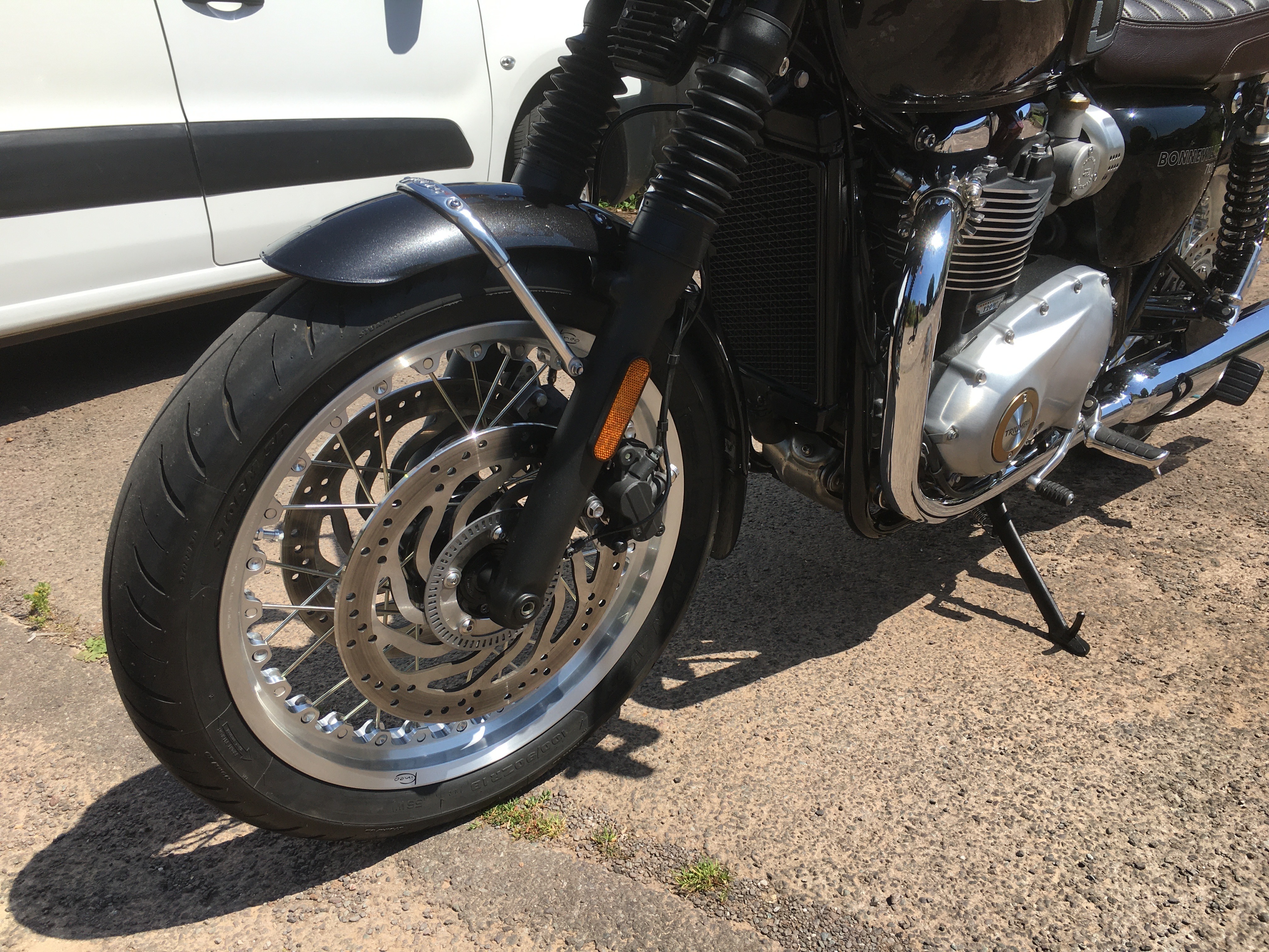

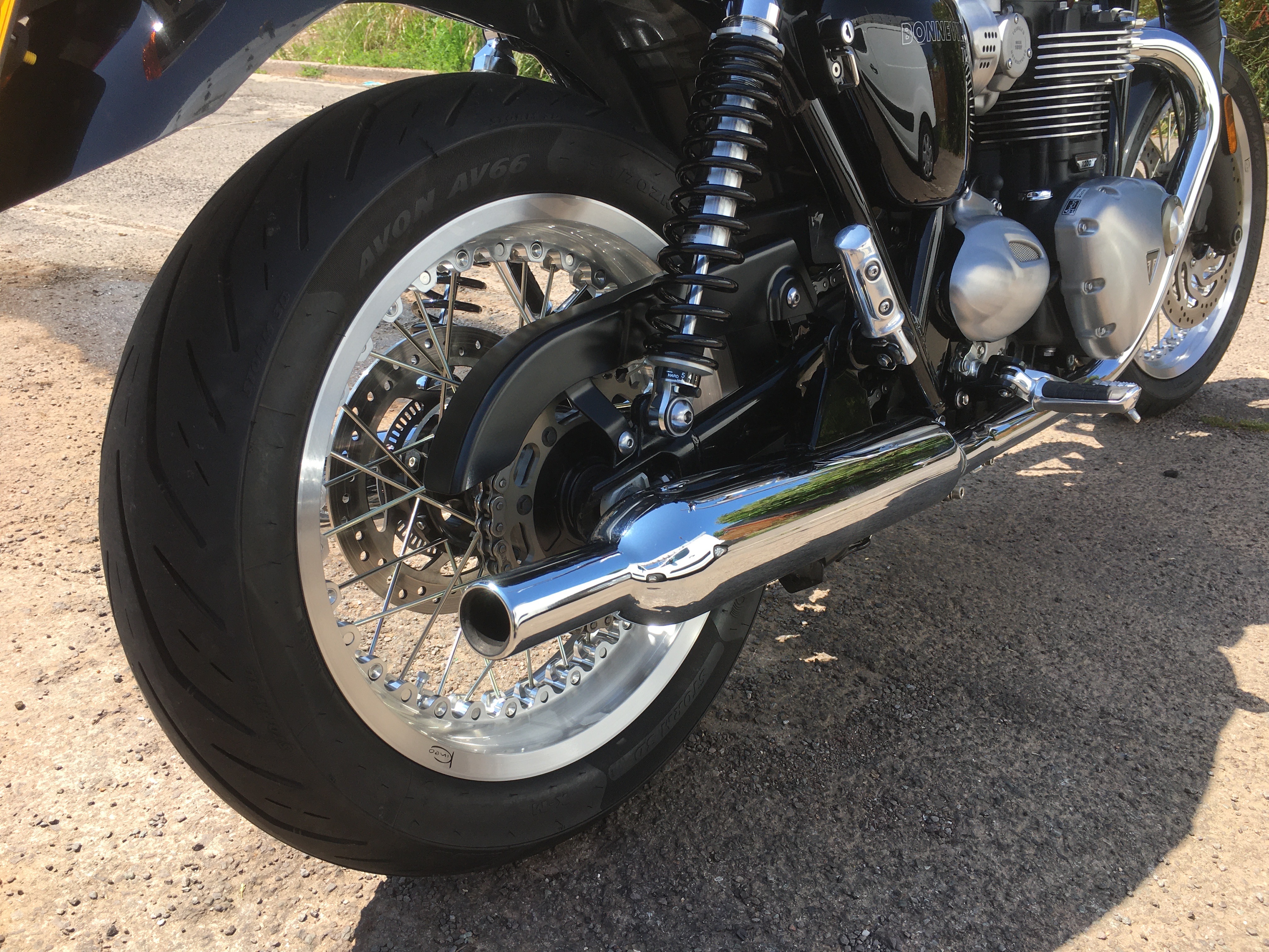

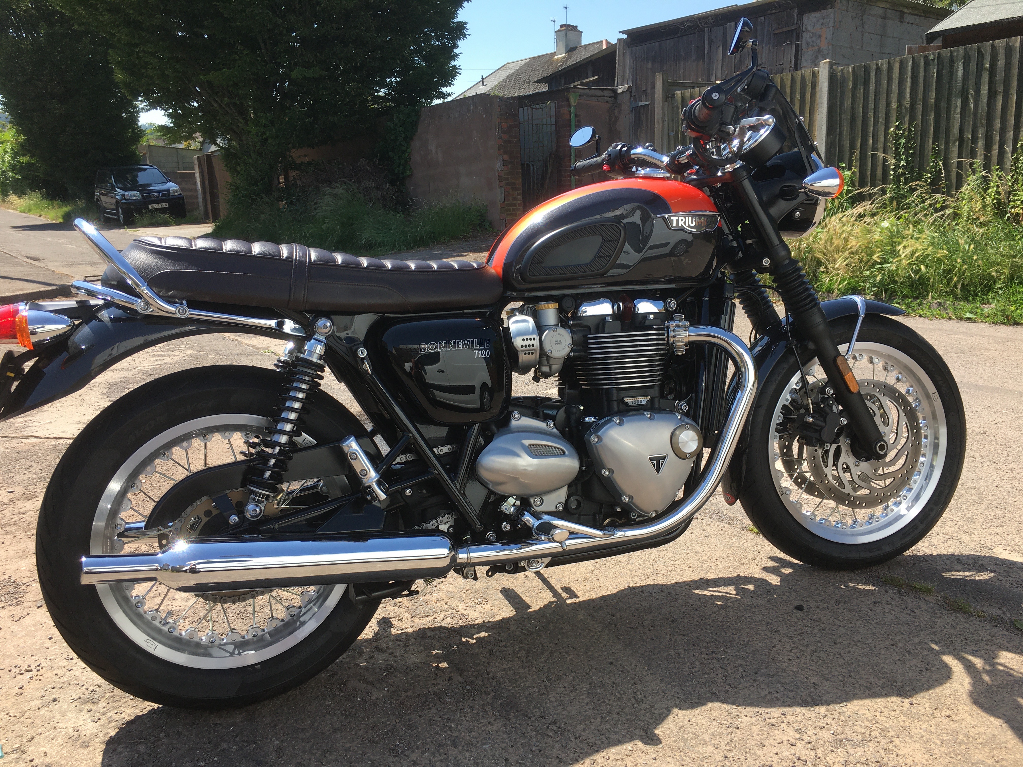

  16. Steve Hill
    Dec 26, 2019
    557
    Somerset
    Got them at last, fitted them last night and had a quick blast round the block. Weight saving on the front is 6lbs and on the rear 8lbs, that's getting on for 6.5Kgs, won't get a good ride till the weekend but even round the block it felt lighter to steer.

  17. bernard j czech
    Jan 17, 2020
    70
    coal township Pa
    lookin good! surprised you did not change the front rotors as many do!
