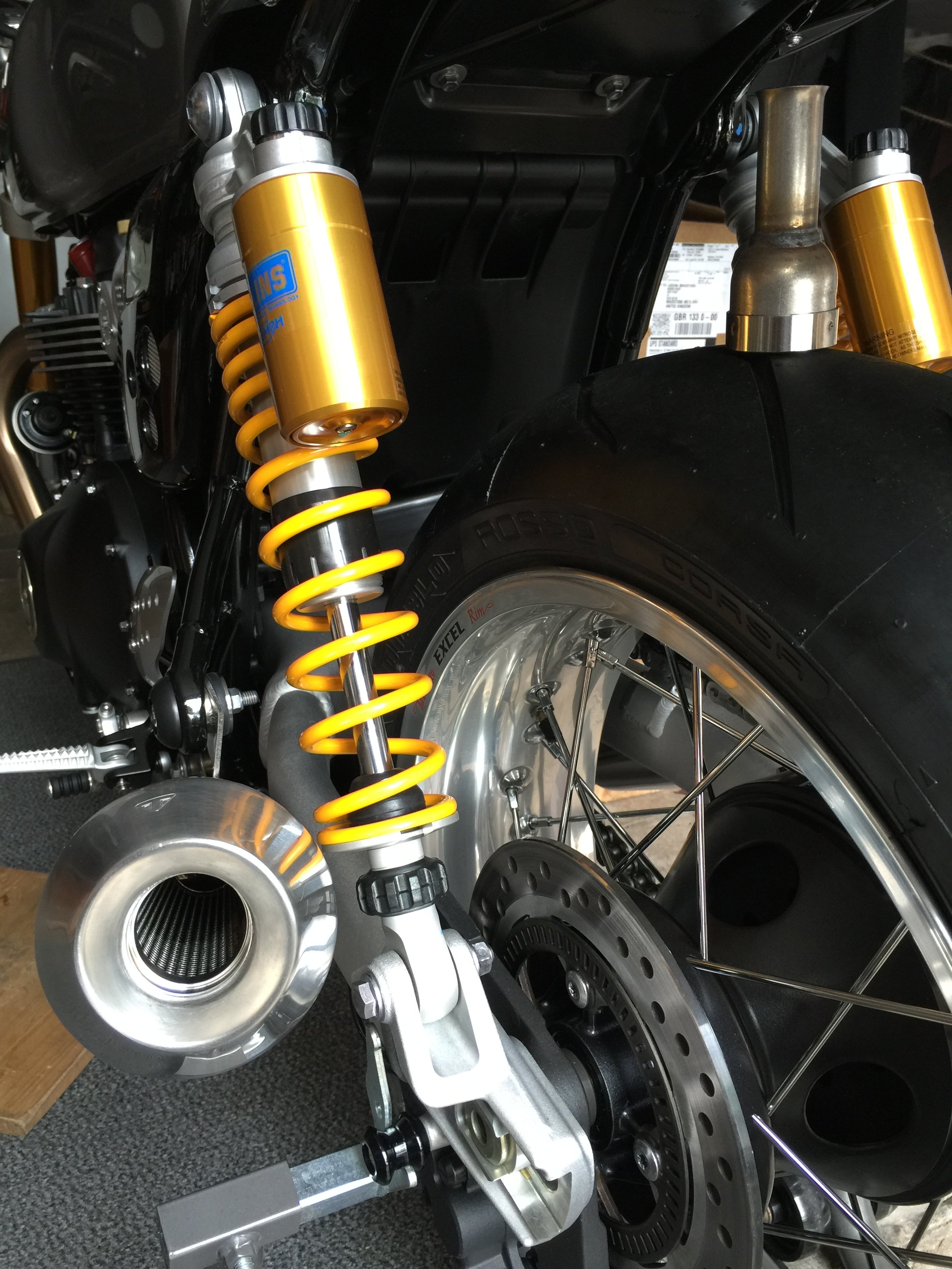

    That's the baffles out - sound is - errrr nice rather than booming loud but I'm not revving the arse off it as the bikes only done 15 miles..will be out at the weekend though. I've no idea how to upload a video link so hers a pic with the baffles on the tyre..

    I used a dremel ( cheap copy ) to grind down the tiny blob of weld. You don't need to grind down completely. There's a little piece of metal between the two ends of the circlip which you can pull out once you've heated up the weld with the dremel.
    I bought some cheap circlip pliers off eBay to pull out the circlip, takes a bit of effort but comes out easy enough...
    The exhausts look so much better without the baffles in...
    Can't wait to get out at the weekend..

    One thing though the exhausts scratch very easily so I would put some masking tape or something round the end just in case you slip with the pliers or similar...

    Mine look like that and I've not removed the baffle, guess the EU one's have different internals. Original Triumph on left with V & H on right.
