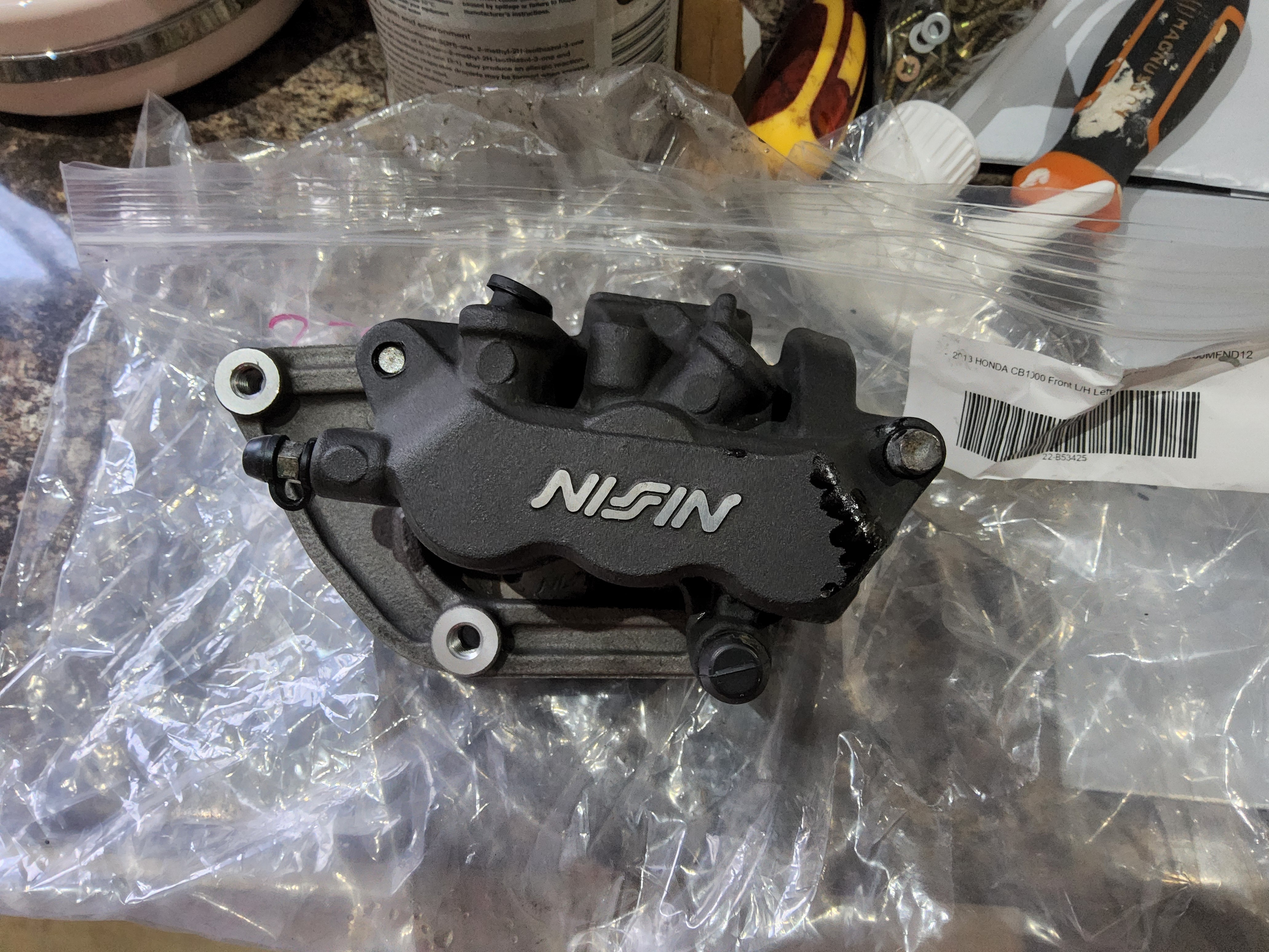

    The glossy spots is wet satin hammerite. £60. Pistons look good and clean. Floating disc, HH disc pads and 14mm master cylinder repair kit (for T595 M/C I have in the shed) in the post.

    Used 3 pot Nissen Honda Caliper = £60

    Caliper on and 12.7mm (2022, 900 Bonnie) 1/2 inch marked master cylinder on. The mater cylinder is exactly the same except for the bore so mirrors, reservoir and brake swith all go on no problem. First bleed done - took some patience to get rid of the worse of the air pockets - but rain stopped play so I'm gonna bleed it again.

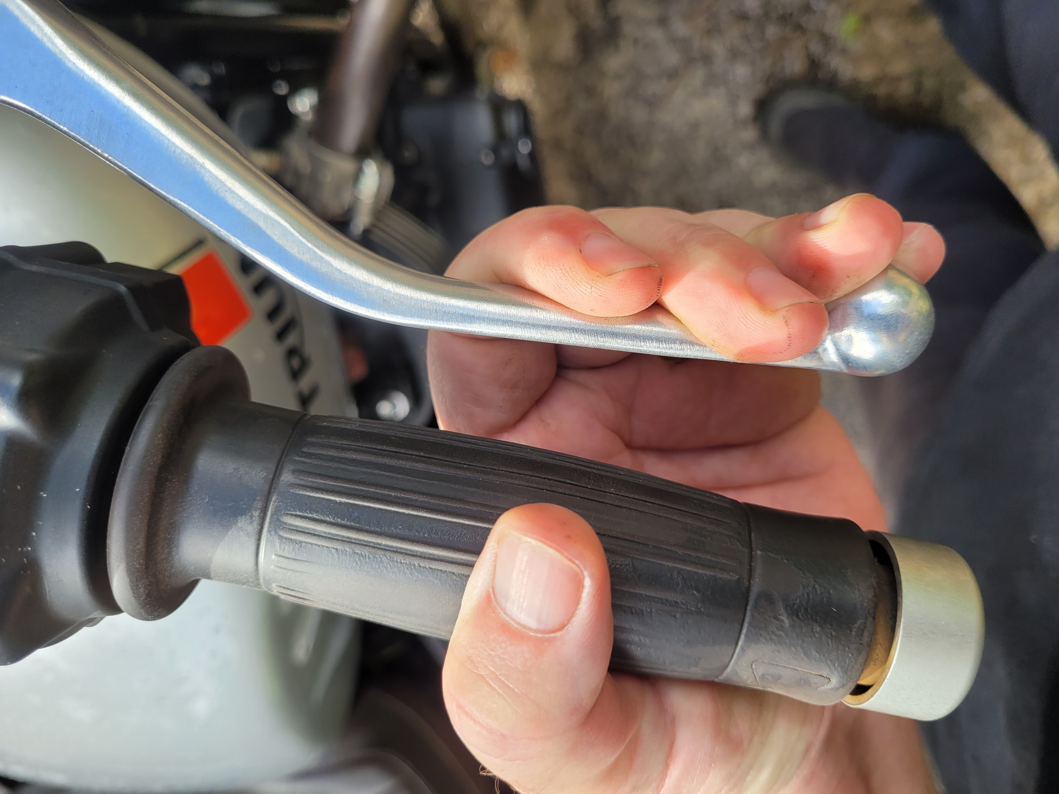

    Lever pull

    I have also bled them again this morning and the lever firmed up a little more. In between the rain I also went out for a 25mile run. Lever consistent, no leaks. Definitely more stopping power. I never thought the standard brake was that bad tbh. 2 up (I'm a 17st fat bastard and the wife is a gorgiously well proportioned 12st) and pulling her down from a ton there was no real reserve power in the brakes - you were using the system, with the rear brake to 90% or so of its potential. Now the engine is done, suspension is done I can ride her swiftly and know I have some 'brakes in my back pocket'. I'm happy - after all, she is no ZXR or Speed Triple and there is a reason why I no longer have such bikes. Basically, I'm getting old and have too many old injuries!!! Lol!!

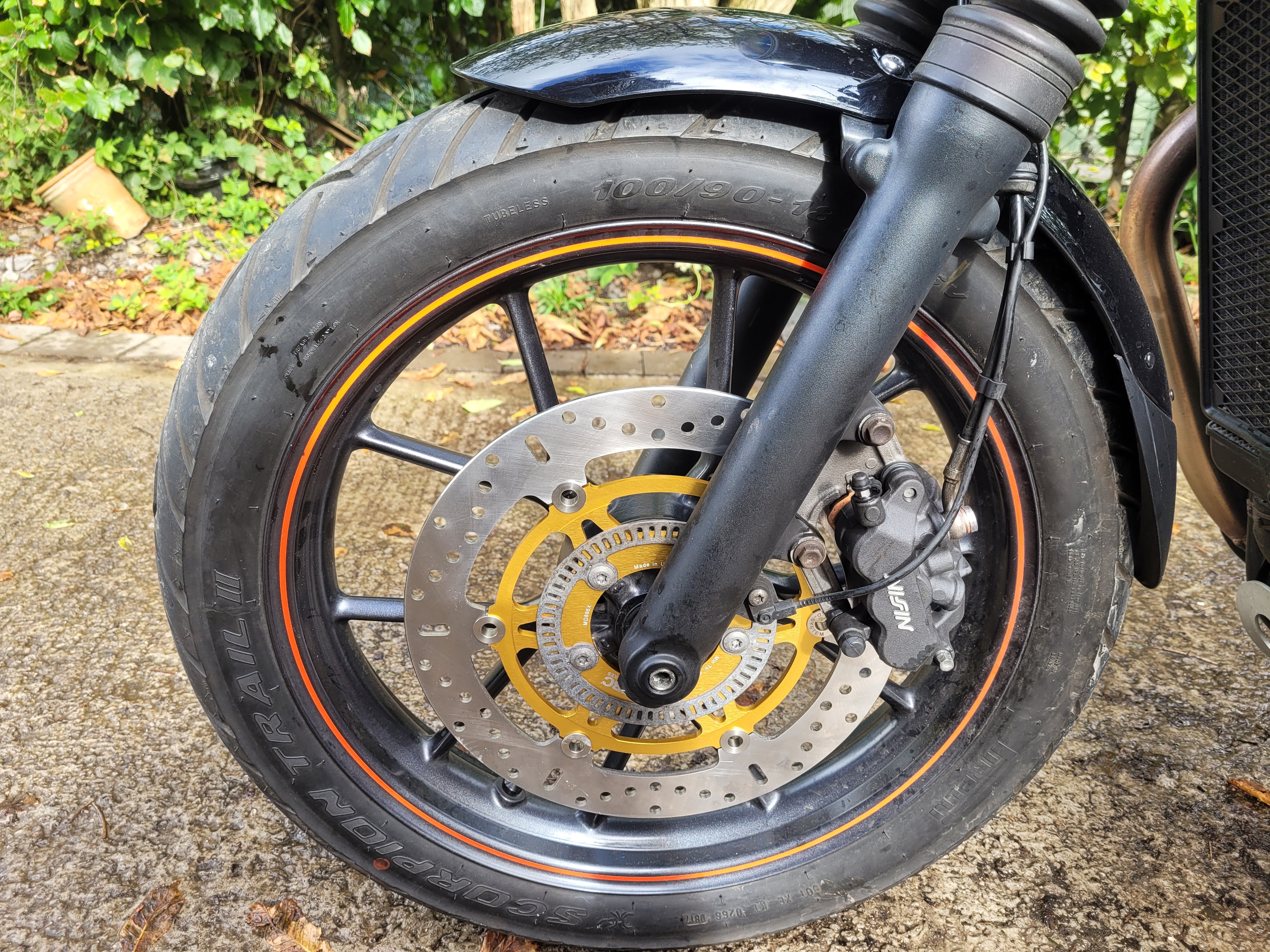

    All bedded in now (after about 300 miles). The 3 pot nissen works great and is effortless on the fingers. The caliper, 12.7mm master cylinder (gen 2 900 bonnie) EBC floating disc (for a Street Cup) and HH pads have really made a difference and feels 'factory fitted'. Very happy.
