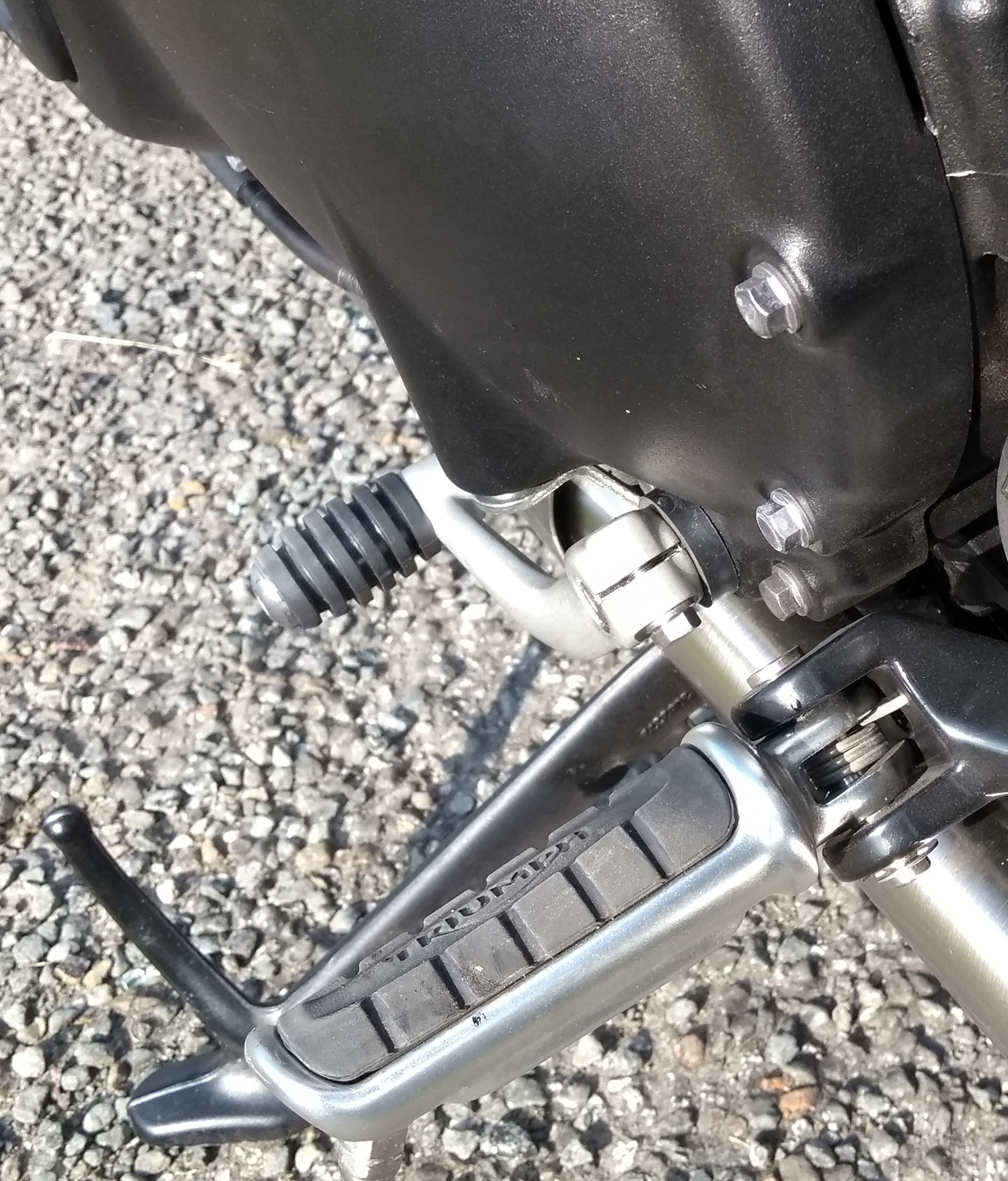

    Hello and welcome, Paul. I too have a 2019 Street Twin. One thing worth knowing about them (and other current Bonnevilles) is that, if you drop them on the left hand side, the gearchange shaft can be pushed inwards, bending the selector forks and preventing changing gear. Fairly expensive to fix. To protect against this happening, just put a suitable spacer or several washers on the shaft between the gearlever and the engine casing. I used a black nylon spacer - looks better than washers. (No, I didn't find this out the hard way, but it's a known vulnerability, and so easy to protect against.)

    Very interesting and the first I've heard about this mod. Last year my ST went down on the left side, while I was on it, because I didn't put the side stand all the way forward and it flipped back as I leaned the bike onto it.
    Once it had gone passed the point of no recovery I made the instantaneous choice to stay on it and cushion the impact. I ended up trapped under the bike but managed to keep most of it off the ground.
    The left bar-end mirror took a blow (slightly bent) and the end can touched the ground (small scuff that only I can see). The only thing that worried me was the gear change lever, which was now slightly curved inwards. Fortunately there doesn't seem to be any damage to the gear box and gear changes are good.
    I'll probably carry out the mod you mentioned. Any chance of a pic or two to show exactly what you've done?

    Hi beerkat (and Paul). Here's a photo of the spacer I fitted to my Street Twin. It just fills the space between the gearlever and the engine casing, but is still free to turn, so as not to stiffen the gearchange action. Just measure the shaft diameter and length you need, and get the approprate size nylon spacer from eBay. I couldn't find the exact length, so got a longer one and shortened it. I haven't put it to the test so far! I hope this helps.

    Hi Beerkat, I’ve just had a look at my bike. Embarrassed to say my practical experience is limited, but I think I make up a little of that in enthusiasm! May I ask please:-
    1. Is removing the gear selector just a case of undoing the small bolt;
    2 Would you possibly be able to share the dimensions of the nylon spacer you specified when ordering on Amazon. No probs of not possible.
