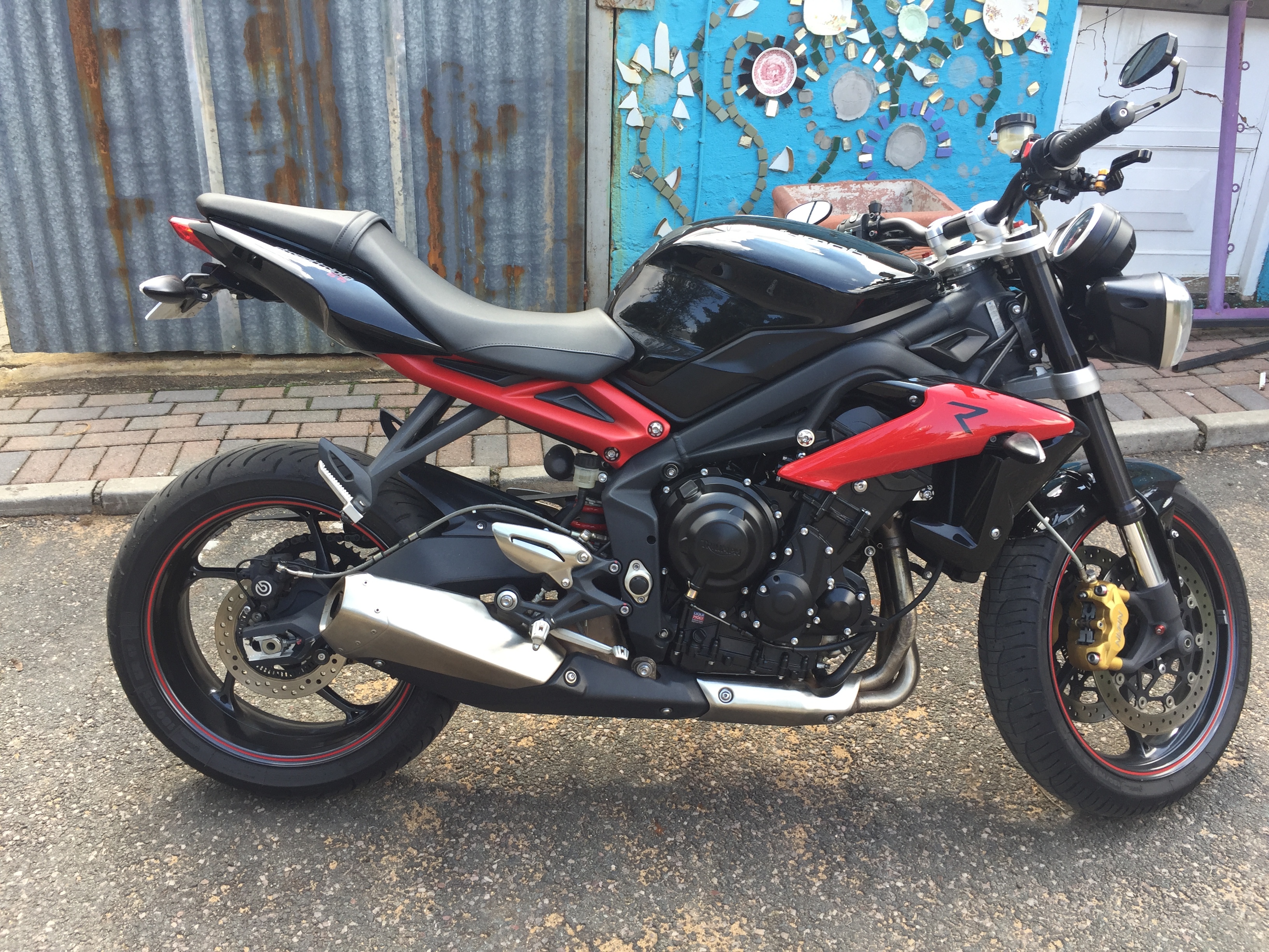

    added pic of bike -
    exhaust and quick shifter should come really soon
