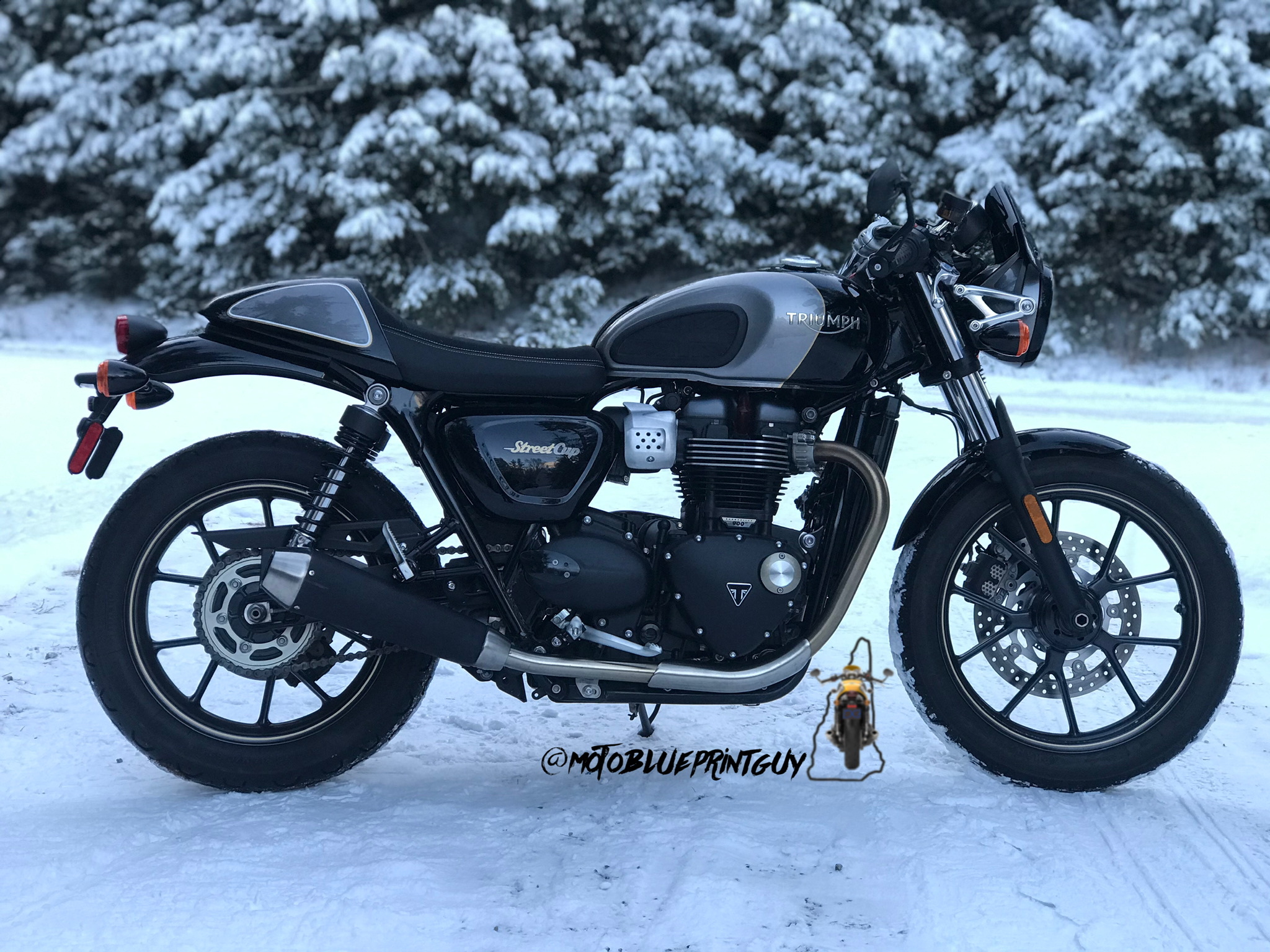

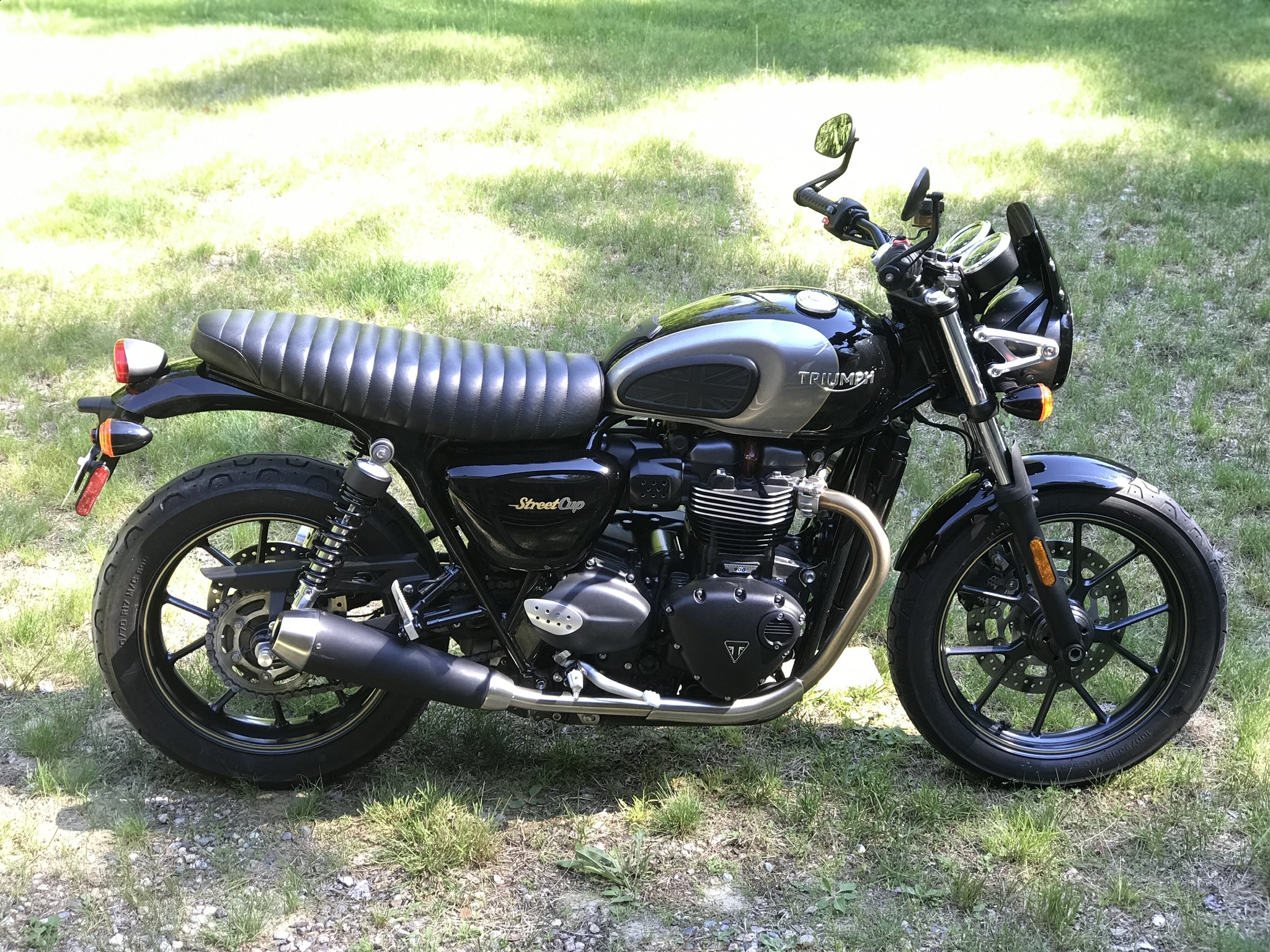

    Before and after

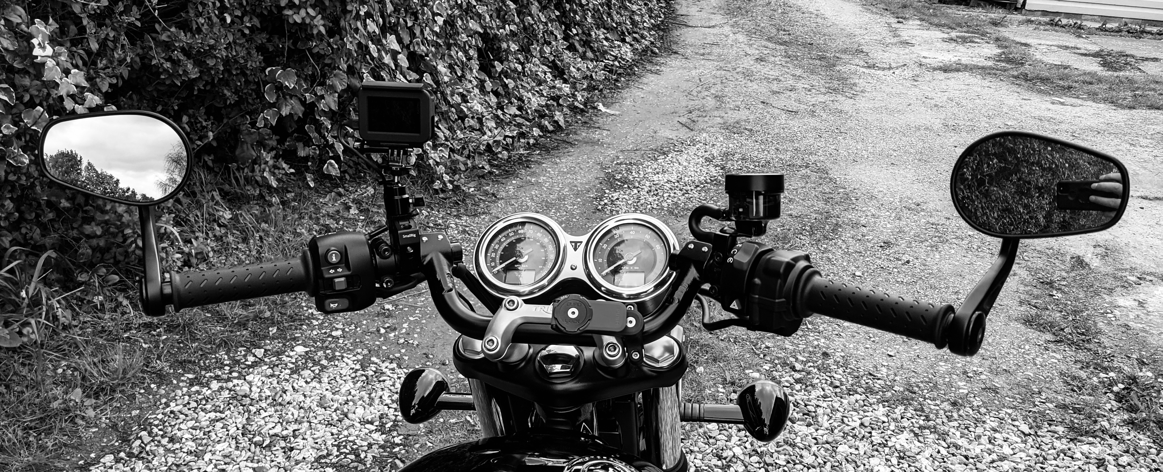

    Hi all,
    Like many of you have been discussing on this thread for the last couple of years, I have decided that different bars on my 2017 Street Cup will make for a more comfortable ride.
    I took the plunge today and simply flipped the main centre “U” bar up the other way and the result is better than I expected! The bar end angles could be better but I intend to ride it for a while to see whether it is more comfortable for my back and arms on a long journey.
    Notable downsides are:
    1. The switch gear notches do not line up when the bar ends are rotated
    2. The brake and clutch cables restrict the handlebar positioning so I may need the longer ones
    Ultimately I think that Renthal Ultra Low bars will be the long term solution for me but this will be more expensive (for the bars, clamps and cables needed).
