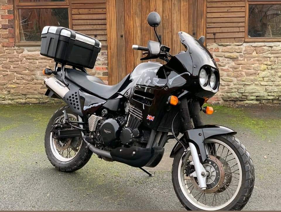

    I’ve just brought a steamer it’s a 98
    Starter spray is silent when starting
    What do these engines sound like?
    Mine seems mechanically noisy
    Can’t pinpoint a specific noise just
    Mechanical noise?
    Cheers all

    I think we'll need a bit more information before giving advice, views and ideas about your "mechanically noisy" bike! What mileage does it have on it? Does it have a service history? When was the oil last changed? Have you had the valve clearances checked? Does it clatter when you spin the motor on the starter button? Can you ride a bicycle, and who scored the goal?? Sorry, ignore the last two as a failed attempt at humour.
    Seriously, give us a bit more info and I'm sure you'll get a LOT more useful returns. As a general comment I think it's fair to say that the early (T3) carbed 900s are a little bit mechanical and 'rattley' - the cam chain tensioner and guide can be noisy on high mileage bikes - but you shouldn't have any seriously loud noises coming from the engine. If you have it needs to be investigated. Soon. Consider having it serviced by Clive WOOD - he's in Swineshead, Lincolnshire and very busy so if you are going to do it - book soon. CW is THE man for service and repair of T3s - far cheaper than a stealer; super nice person with a great set up. He also does T3 course days - care, maintenance and repair of the range. He has one coming up in October but they are limited on numbers and book up pretty fast. Try a text to 07752 477738 if you're interested.

    It’s done 13000 miles and hasn’t done any miles in the last 8 years
    I’d love a fellow owner to listen to it and let me know if it’s normal
    When I hit the starter it’s fine no sprag clutch
    Problems
    Cheers again

    This forum is also known as 'Luddites 'r' Us', so you will feel very comfortable here. These engines are indeed a bit noisy, but keep the battery fully charged and change the oil/filter regularly and all should be well. My '95 Trident 900 has over 54,000 miles on it and is still very healthy. Enjoy.:)

    In a nutshell, Trident, Daytona and Tiger 885 carb'd engines are virtually the same with slightly different states of tune. Thunderbird engines have a lower state of tune and are different externally but mechanically very similar. All have similar quirks and foibles but are essentially bullet proof.

    Later sprags were beefed up, I think. The best bit of advice regarding the sprag has already been given - KEEP THE BATTERY IN GOOD CONDITION. ALWAYS. Do NOT try to start it up if the battery is low/weak and the engine is cold. A damaged sprag on a bike without the removable 'hatch' plate on the top of the engine cases will, eventually, require a very extensive (and expensive) engine stripdown.
    Have the valve clearances checked and adjusted on schedule. Use decent oil and change it frequently - it's 10W/40 semi-synth. - and decent filters. The air filter is a bitch to change but there are hacks to make life a bit easier. Sprint Manufacturing in Wiltshire are good for most of the service items you'll need and are also very good for spares,new and used.
    Other than that - ride and enjoy. The carb'd Tiger has more of what might be the over used and ill defined term "character" than, arguably, any other period Triumph - probably because of it's really oddly 'butch' appearance and grunty nature, but it is a very pleasant place to be when it's running well!

    A bit about my steamer
    It’s a 98 and I brought it without hearing it run
    It had been parked up many years
    12 I think all verified by mot history etc
    I brought on condition as apart from the tank blistering it was in beautiful nick
    Anyway rebuilt carbs flushed tank and pet lock brakes overhauled and oil and coolant change and a brand new battery
    Fired straight up and loads of crap from exhausts
    Clear now runs spot on starts first time
    And it’s done 14000 miles
