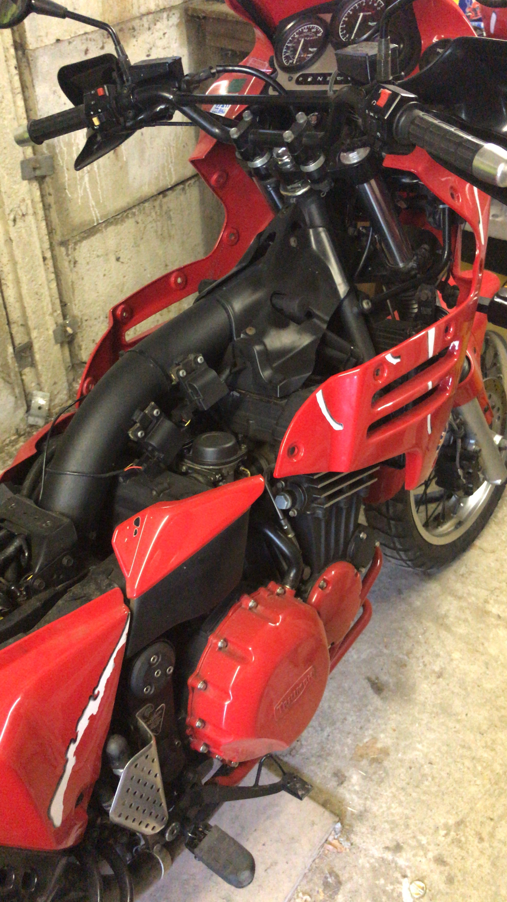

    This bike hasn't had its engine changed, has it?
  3. Unfortunately i cant tell as there is no proof of an engine number so cant compare to V5 so its very possible it has been changed and my casings above clutch cover are all one cast so no hatch for accessing sprag although theres no rattles or bangs when starting or running
  4. Arudge
    Arudge Member
    Apr 3, 2019
    48
    Cradley Heath
    Yours is a later example than mine, mine being July 1993. Yours has seen a lot of changes, respray, exhausts, front indicators have been changed. The images are good quality but I can't see any clues regards an engine change.
    I'm away from home at the moment so I can't look at mine, but I'm thinking of a way to extend the gearchange shaft so you can rotate the lever, right now you gave a casting in the way.
  5. I tried to remove the clamp so i could try on my speed triple one but there was a lip on the frame that stopped the clamp coming off, i would need to cut a clamp weld on an extension and reattach the connecting tag, for the moment i will concentrate on mot

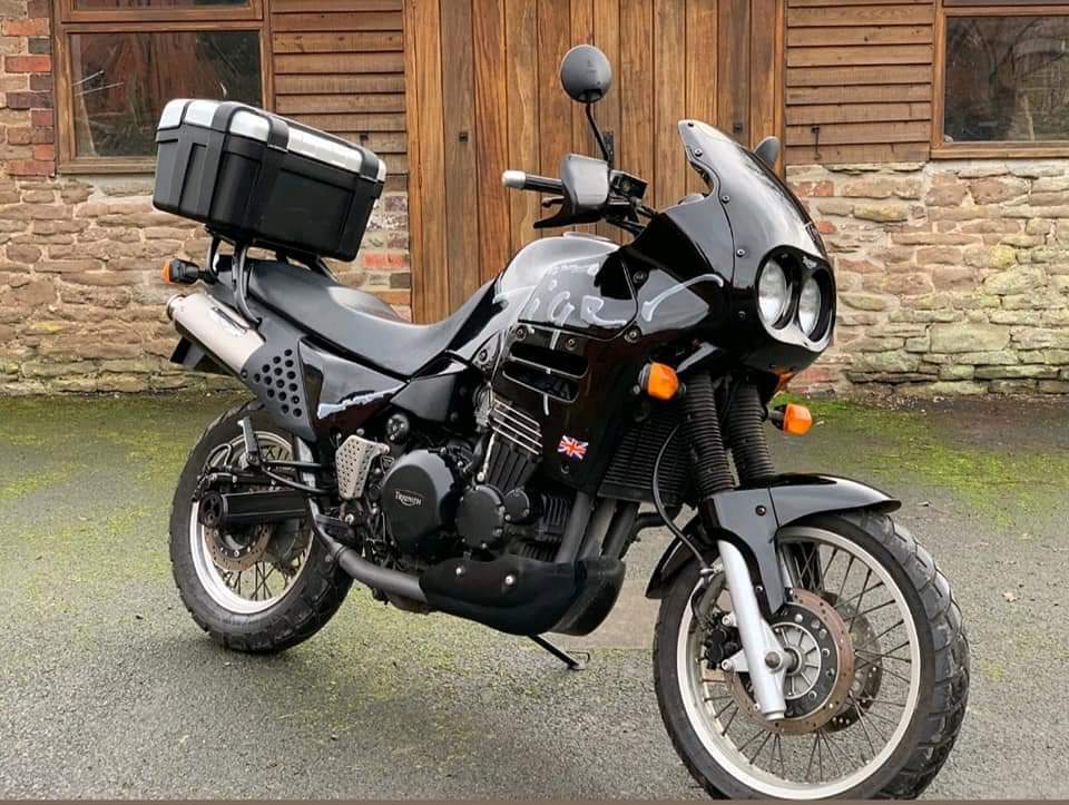

  17. Clarkey231
    Clarkey231 Noble Member
    Jun 9, 2016
    473
    313
    Exeter
    Hi well got the Steamer home from Liverpool but not without a bit of drama. After about 4 miles the bike started losing power. At first I thought it was an electrical problem. Forced to stop at the side of the Motorway on 3 occasions. Made it to a services and called the AA. I’d looked around but missed the fuel hose from the petrol cock was crimped over at near 90 degrees so as it got warm the rubber collapsed causing fuel starvation.
    Bit of hose and a couple of hose clamps and we are away.
