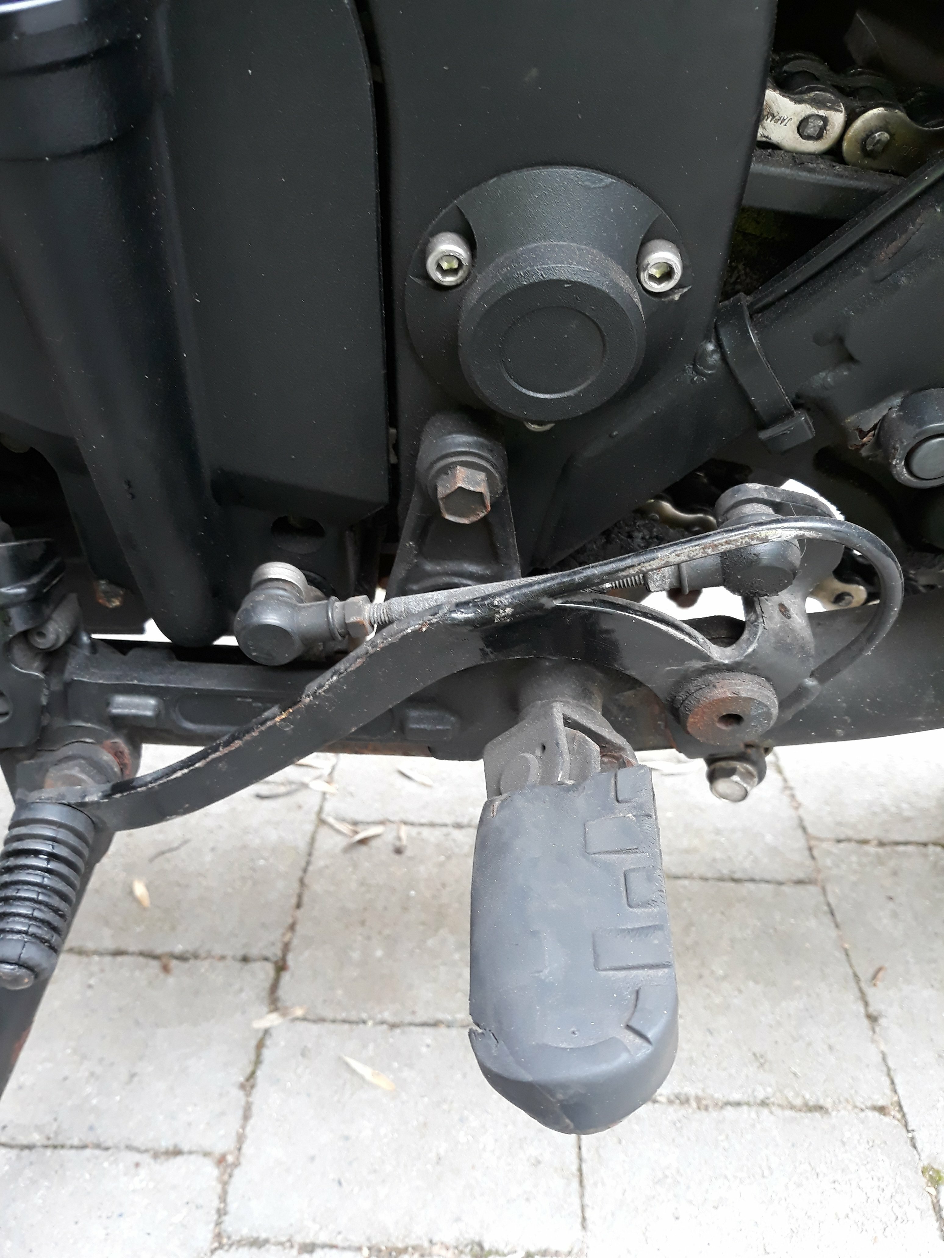

  4. I am in need of help from Steamer owners, on my Tiger the gear linkage must be wrong as its up for 1st and down for rest, comparing my speed triple linkage to my Tiger and easy to see the linkage on the Tiger comes from above the shifter where as the speed triple comes from below, i was wondering if any owners would take a close up of their Tigers linkage so i can work out where mine is going wrong

  6. Many thanks for the picture which is exactly the same as my Tiger even down to the wear on the footrest rubber, will have to investigate further, of course it could be my mate havering as i havent ridden the bike as yet still waiting for pension to come.

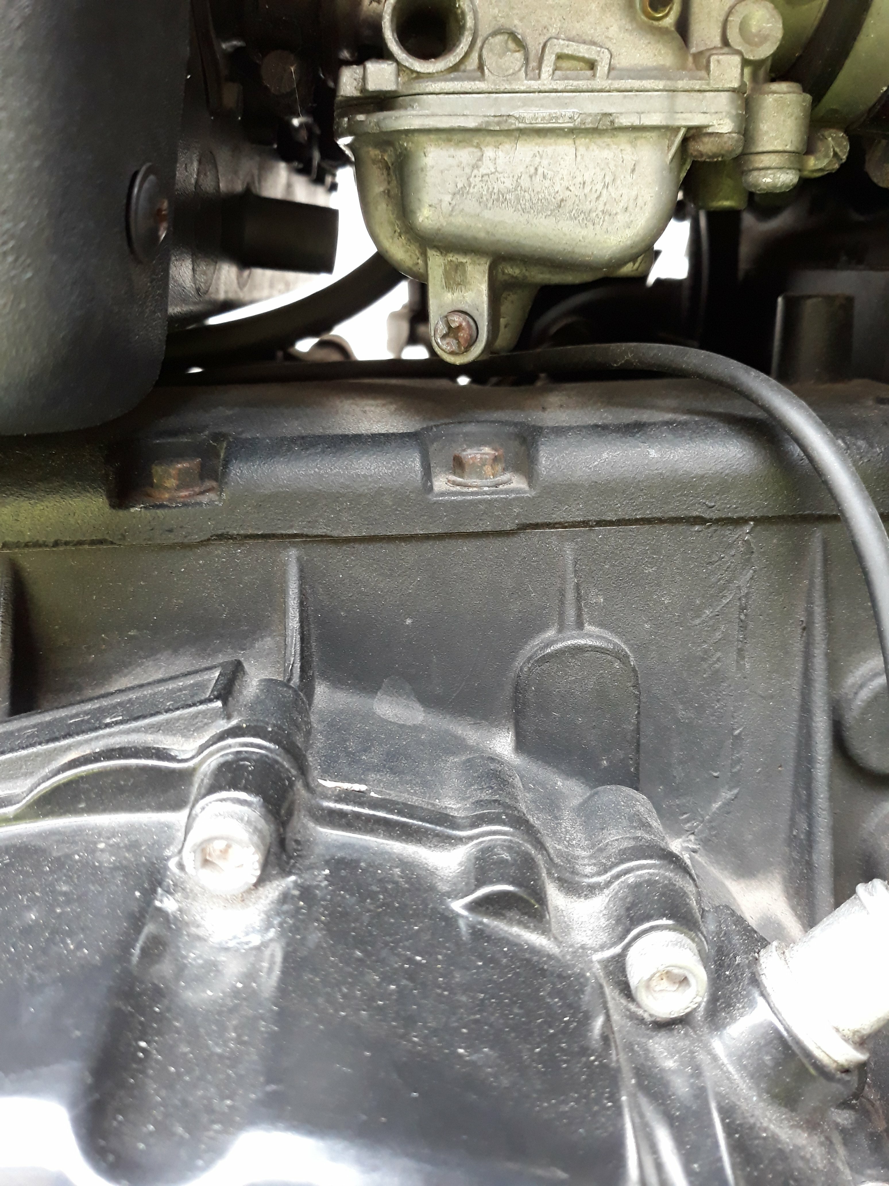

    First thing you need to look at is the removable cover above the clutch housing, because this is where you pull the sprag bearing out of. Does yours look like the image? That means to say, is there a bolt down top, or is it a solid casting?
  9. Many thanks, Will have a look at weekend as bike is still at my mates

    Straight up my Tiger Steamer gearbox is opposite to my Speed Triple
    No idea if this is normal or a previous owner has altered the box
    Need to manufacture a shift shaft clamp that actuates from the bottom of the shift shaft to change orientation of the shift shaft
