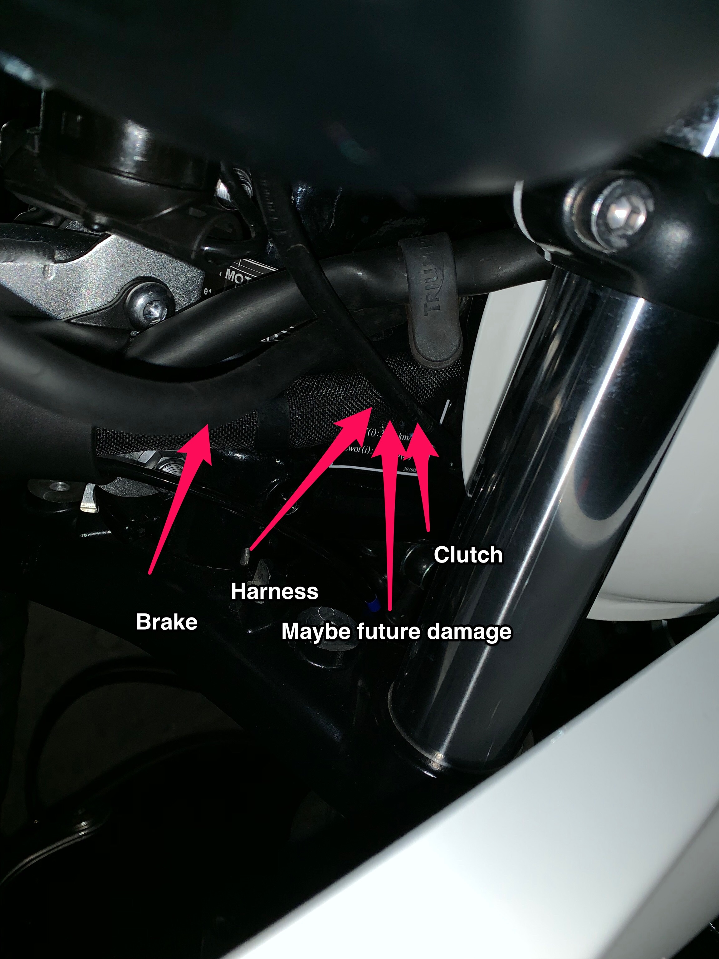

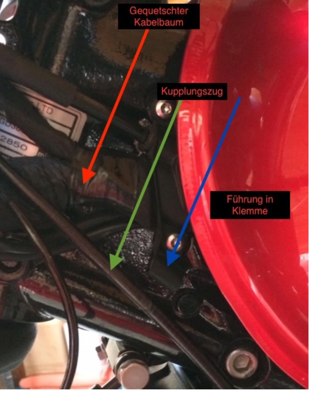

    Are your cables in the same position as mine? (Electric, brake and harness)

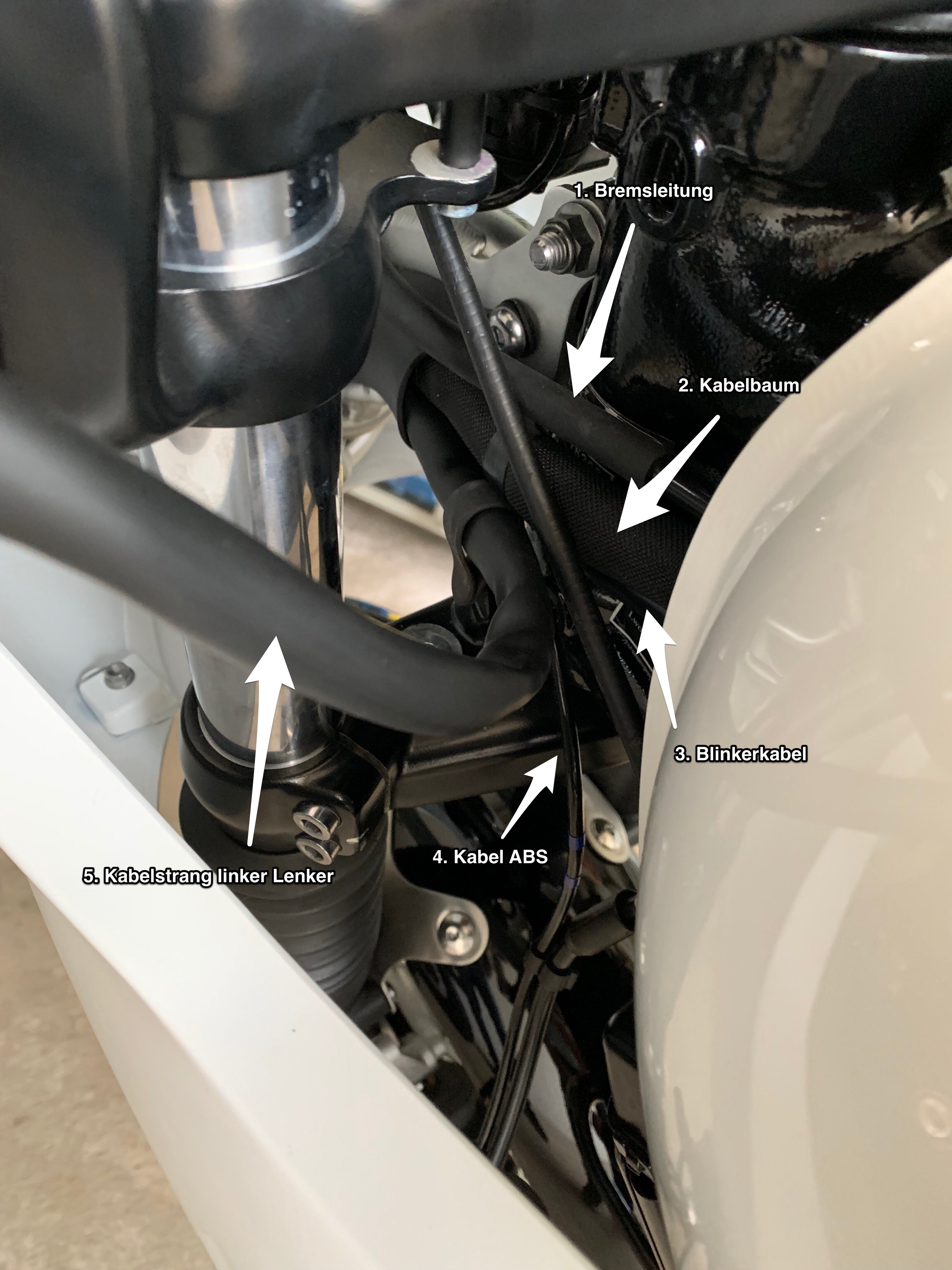

    Ok, at this time there is a factory recall (bonneville t120 and street twin) because the clutch hits the harness, this makes me uncertain
    On pictures i saw, its the same problem like mine

    Here is the pic from the street twin problem

    I did refer to problems of routing clutch cable, brake hose and harnesses in my earlier post to this thread. These problems are not just associated with a change of risers. Anyone with a fairing should take a good hard look at where all the cables and wiring are going and what happens to them from lock to lock as it there are potential problems with the original design.
    Ex-factory the clutch cable passes through the bottom part of the harness clamp on the headstock. I took it out of this clip so it just hangs down until it passes into the top downtube clip. Seems to be alright after 5,000km.

    I’ve done the same and I also rerouted the loom but the clutch cable still sits tight to the back edge of the loom, I don’t think there’s going to be an issue, only time will tell

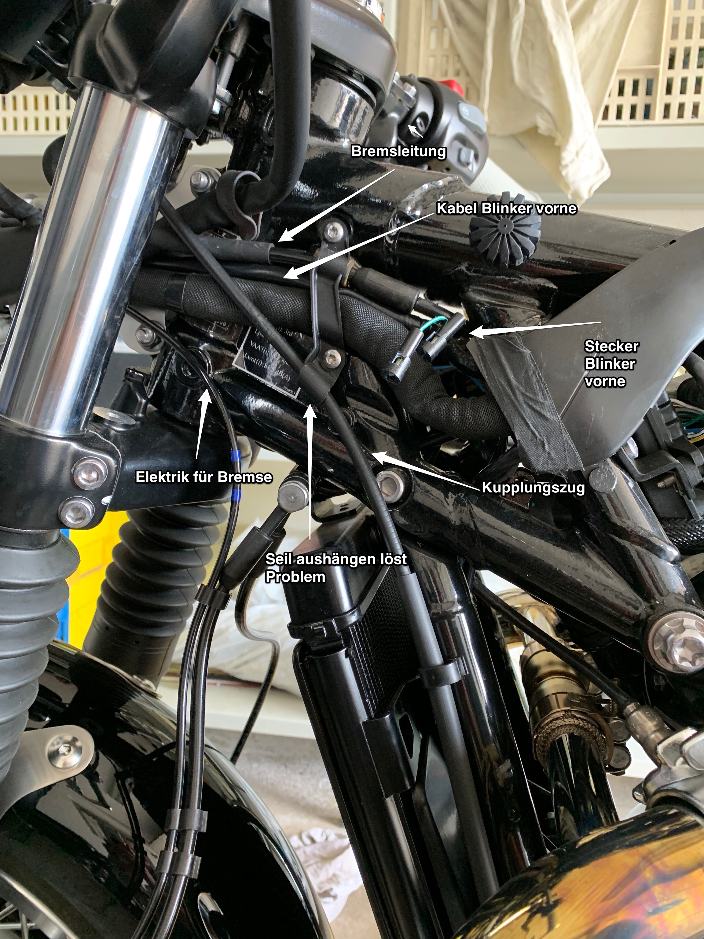

    I solved the Problem today, 3 Hours of work.
    I rerouted all the cables in the headlight, i got 2cm more space at the harness. The most efficiancy thing was removing the clutch cable from the first clip, now it isn‘t tight yet.
    Here the Pictures before and after, sorry with german comments

    I also mask the nameplate with a foil, if you dont do this, the harness/brake hose scrubs the plate...

    You‘re right glyn, see here:
    Summary
    The two wire conduits in the aftermarket Cafe Racer Fairing kits have insufficient clearance and may cause damage to the wiring.
    Consequence
    Damaged wiring may lead to an engine stall or loss of the headlight or turn signals, increasing the risk of a crash.
    Remedy
    The remedy component [Part No. A9708524 (Thruxton) and A9708522 (Thruxton R)] includes larger apertures than the recalled component.

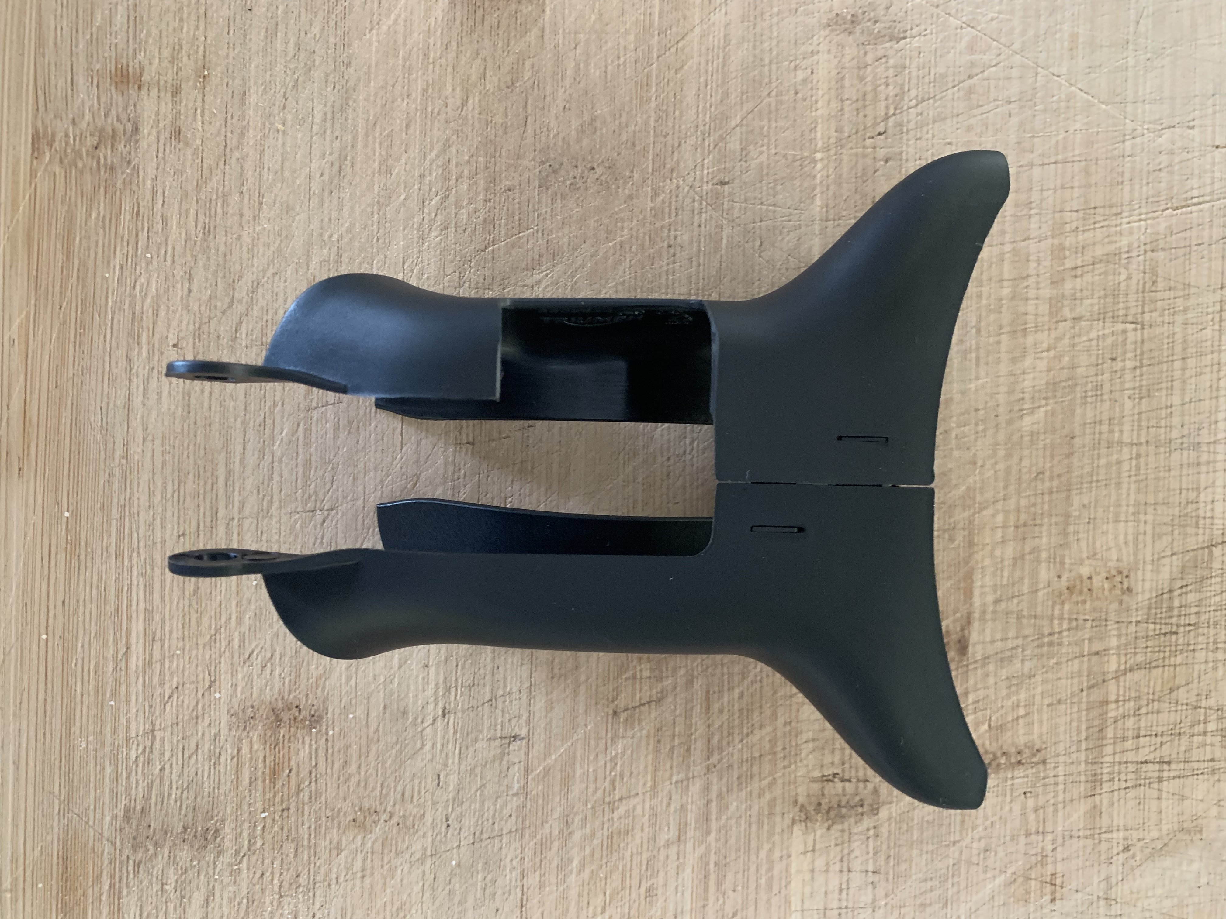

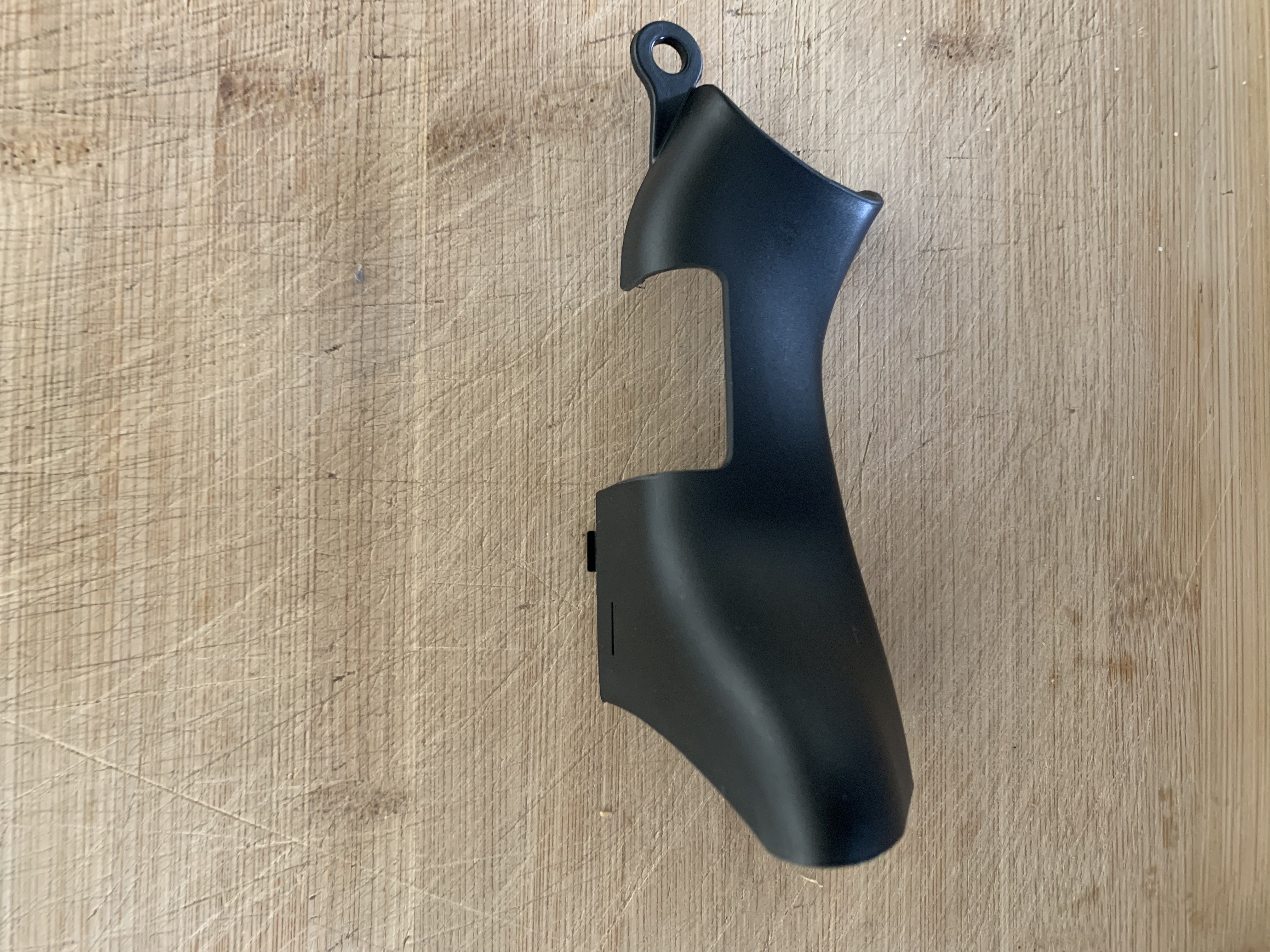

  20. DaMuck
    DaMuck Member
    Feb 16, 2019
    58
    Austria
    Hi glyn, here are the new parts, i fixed it today.
