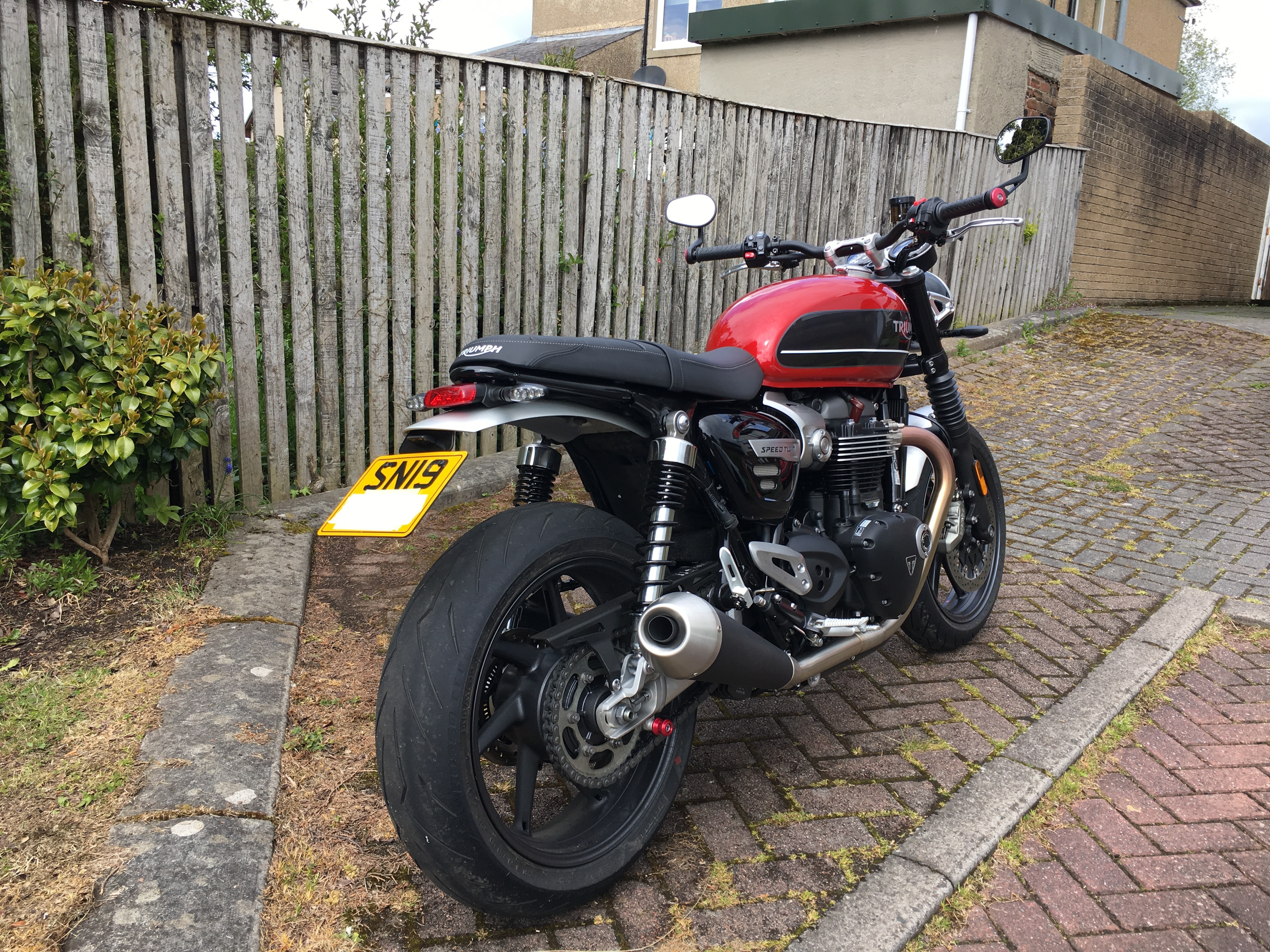

    tecbikeparts tail tidy fitted and smaller 8x6 number plate (yes I know it not strictly legal), looks the dogs although I say it myself :joy::joy::joy:

    Nice job Bryf. Regards the number plate, no size is actually specified by authority. Only the size of the letters/numbers, the spacing between them and the size of the margin.

    Thanks Tallpaul, didn't know that info regarding No. plate size so thanks for that as well

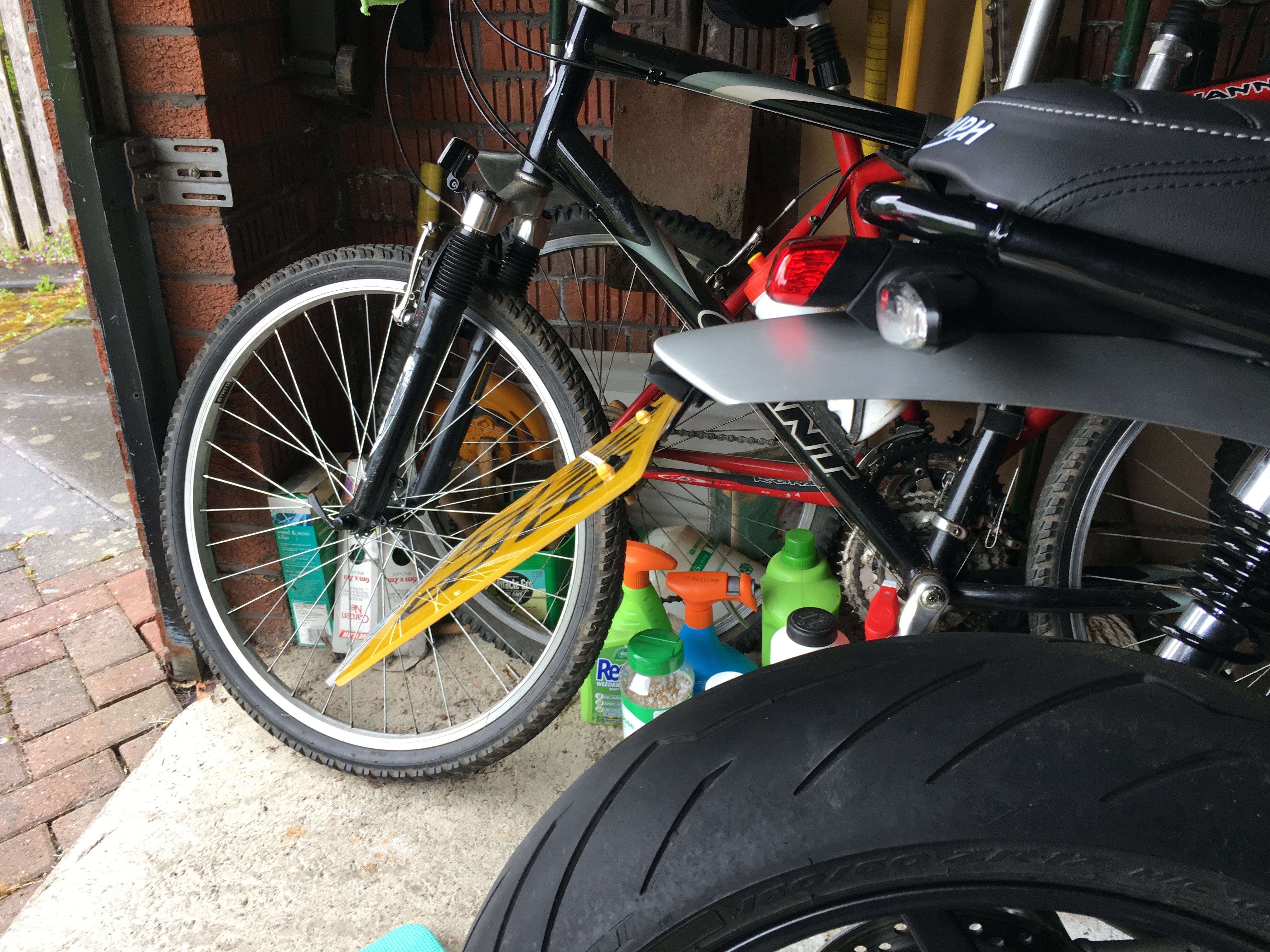

    For anybody else reading this, it is possible to take the OEM registration plate hanger parts off and throw away the upper part (P/N 2308268) then re-assembly the other two parts on to the bottom of the steel pressing under the mudguard, they'll assemble with the regplate light just underneath the rolled edge of the mudguard.
    Snips is required to snip off the little 'towers' that locate the harness in the lower moulding and you may need to add some clearance to the lower moulding for the head of the fixing that's in the middle of the steel pressing too.
    EDIT: See Steve's post on Page 1, just spotted it now, exactly what I was on about
