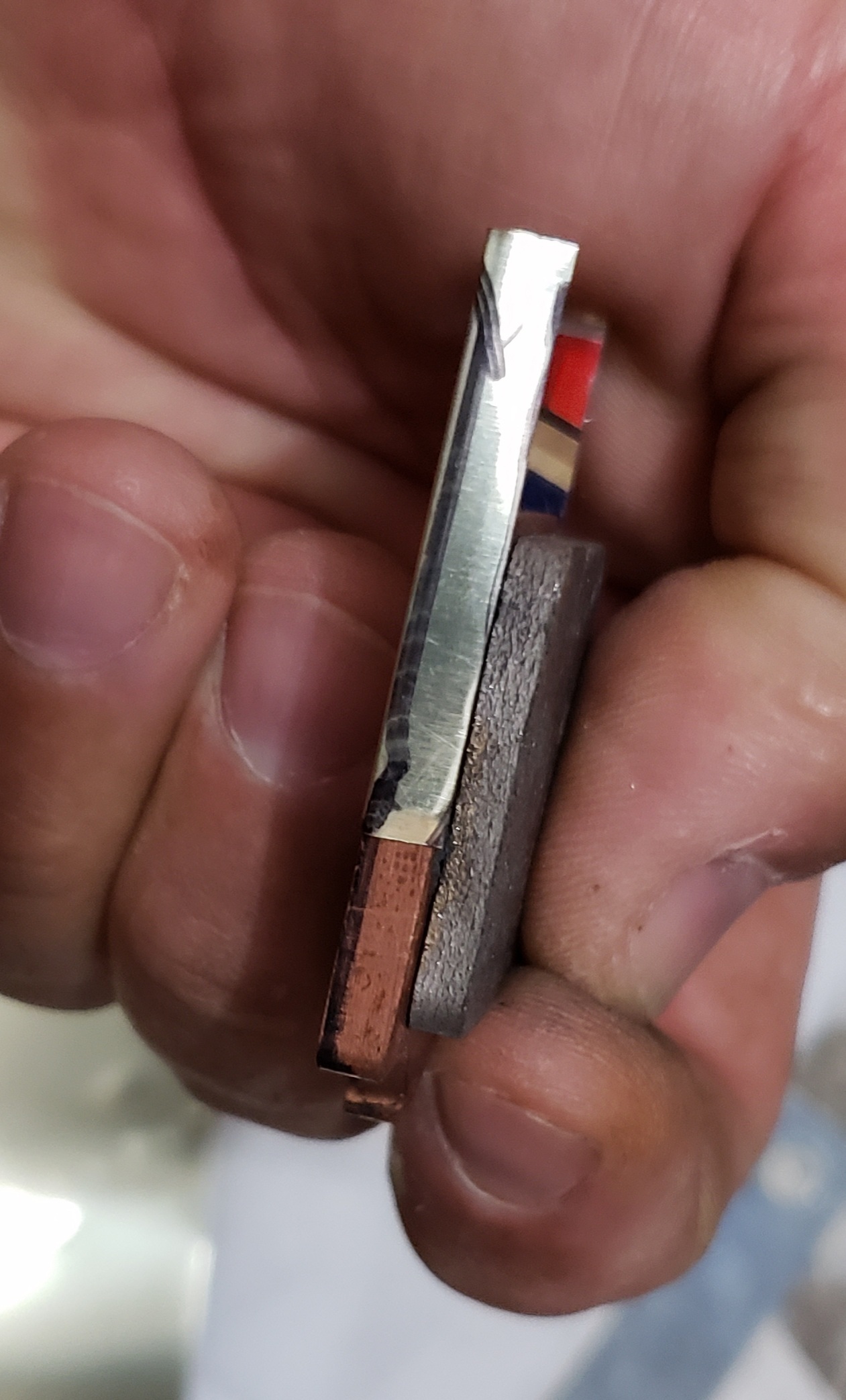

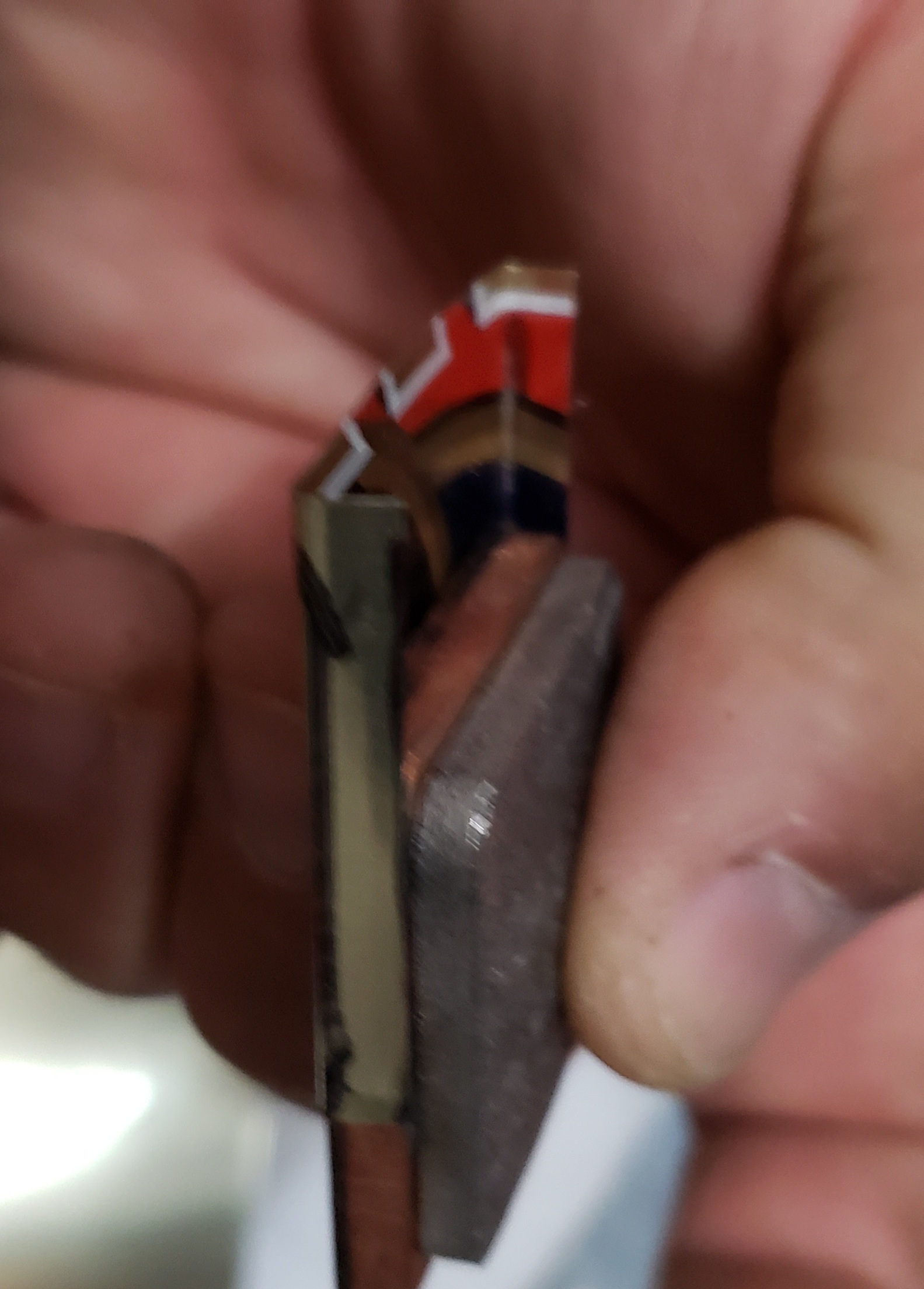

  7. dilligaf
    Please excuse me if this has been asked before :(
    Do the pads on the Speed Twin have shims???:confused:
    #87
  8. andypandy
    3,788
    4,082
    I'm guessing not so maybe a case of saving those empty baked bean tins.;)
    #88
  9. Acadena
    Acadena Member
    Mar 21, 2020
    36
    46
    Rio de Janeiro-Brazil
    No. They do no have. And I am producing it at home just in case the problem is not solved with the disc change.
    #89
  10. dilligaf
    Right :mad:well I think it’s Feckin ridiculous that Triumph and more importantly Brembo haven’t supplied ALL Speed Twin owners with pop on shims for these bikes :mad:
    FFS:mad: shims and a dab of copper slip is probably all it would take :mad:
    #90
  11. dilligaf
    :mad:Feck it :mad:
    I have to say it again I CAN’T BELIEVE THAT NO SHIMS WERE FITTED FROM THE START :mad:
    #91
