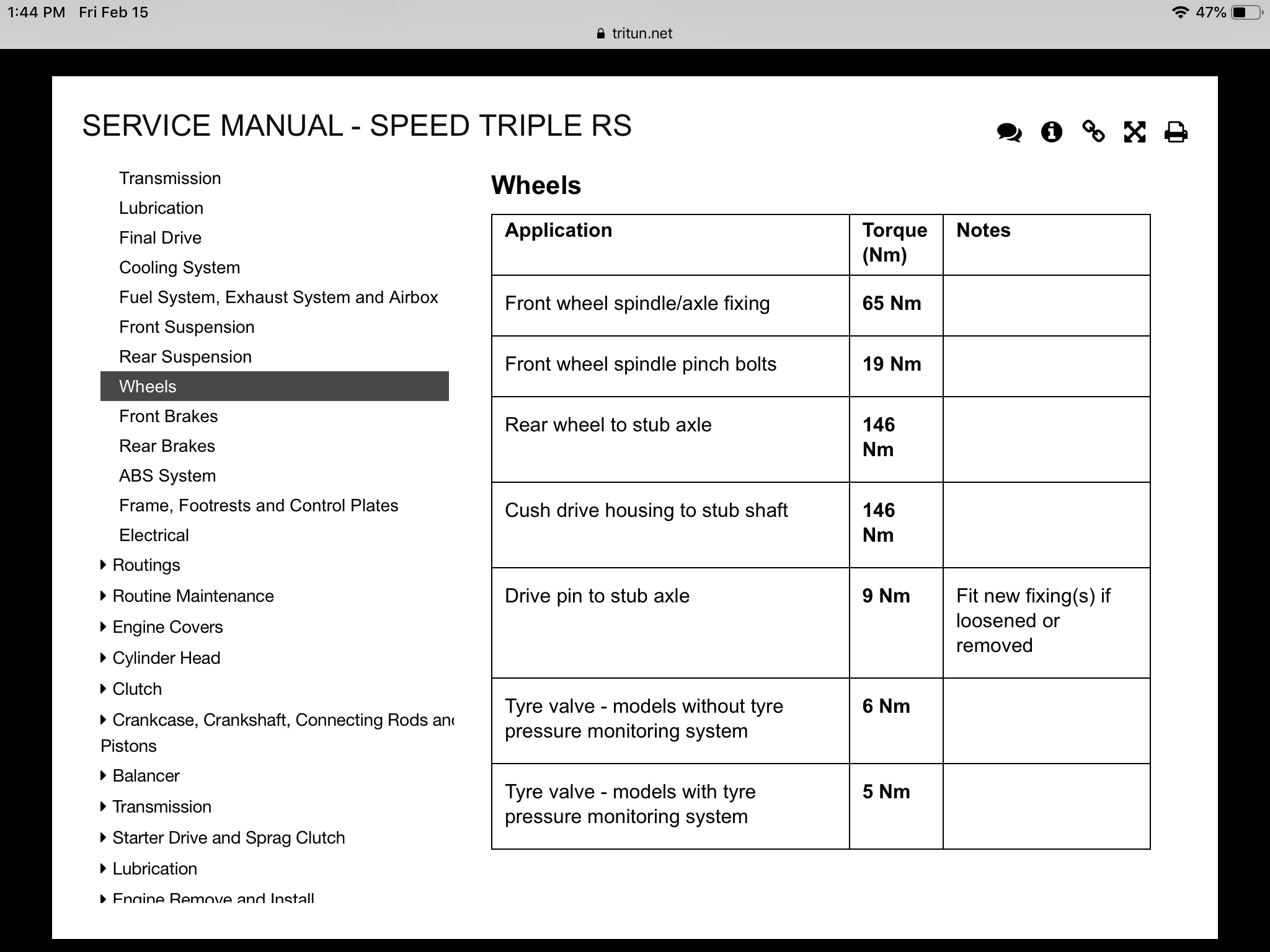

    Aren't the torques for removing the wheels in the owners handbook?
  2. SteveRS
    SteveRS First Class Member
    Jan 12, 2019
    862
    British Columbia
    Not that I can find. That’s why I downloaded those pages and more from the service manual.

    Haven't seen the manual in question but Ohlins forks were fitted to pre 2018 Speed Triple R's too, there are seperate sections in my service manual for the R forks etc. (my 94R has black anodised Ohlins identical to the later bikes).
    It is critical that the pinch bolts on Ohlins forks are not over tightened, there have been cases primarily on Ducatis, of the lower casting cracking due to this. One of the reasons why I would never take my bike to a tyre depot for wheel removal.
  6. SuperHans
    SuperHans Senior Member
    Mar 11, 2020
    297
    Sweden
    Very good info, its these sort of things that I want the real workshop manual for. Or a manual that cover the years of the bike.
    Things has changes throughout the years and its important that stuff like the right torque is applied.

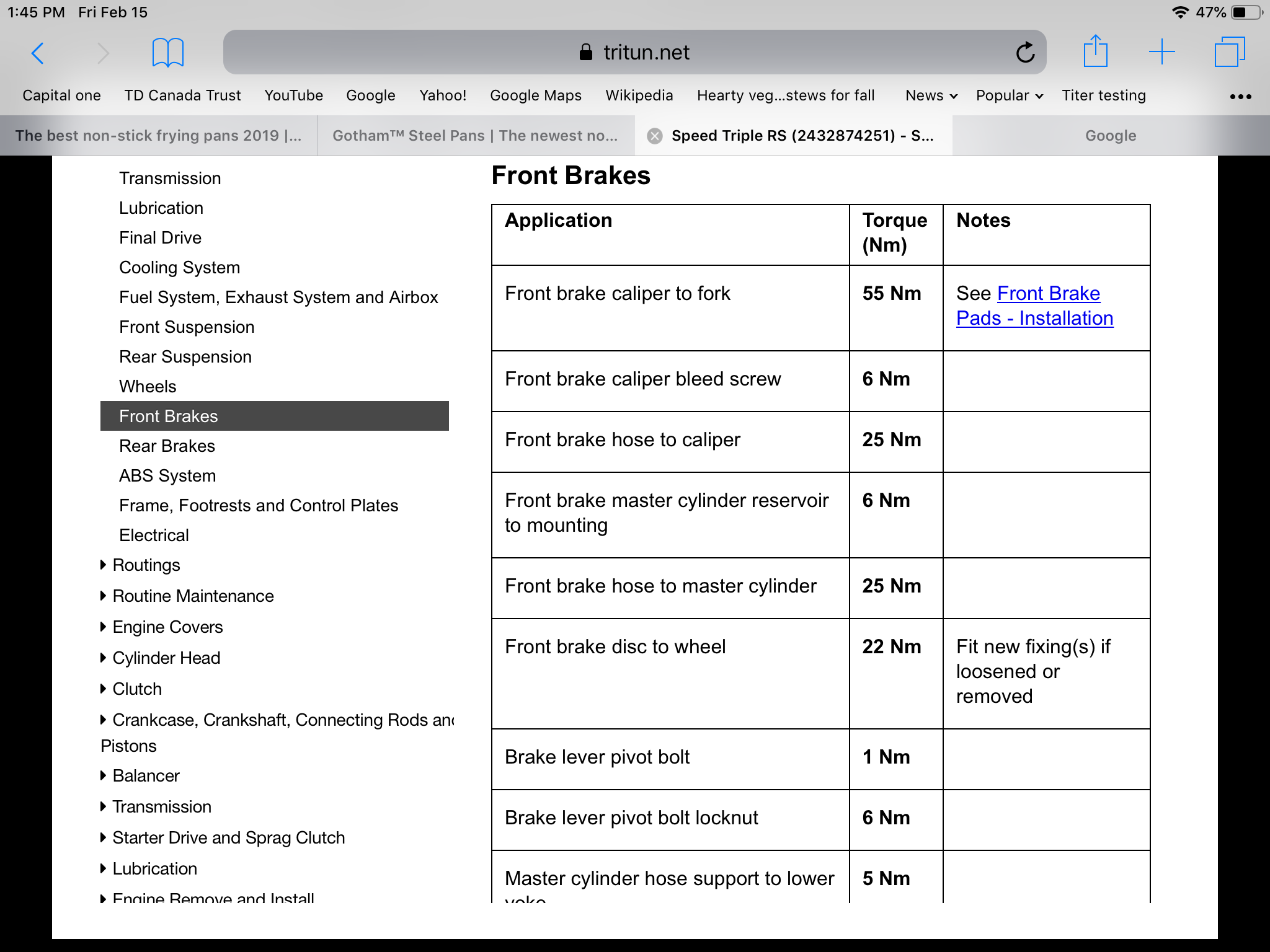

    Then your caliper torque setting is 55nm.
