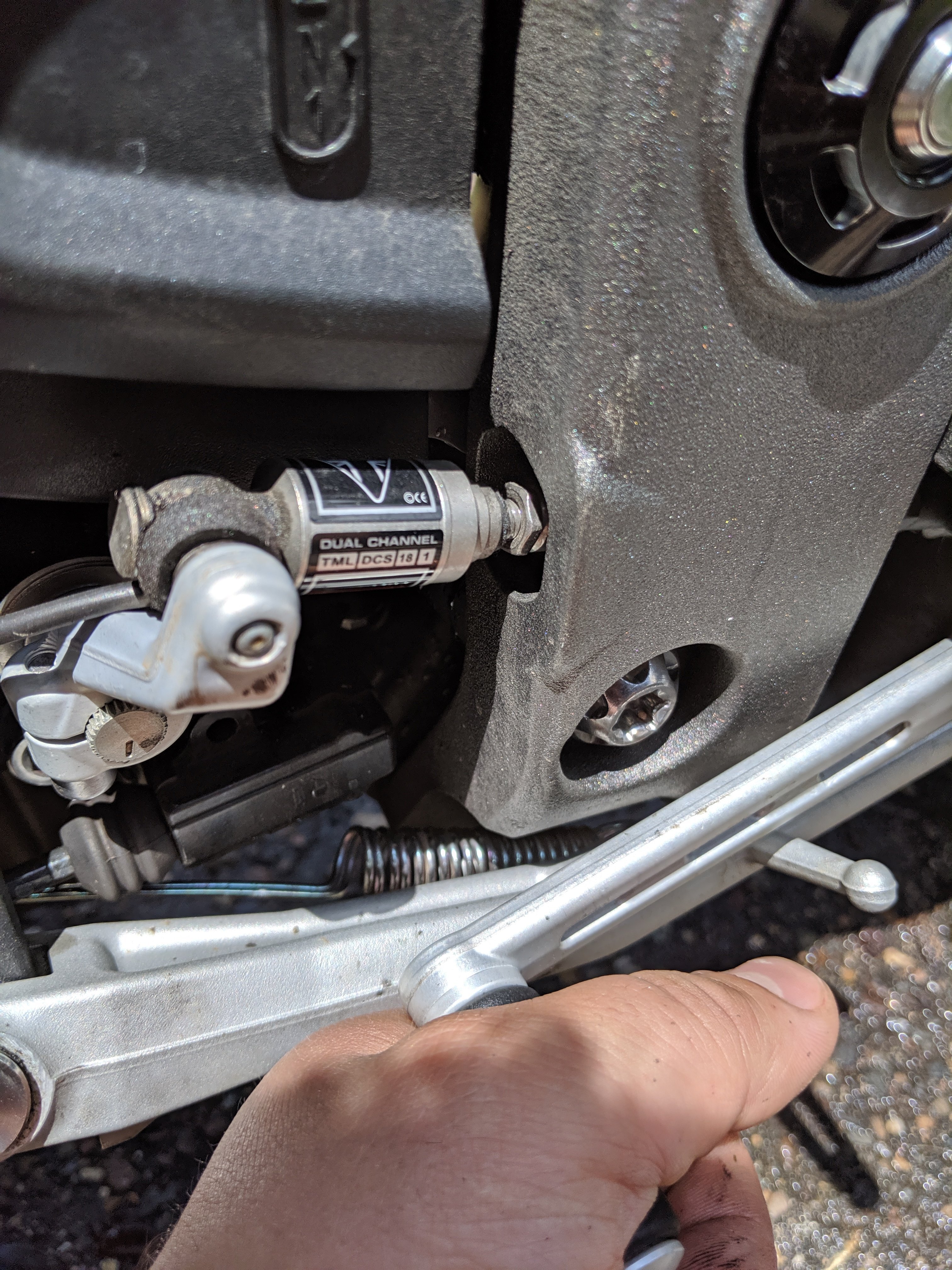

    Maybe I'm missing something but my 19 (purchased July 18) has at least half an inch of clearance before the quick shifter contacts anything. Maybe the usdm model is different somehow or I just got lucky.
  14. SteveRS
    SteveRS First Class Member
    Jan 12, 2019
    862
    British Columbia
    Pull the shift lever all the way up until it stops and see if there is any gap between the quickshifter and the arm. Look closely enough and you may also see a spot where the quickshifter has contacted the arm. Unfortunately it doesn’t seem to matter if the quickshifter is contacting the arm, as it can still malfunction that I have found out. If yours shifts under extreme loads meaning high rpm’s and it works fine, then you may be one of the lucky ones with a good quickshifter.
  15. Screechers
    Screechers Member
    Feb 18, 2019
    21
    Minnesota
    I see what you're talking about now. I haven't had any issues with 10k shifts so fingers crossed I got lucky
