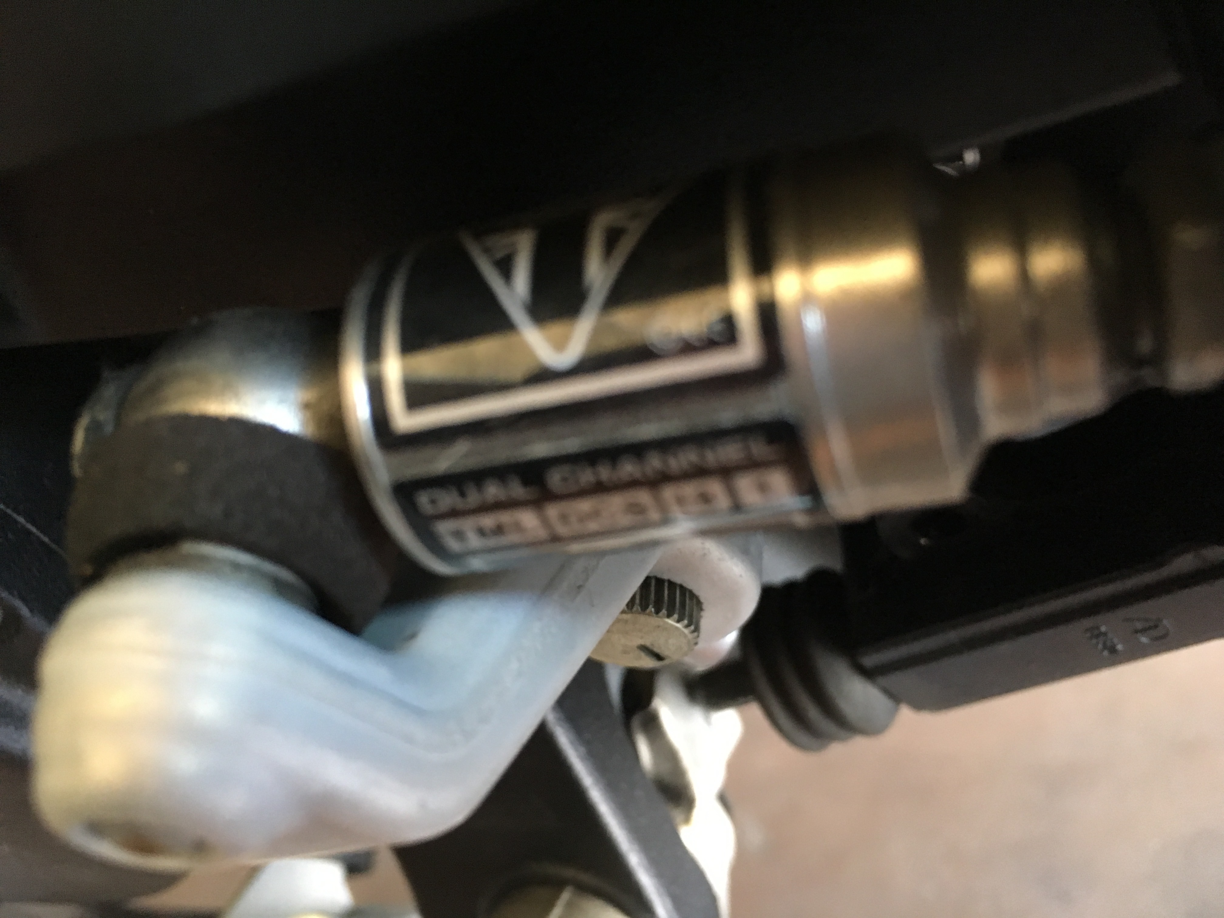

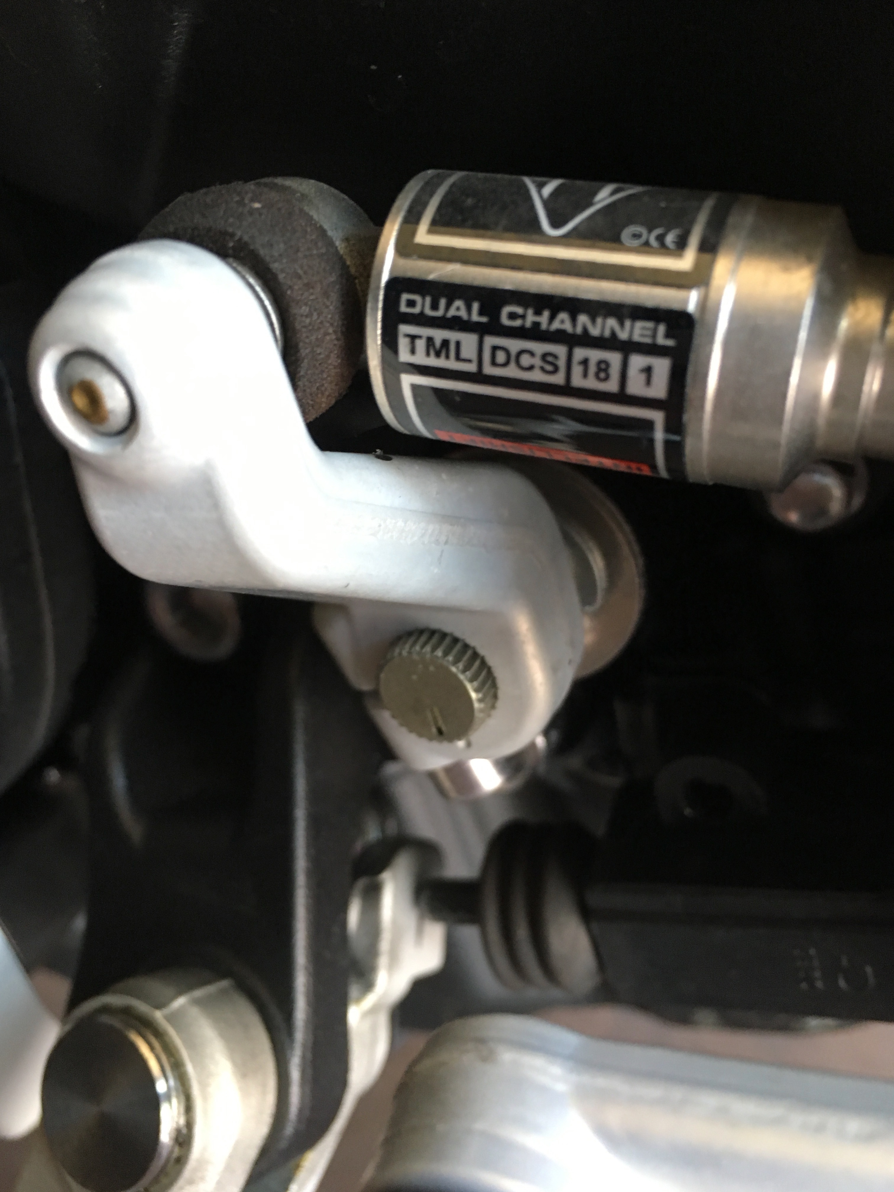

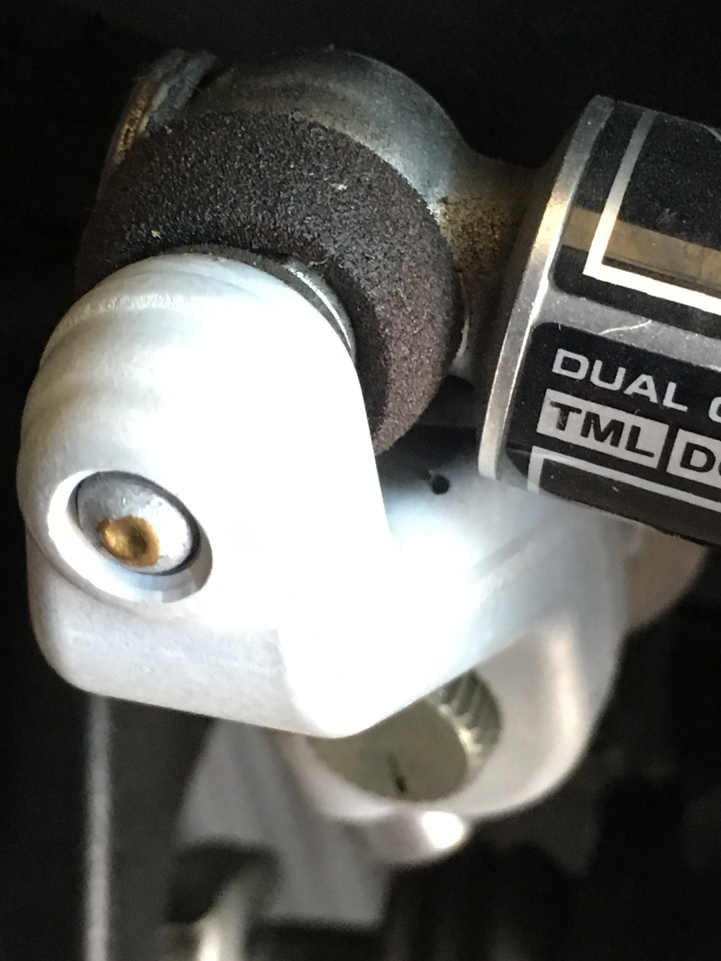

    It's not that big of an oversight, it's a tolerancing issue.
    The arm that the shifter contacts is cast, most casting surfaces have a standard of +/- 1mm, unless otherwise specified (certainly in the motorsport industry)
    The machining work is then carried out on top of this, so the tolerance between two important features, such as the spline and thread in this case, will be spot on, normally +/- 0.1mm for this sort of thing.
    This means that the surface we are having issues with could be anything upto 2.2mm closer or further away than the previous one, and still be a perfectly acceptable part.
    The way around this, is to 'check machine' the area in which you have a known issue. This would remove any potential problem material. Its safe to say that triumph have not been doing this.
    I suspect as triumph haven't had an issue in the past, and it's perfectly reasonable to assume that the first 100-500 shift arms were all made in the same batch, and were all lucky in that they were mid limit or negative material.
    Also, the length of the shift rod, unless drastically different, won't make a blind bit of difference, I have carried out testing which proves this on a number of occasions.
    As I have said, issues like this are my day job, I work with transmission systems on a daily basis which alone cost more than this bike. I promise I would never recommend anything which would damage anyones bike.

    Burny-13, thanks for the photo with the red circle created by the advanced software and data analysis tools. :grinning: It was most helpful as have been your other posts.

    Sandi, if these are your photos then I would recommend you disengage the shift assist until a new arm is installed. It’s not worth the risk of destroying your gearbox.

    Thanks for checking out the photos I posted and for your feedback and recommendation, Steve. Yep, that's what I was afraid of. I'll disengage the shift assist today and I'll also be calling my dealership pronto. I'm hoping that folks respond to jeznewsome's post and provide an actual part number. Do you know it, by any chance? And, most importantly, how is your bike after the new arm install?! Hope you're getting out on the road on that bad boy. :cool:
