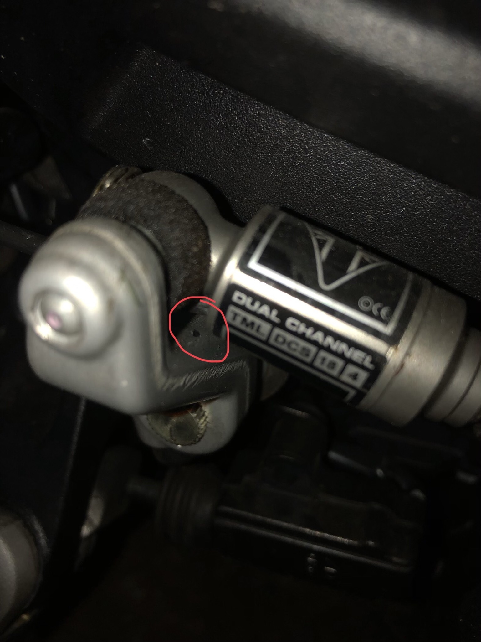

    Right, it was bugging me so I dragged my arse out of bed and had a look at this physically.
    Looks as though the body of the load cell contacts the shifting arm, this causes two issues, which will cause shifting issues.
    1. restricts the motion of the gear change.
    2. affects the load reading of the cell and therefore the engine cut.
    Also. damages my precious!!!
    Looking at it, the obvious solution is to move the load cell further away, but we cant do this as the ball joint is fixed to the load cell (or appears to be)
    You could fettle the arm, but this would weaken it.
    You could turn the whole thing round so that the load cell is at the pedal end rather than the gearbox end, but this may have clearance issues of its own. (it wont affect the function what-so-ever)
    So, in my very quick opinion, this updated arm which triumph have fitted to a few of your bikes may in fact be the fix. I will be asking my local dealer for one ASAP for sure.
    Now, this restriction will only affect shifts in harsh circumstances as these are the cases where full motion and force are required. Low load shifts don't require as much movement or force because the detent on the barrel is usually strong enough to complete a shift in this situation, your foot is only required to 'get things moving' so to speak, the mechanicals do the rest.
    If you look at the images I have attached you can see the marking, and contacting of these parts.

    Hi Sandi, I must say I really enjoy the humour in your posts :). Have a look at these photos, I don’t recall the member who posted them but you can see where the contact point is and where you need to look on your bike. See the difference in clearance with the new arm. That’s the same arm I now have. But I’m still to chicken to try the shift assist though :worried:.

    Using the most advanced software and data analysis tools available to my iPhone,
    I have circled the small mark where the load cell contacts the shift arm for you Sandi.
    Steve. I have just noticed the cut out in your second photo. Is this the “updated arm” you have mentioned? Or something that the dealer did themselves?

    Here's a pic of mine, you can see the witness mark there as well.

    Its an updated part from the triumph factory.
    The picture used is my bike matey.
