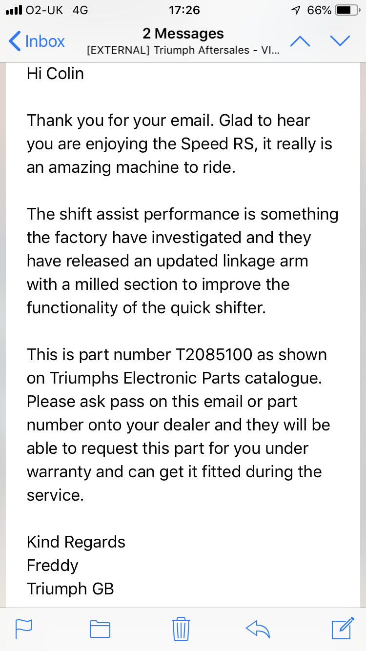

  1. White-Vador
    White-Vador Well-Known Member
    Apr 11, 2019
    77
    South of France
    Thank you for the email and again for your great work, Chris !!!!

    Mar 18, 2019
    32
    Sweden
    I just got this part changed here in Sweden. Even changed the feel up upshifting with the clutch. Now there is no resistance..
  4. IlaOblomow
    IlaOblomow New Member
    Aug 12, 2019
    11
    Berlin
    The feel changed dramatically also for me. So it was an issue.
  5. Sandi T
    23,311
    Just an update on my 2019 RS. My new linkage was installed on 6/29/19 and on that date my bike had 1,942 miles on it. My bike now has 2,437 miles on it so I've had the new linkage for 500 miles. I'm happy to report that my QS is working beautifully with nary a hiccup. Considering all that many on this forum and this thread in particular have gone through, I consider myself lucky and blessed that my QS is happy.

  7. Sandi T
    23,311
    Hi, Steve. Thanks! Yes, I'm so glad my quick shifter is working like a charm. I didn't have the sorts of problems you've unfortunately dealt with but prior to changing out the arm my shifts weren't as clean and crisp as they are now. Plus I am feeling way more confident of the integrity of my QS after the change so that's worth a lot too. Glad you are loving your Speedy even without the quick shifter. I'm so happy I decided to trade my Thruxton R for my Speed Triple. Loved my Thrux but I am IN LOVE with my Speedy! :)
