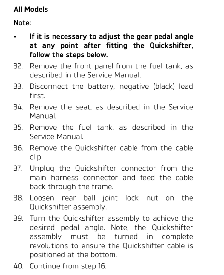

    Sounds like it more than likely resolved for you. Thank Christ. Yeah I did the same with the lever. Unfortunately the only way to adjust the lever is by pulling it off the output shaft and moving it one tooth, but I found it a little too low. So for me it’s a little too high or a little too low, can’t get it right. When I remove it and have just the rod, I’ll be able to dial it in.
  6. Burny_13
    Burny_13 Active Member
    Jun 16, 2019
    67
    Reading
    This is incorrect and may cause more problems (due to loading angles) and may explain why you continued to have failed shifts.
    You can adjust the quick shifter rod length in the EXACT same way as the standard rod.
    The only difference being that it’s awkward to get to. But other than that it’s the same.
  7. Rspete

    THAT IS INCORRECT! When you have a quickshifter the rod length has to be an EXACT length, or you will have problems. So that means NO adjustment with the rod length. I was told by my dealer that I could remove the linkage arm and rotate it on the output shaft by a tooth in either direction. Now this is not the best idea either, probably for the reason you mentioned. When I tried that I had already stopped using the quickshifter and was trying to get a better lever position. I rode it for about a half an hour and put it back to the original position, as that position wasn’t great either. With the second gearbox, new quickshifter and revised linkage arm, the arm was always in the original position and I still had the false neutrals. When I get the new rod without a quickshifter, that’s when I said I’ll be able to dial it in.

    Hmmmm ..... I assumed that Triumph only had the very specific rod length when there was no scallop out of the gearbox arm (to try and ensure that the fouling that was happening wasn't!)
    I have therefore adjusted the rod to ensure that it works for me

    I know Triumph recommend it but does anyone know specifically why it needs to be a certain length?

    Not sure what give you that idea, have any of you read the fitting instructions?
    https://www.triumphinstructions.com/ProdDocs/A9930428-EN.pdf

    So it isn't a fixed length.
