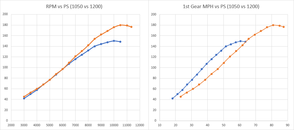

    In the Owner's Manual available freely on Triumph's website. Use primary ratio 1.572 instead of what's in the manual (1.85), to approx match what we've actually seen in Speed Triple 1200 videos.
    Then, use GearingCommander, and pull up the latest Speed Triple, but note that you have to manually change the 2018 sprockets to 17/44 as it defaults to 18/43. And then open a second window, and punch in the new numbers, and compare at 10000 rpms for both.
    All of this puts the Speed 1200 at 76.5 at 10K and the Speed 1050 at 60.6, so 76.5/60.6 is 26.2% taller 1st gear. I checked TMF's 1050 video, and this seems in the ballpark.
    Under 7K the power is very similar (1050 vs 1200) per Triumph's chart, so ... I don't see how a 26% gearing change is anything other than slower / more sedate in 1st gear under 7K rpms. Maybe I'm overlooking something obvious. Here's the data roughly grabbed from Triumph's chart, and then adjusted for gearing.
    What am I missing. That's a 30 hp deficit at 40 mph. Was the 1050 electronically limited in 1st? It's the same story 2nd through 6th gear, the 1050 matches or exceeds under 1200's 7K. I must be off by a metric mile somewhere.

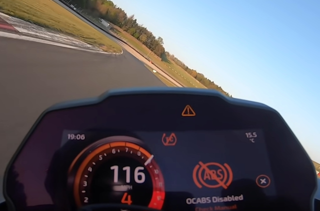

    Edit: video proof for 1200, 4th gear 9K 116.0 mph gives 6th gear 11.4K 174.6 mph
