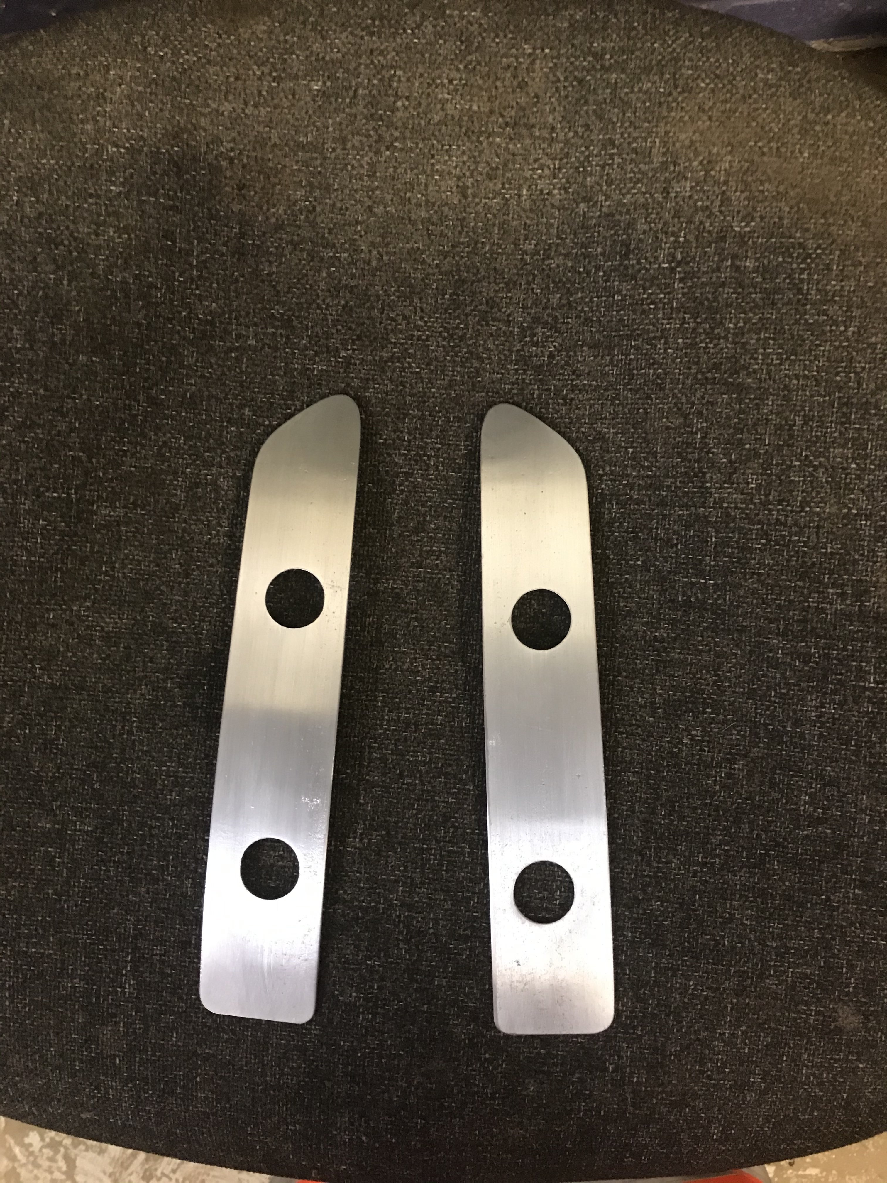

    Bit stuck at the moment :confused:
    Need to be in the garage with CERBERUS :cool: so I can offer these up and see about getting them mounted with the bobbins that I’m making :)
    Unusually for me I’m taking my time as I have to get this first part right as everything else that I’m gonna make is dependent on this first part :) 6495DFCA-3210-41E6-A1CE-131450F87124.jpeg

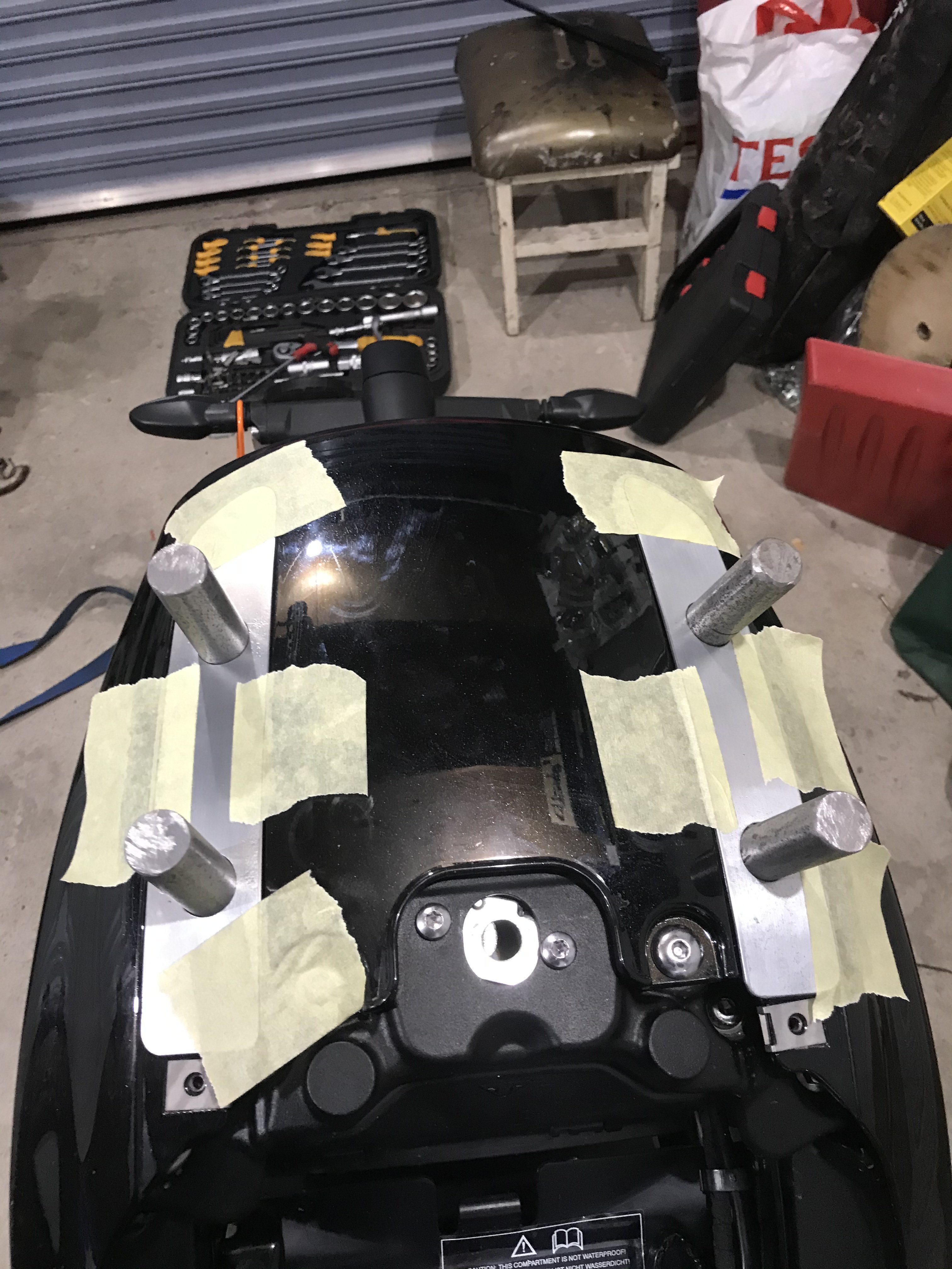

  3. dilligaf
    :confused:Lot’s of cutting and filing to do yet :confused:
    Then I plan to glue them in place at the top somehow :confused:
    I should be able to tack weld them into position underneath then remove the glue :)
    I also have to drill and tap some threads through the four bobbins as well :) 8562F1C0-1167-4227-B15C-9D9BD20D9609.jpeg
    • Like Like x 13
  4. dilligaf
    That’s them all cut and filed to the same size :)
    Gotta drill and tap them next :confused: EA0437DE-8366-482C-B246-6E698C08B16A.jpeg

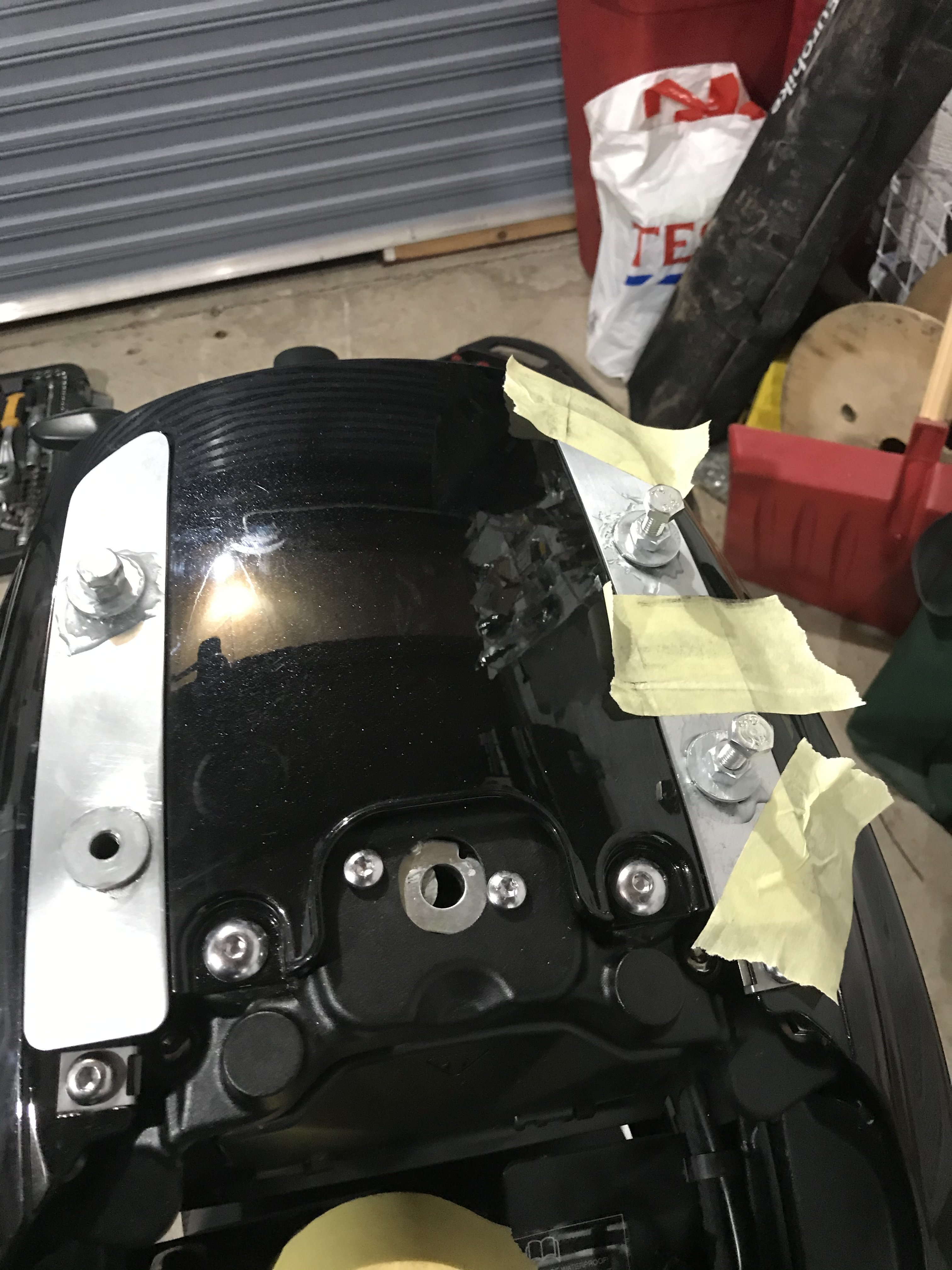

  17. dilligaf
    I have a confession o_O
    Them bobbin things I was making got fecked up on Friday :sob:
    Wasn’t my fault though :confused:
    The pedestal drill I was using had a wonky base :(
    As I was drilling the bobbins the hole out the bottom end was completely out :sob:
    They were hot to touch so I was just chucking them to one side without checking :scream:
    All four fecked :mad:
    So I’ve had to start again :sob:
    The good news is that the glue holds them in place while I get them welded from behind :)
    You can see the first one in the picture without the bolt holding it down :)
    Three to go :) 22E9DA8D-6859-4C1E-A476-2D64B98DCBBE.jpeg
