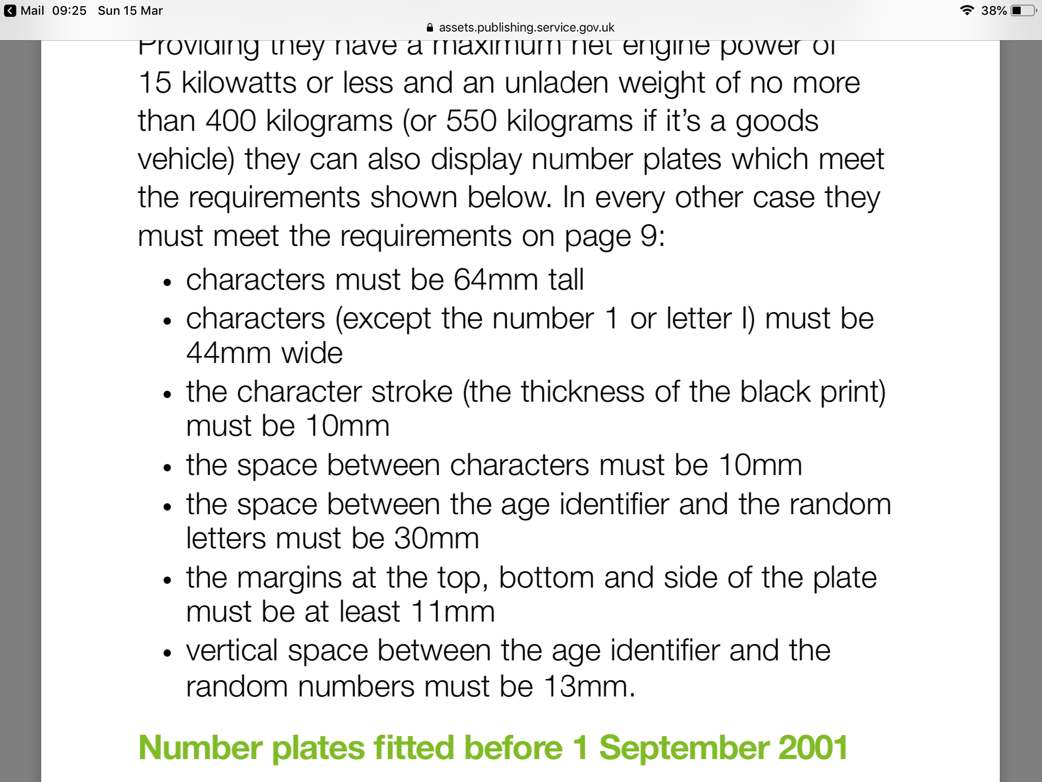

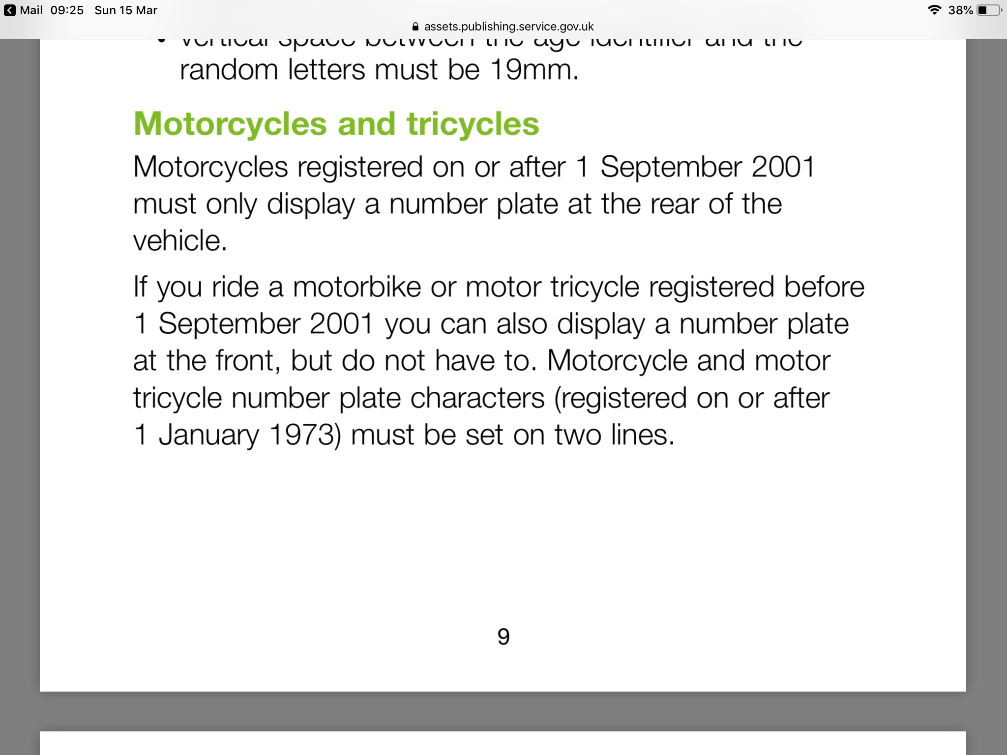

    Unless there has been a very very recent change in the law, there is no law that dictates the 9 x 6.5 overall size that you mention for bike plates. My bikes are newer so will not need an MOT for another 30 months so I will have to see what happens then!
    The laws as I understand them dictate the height and thickness of the digits, the spacing between them and the rows, and the size of margins around the digits to the edge of the plate. This is why plates with 5 or 6 digits can be legally smaller than those with a full 7 digit plate.
    I have a JDM plate for my 5 digit registration and it is legal, I have compared it to the original Triumph fitted plate and the digits are same height, thickness and spacing yet it is much much smaller because it has reduced the margins (expanse of yellow background) to the minimum legal size.
    The Gov.uk website currently has a link to an informative leaflet INF 104 from DVLA about number plates - which details all the legal requirements. Screenshots attached.
    There are different rules for older bikes/plates , I haven’t read all of those, just the section for bikes registered post Sept 2001. Ps Sorry the screen shots have attached in a non logical way!

    ive found the plates dealers fit to new bikes a quiet a bit bigger than the 9 x 6.5 legal plate so you may be ok.

    it was only at last Xmas that I bought my new scrambler and I started looking into a smaller plate, my local auto spares told me it was 9x6.5 plus you need to take your log book with you, it was last summer that when getting a price for some new tyres that I asked for guidance on my 8x6 plate on my street triple whether or not it was legal,it wasn’t. I know in 2014 small plates on bikes were receiving a £60 fine as I’ve seen it happen to a mates bike.i am Not saying you shouldn’t put one on but maybe check with we’re you get your bike mot.

    I am sure this isn’t the first forum discussion on this matter, it clearly shows that there are differing views, interpretations, understandings and actual experiences out there about bike plates amongst riders and also officials.
    This is no doubt because there is no simple straightforward answer to the question what size is a legal bike plate?
    As a retired cop who has done some research I am happy that the JDM plates are legal and I am more than happy to discuss this with any MOT tester or cop who has a differing view in due course. (nb it could all go pear shaped then!)
    As I see it bike dealers and some plate suppliers simply use standard plate making machines and plate sizes provided in bulk by their suppliers but JDM have done their homework and trimmed down the sizes to the minimum for plates with different numbers of digits. It’s almost a bespoke service. Yes it’s costly, but think of the fuel I am saving with reduced wind resistance!
