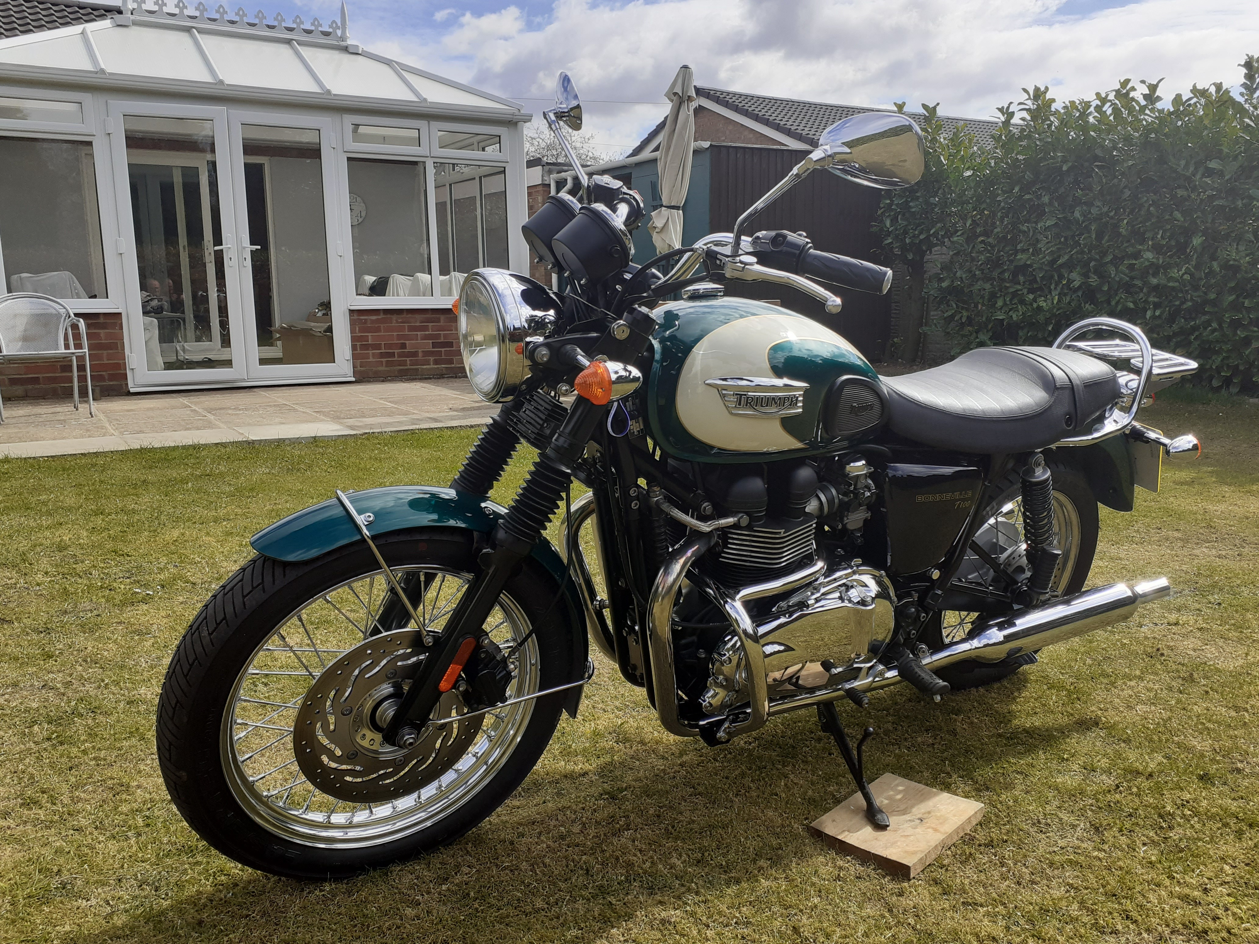

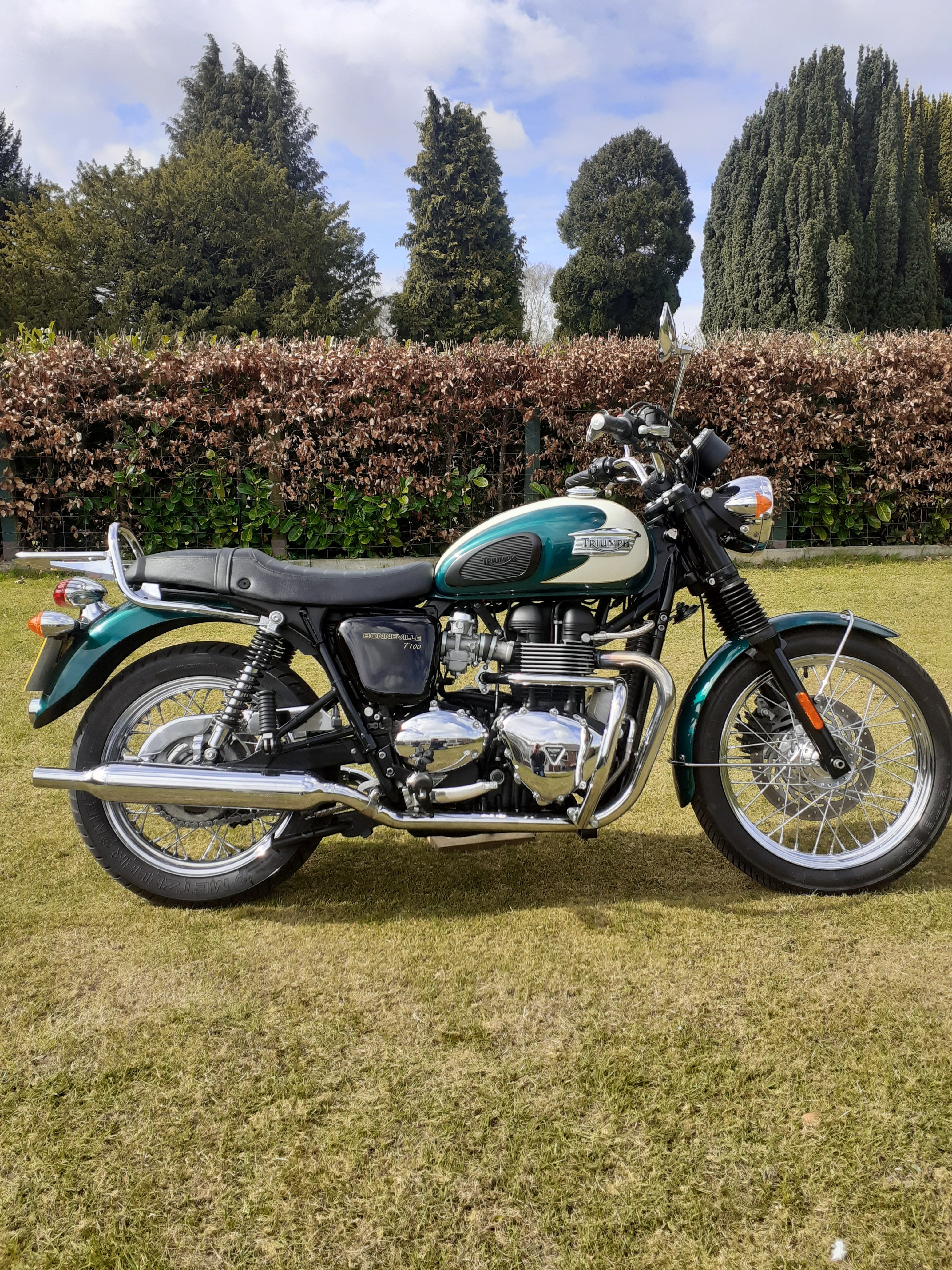

    Put a few pics of your iron horse up here Malcolm for us to see
  19. Malcolm Woods
    Malcolm Woods Noble Member
    Sep 16, 2019
    331
    313
    norfolk
  20. Rudeboy
    Rudeboy Senior Member
    May 2, 2017
    402
    Bristol
    Ooh thats pretty love the colour and the seat/rack combo are those engine casings chrome coated type or highly polished as i cant get mine nowhere like it but they are brush alloy :grinning:
