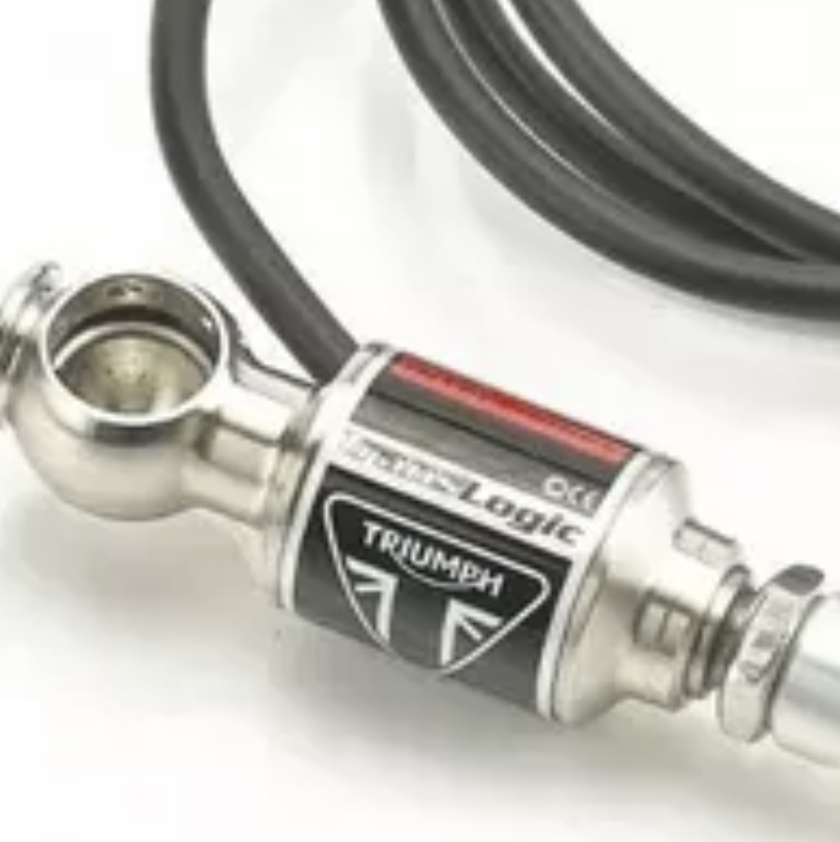

    The shift sensor looks like the Translogic one.
  15. Bryan3R
    Bryan3R Senior Member
    Jun 22, 2018
    229
    293
    Southend, Essex, England
    Confirms it.
