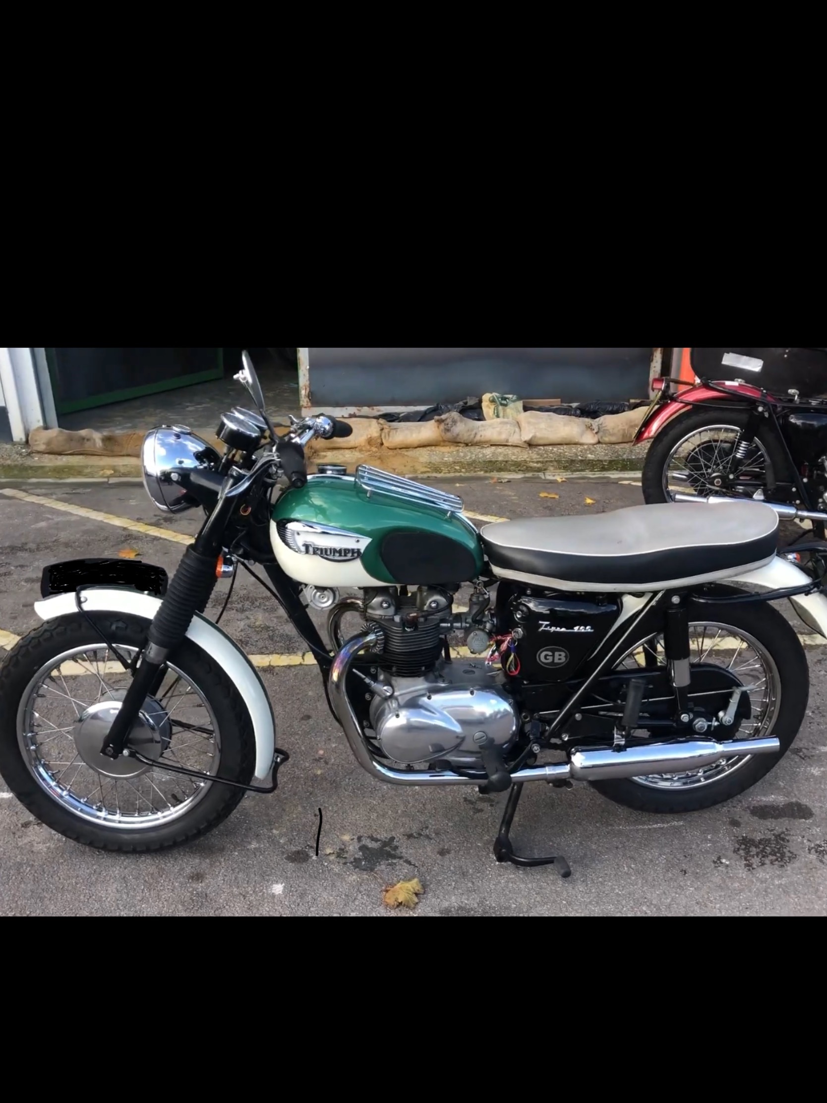

    Just sticking this picture of someone else’s ‘66 T100ss to remind myself what it’s supposed to look like if it ever gets finished.

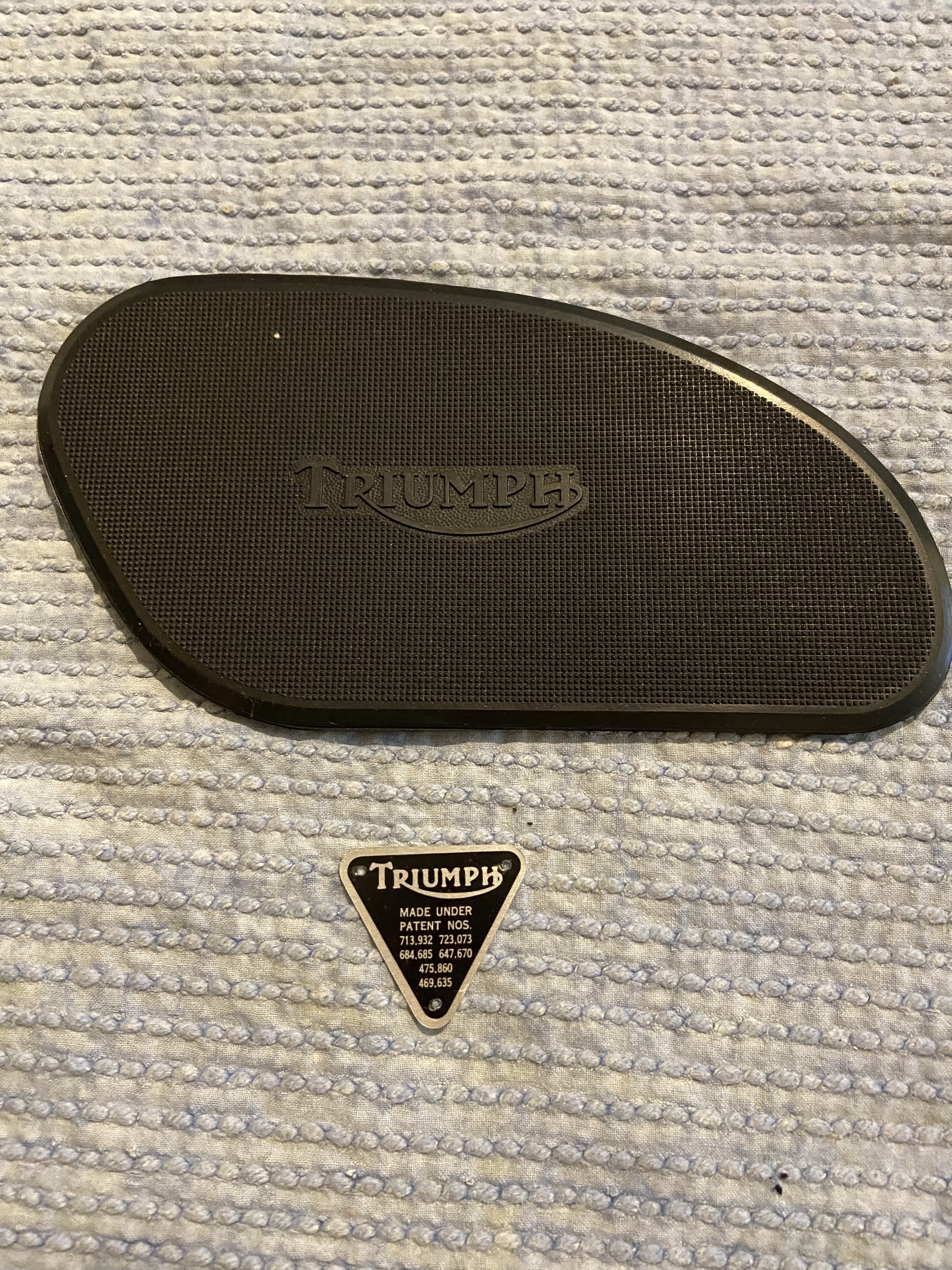

    Another bit needing replacement is the Patent Plate on the engine timing cover. The old one is just an ally triangle. All semblance of lettering has long since been polished off. New plates with various scripts are available, some with legends that were never seen on any Triumph. With the help of Monty’s Classic Motorcycles I’ve been able to get hold of one with, I think, the correct numbering.
    I’ve also obtained a pair of knee pads for the petrol tank from the same source. This was not quite so easy as there are several shaped pads but not necessarily the same shape as the advertising photos turns up once ordered. Old photos show that the T100ss uses pads where the upper curve follows the indented shape on the tank. This needs to be right otherwise the paint line, tank line and pad line look a bit of a mess if they aren’t concentric. So far I’ve got a couple of pairs, the latest is the right shape but seems to be too big for the tank. That might need a bit more work.

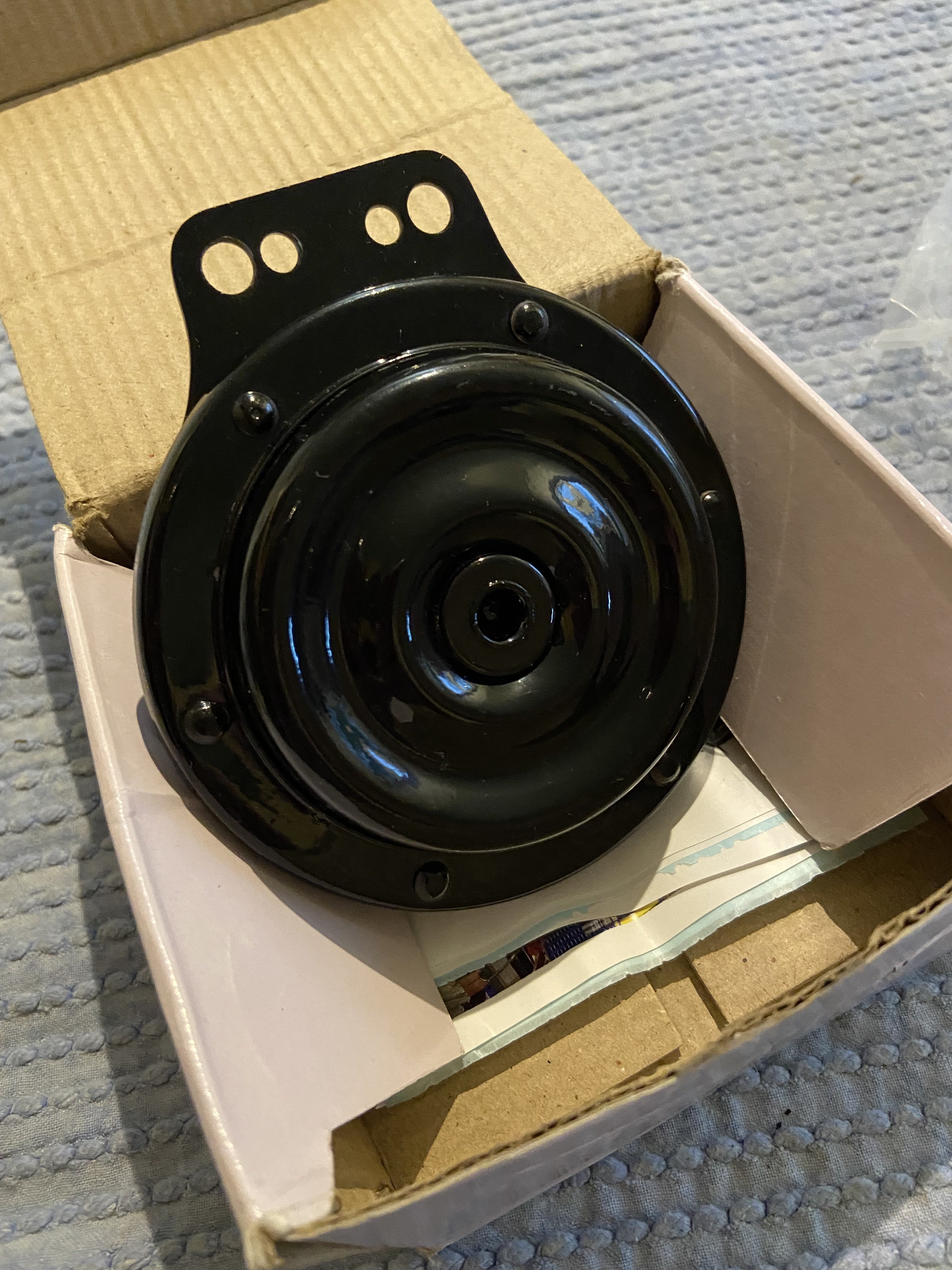

    The horn. Nothing like that in the pile at all. 1966 was the arrival year of 12 volt systems superseding the old 6 volt one. My parts list specifies a Horn Lucas type 8H. There’s all sorts of horns on sale varying in price from about £10 up to £120. A ‘near enough’ 8H replica was able to be obtained about mid way in that price range.

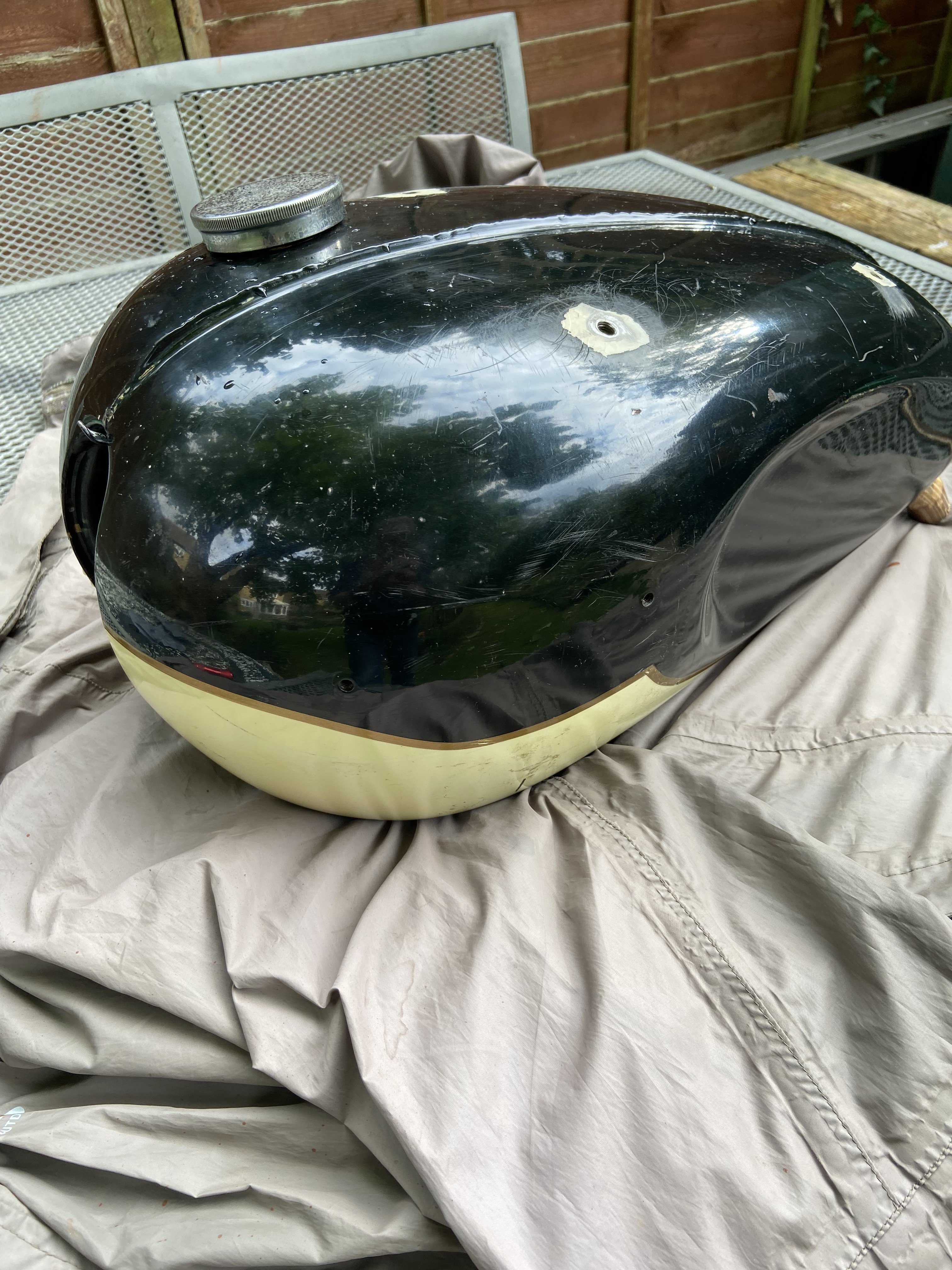

    I cleaned out the T100’s fuel tank a few months ago. The inside was fairly clean except for a few smallish patches of rust along the walls. I spent a week with vinegar and bits and pieces shaking the tank up and got to the point where the rust had sort of faded to what looked like just a dark stain. On reflection though I may have used the wrong vinegar I had diluted it down, possibly too much. Anyway, having started on the Bonnie tank, which was a whole different kettle of fish, and having got fairly good results so far, I thought to have another go at it.
    This time I’ve used White Vinegar, undiluted and with a dash of salt. So far that’s been cooking for a day. We’ll see how it goes this time.
    This time I’ve used White Vinegar, undiluted and with a dash of salt. So far that’s been cooking for a day. We’ll see how it goes.

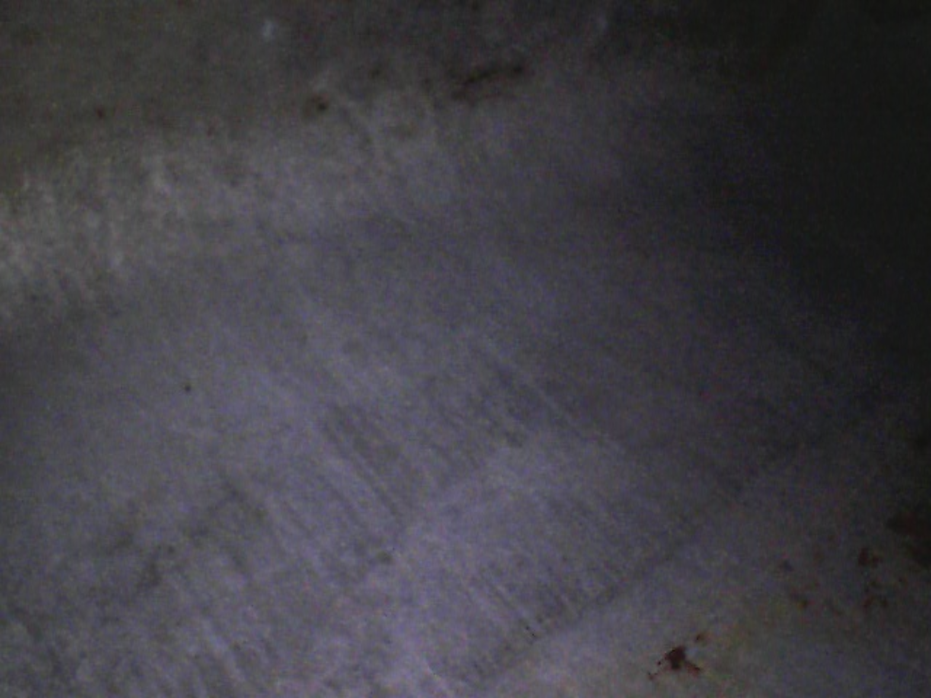

    After a week soaking and shaking the inside of the Tigers tank is, I think, about as good as it’s going to get. After soaking the uncovered portion of the tanks interior gets covered by a sort of scum that can be displaced by shaking. Finally I’ve washed it out and used the power washer jet as far as possible. Unfortunately I can’t get a direct shot at one side of the tank due to the offset filler opening and the internal hump.
    Anyway it’s clean metal for the most part and I sprayed the interior with a marine grade, anti corrosion fogging spray to hopefully keep the corrosion at bay.

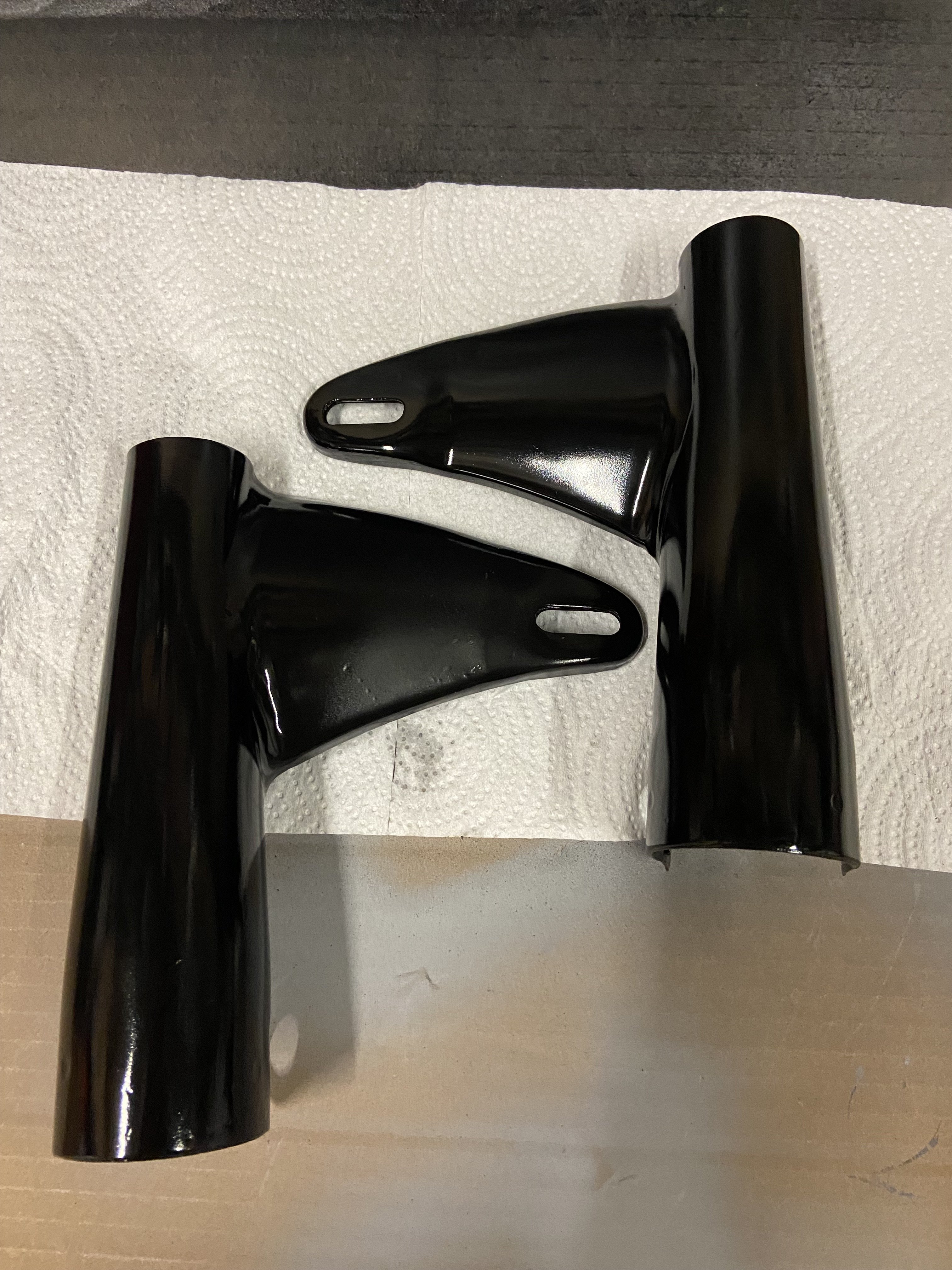

    Surrey. England
    I’ve repainted these front fork upper shrouds for the second time. I found that I’d managed to chip them while they’ve been waiting to be fitted to the legs. Rubbed down and painted again despite the adverse cold/wet weather. The lower legs which were also painted before seem to have survived storing without any mishaps so they’re going in as is.

    I can see staining being a problem but even if they were pristine I think I would struggle riding a machine so equipped. :scream:
