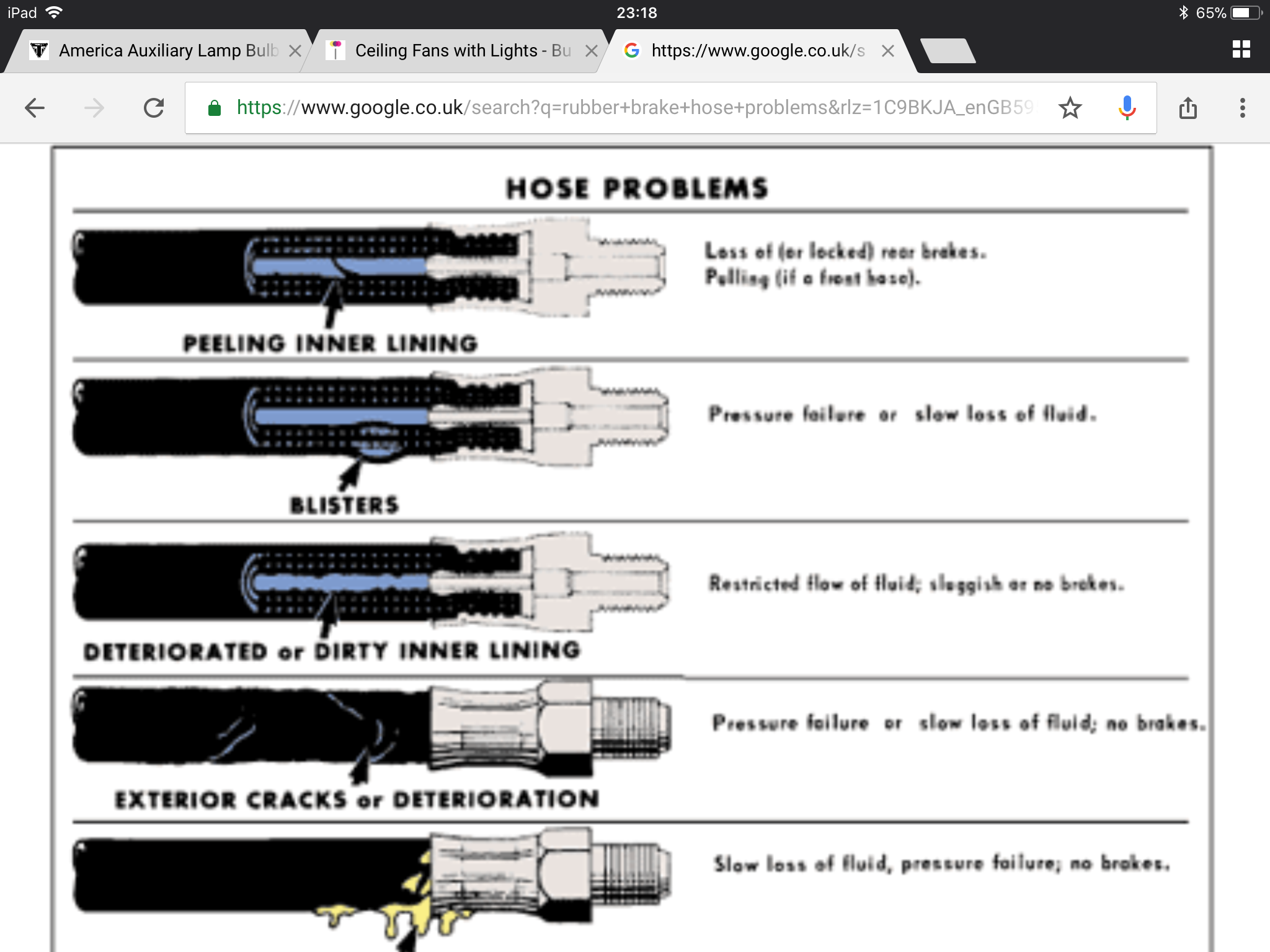

    It’s the inner lining of the hose that goes and like has been said it acts as a one way valve allowing fluid to flow towards the caliper but then preventing it from flowing back towards the master cylinder thus maintaining pressure and locking the brake on.
  2. Yorkshireman
    3,399
    01CEC746-01B4-4B6B-B9E8-ADBAD61D421E.png Here ya go the top picture explains it perfectly.

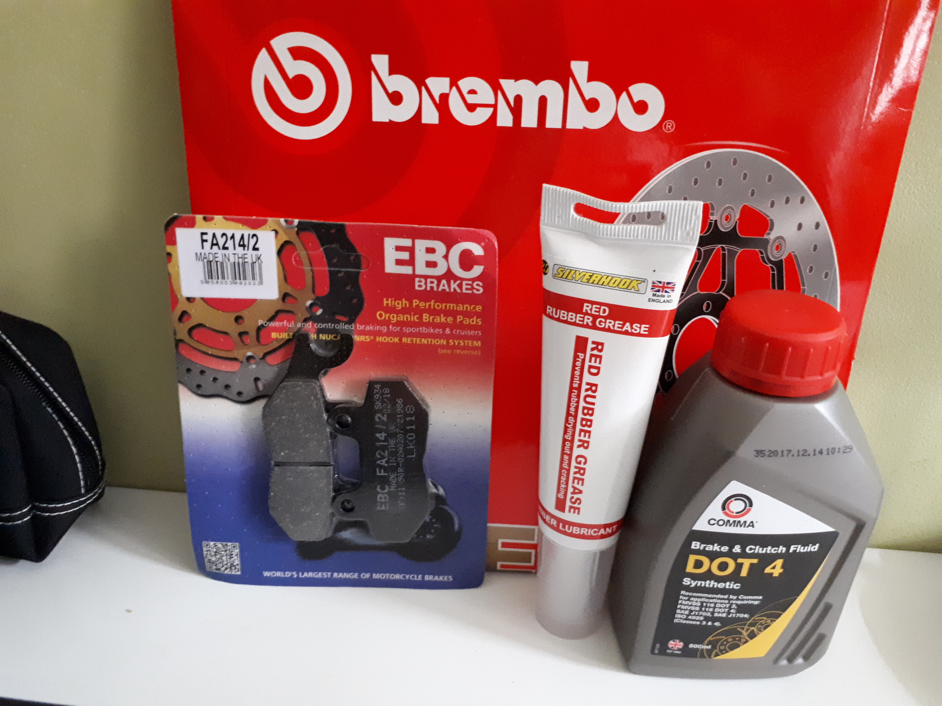

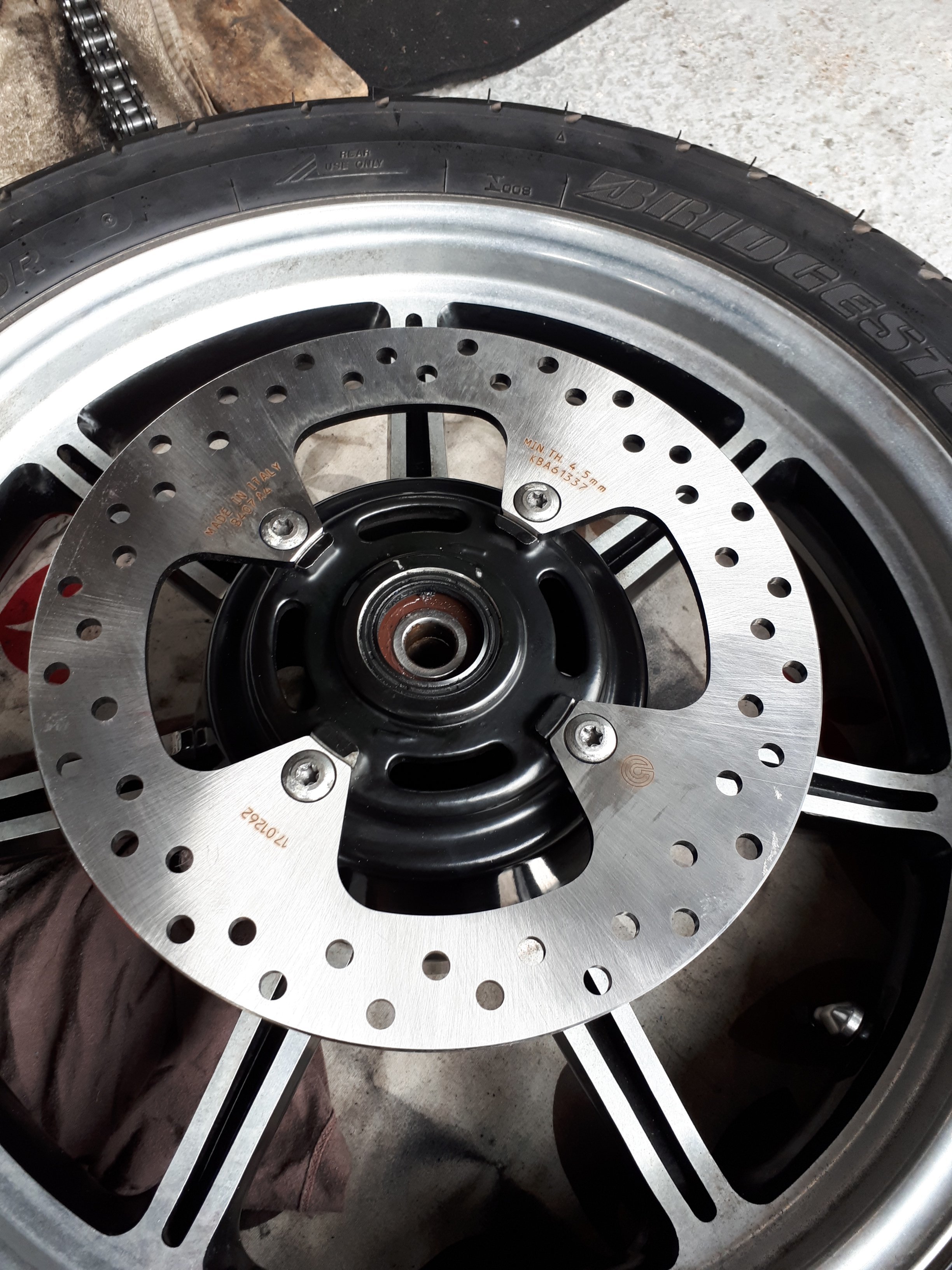

    Caliper is all nice and clean, the stuck retaining pin has been drilled out and the thread has been tapped just to clear the odd bit of reluctant swarf.

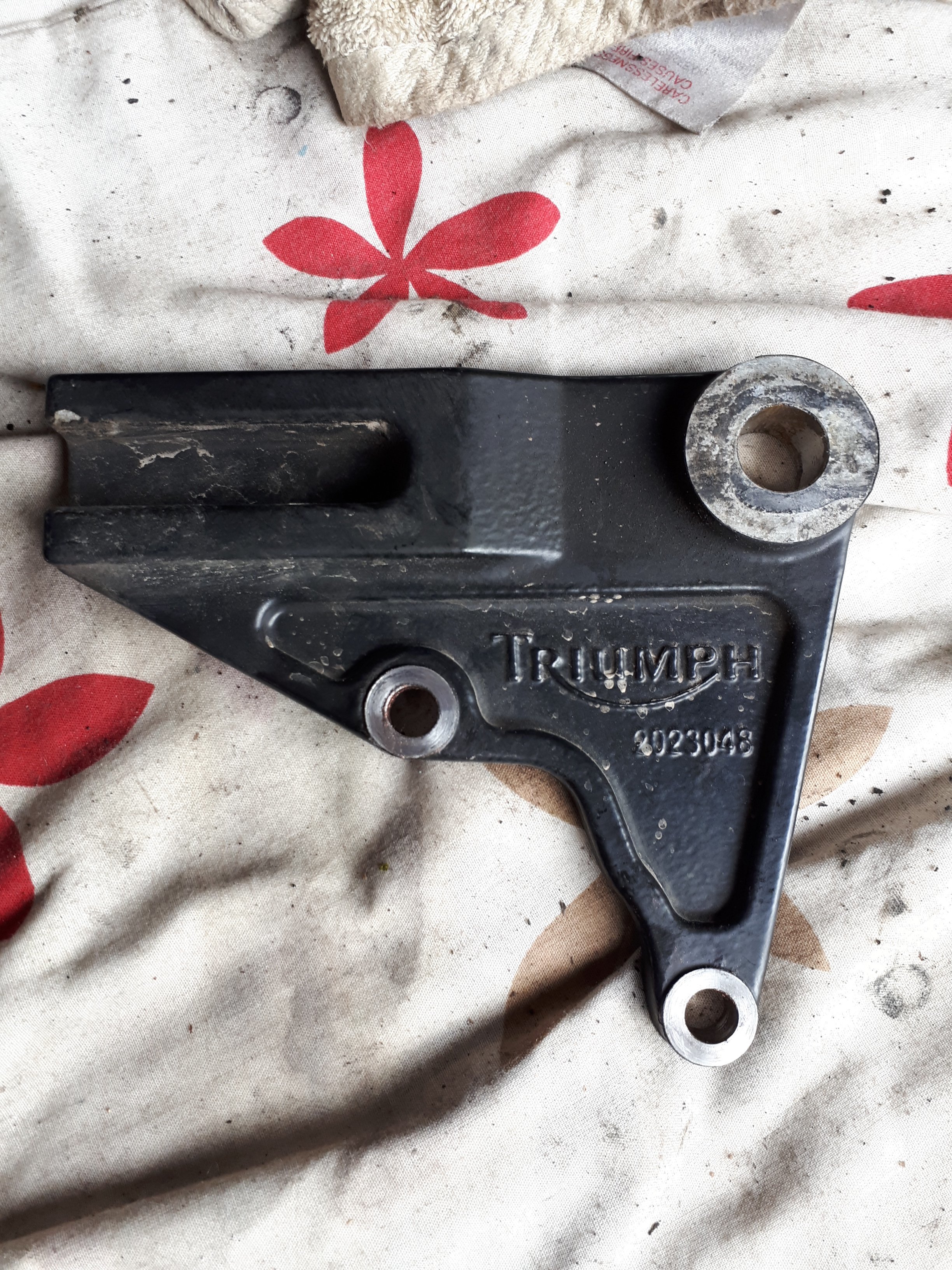

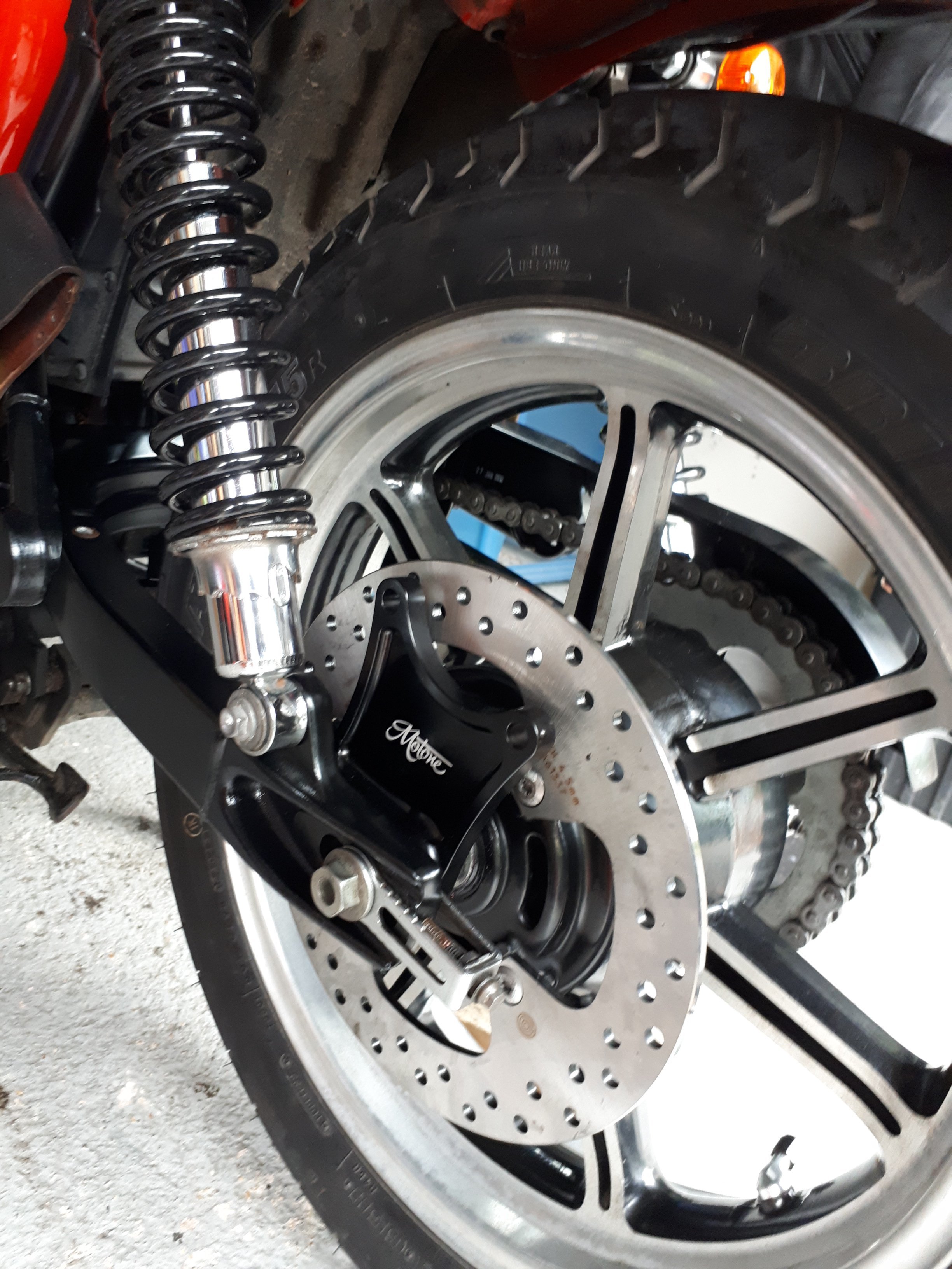

    New Brembo disc has arrived - just waiting for the new hose and pads, which should be in the post today. Decided to order the Motone caliper relocator bracket, as the wheel has to come off anyway, so that the caliper will stay cleaner in the future hopefully.

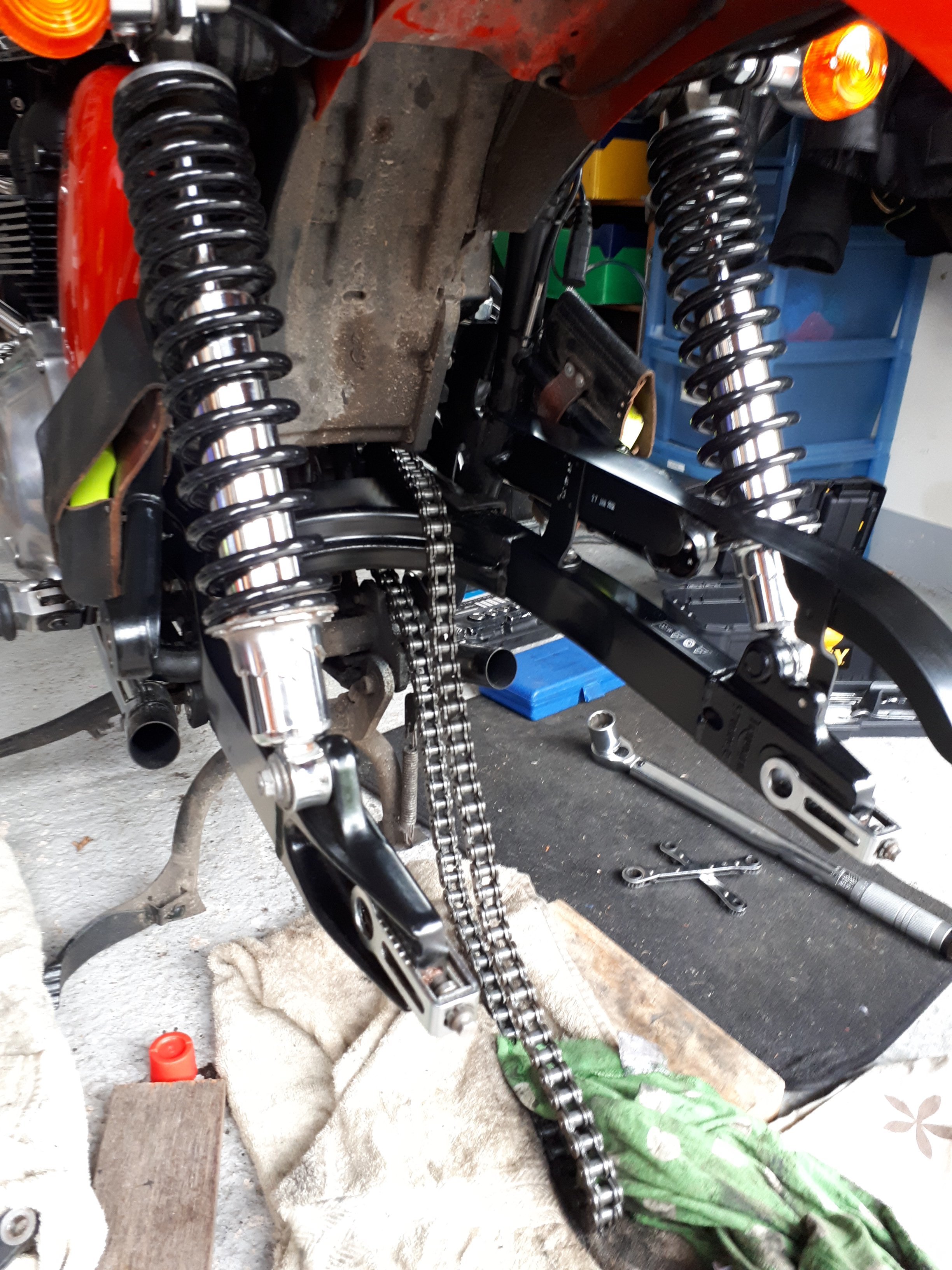

  18. steve lovatt
    9,228

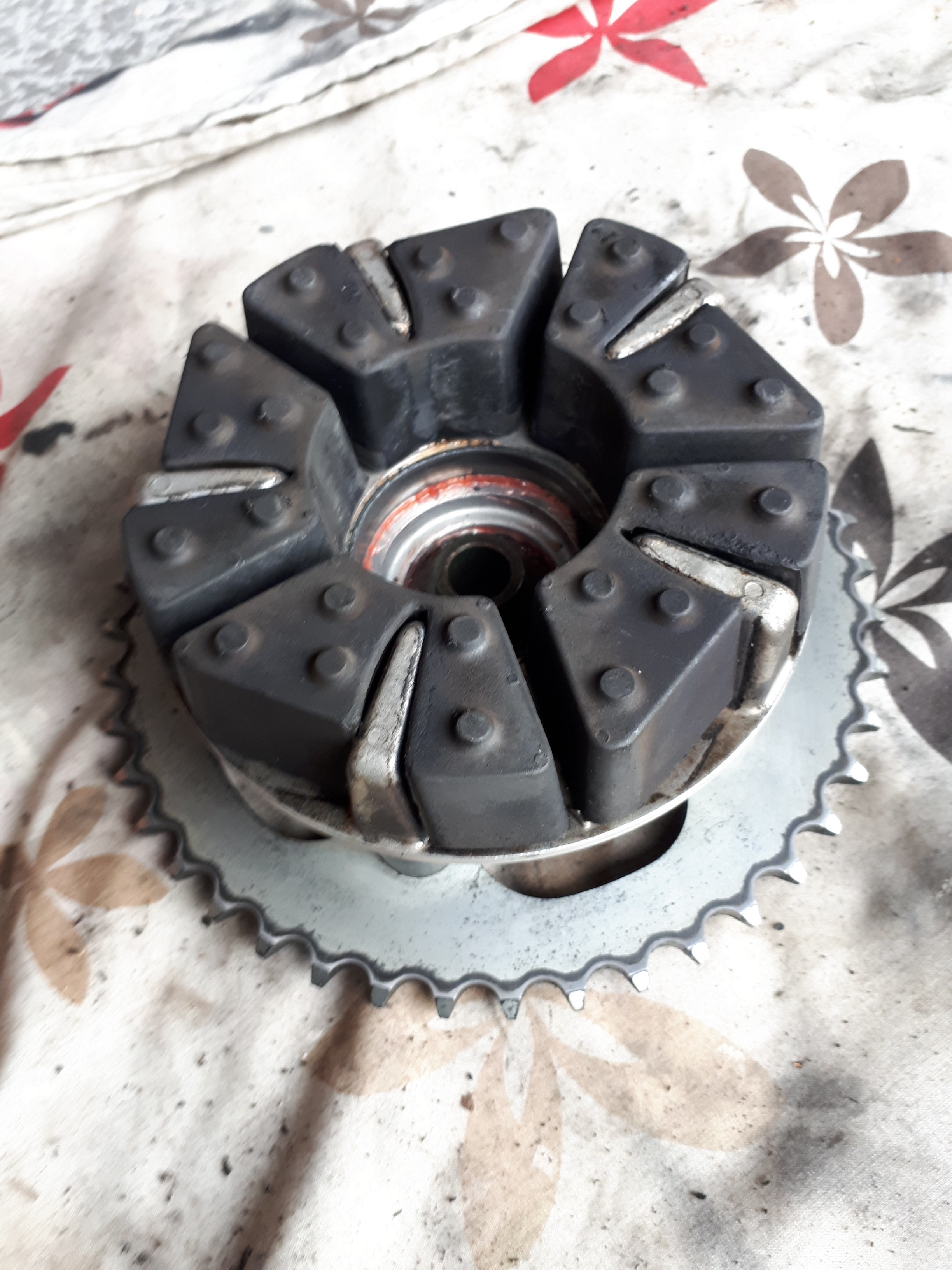

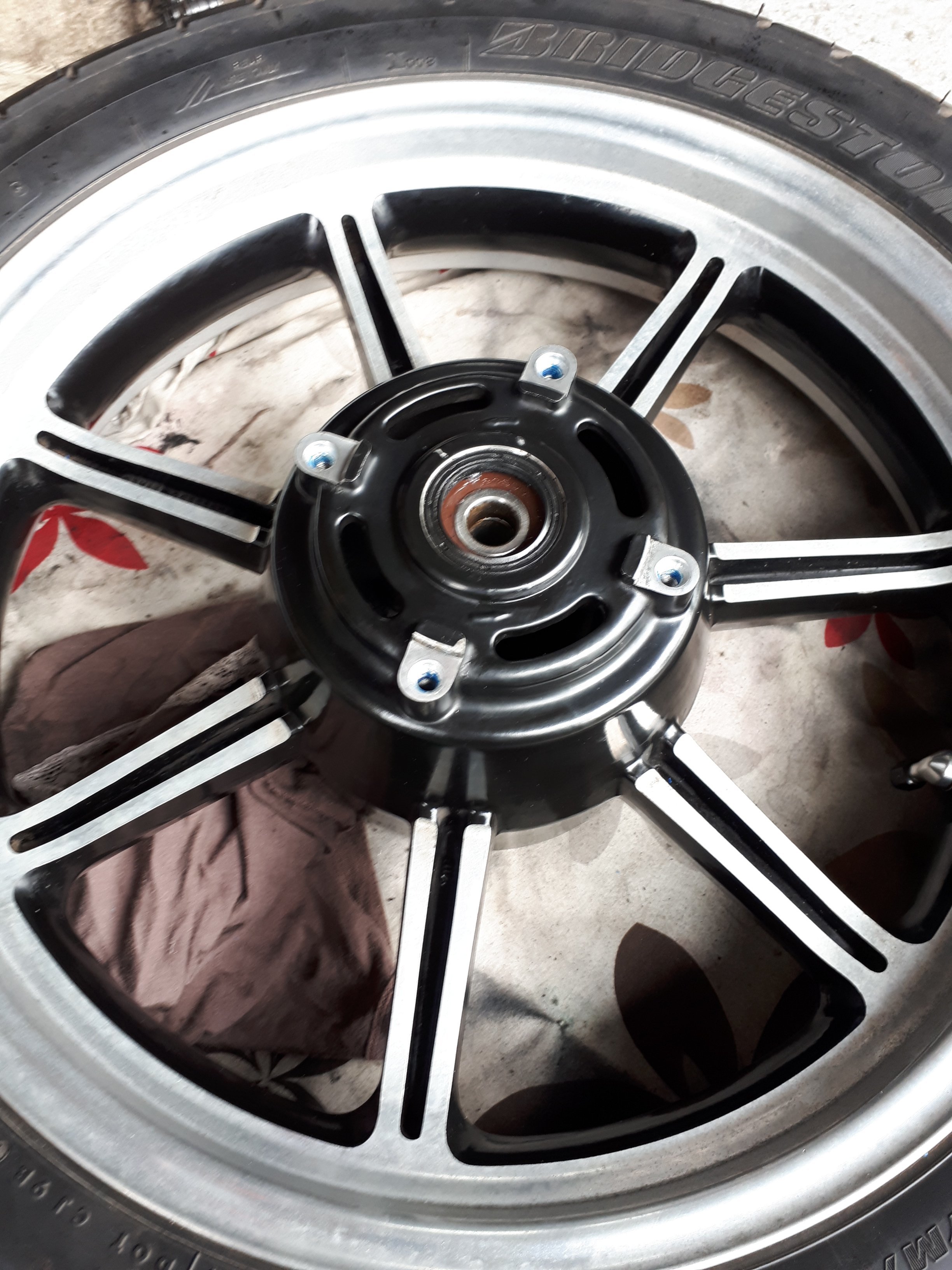

    Here we go.
    Wheel removed and cleaned, hubs regreased, chain and swing arm cleaned.
    Old bracket
    New bracket
    New things in the post!
    Old disc off
    20180511_162425.jpg New disc fitted
    Wheel back on.
    More later .... alcohol time now! :cool:

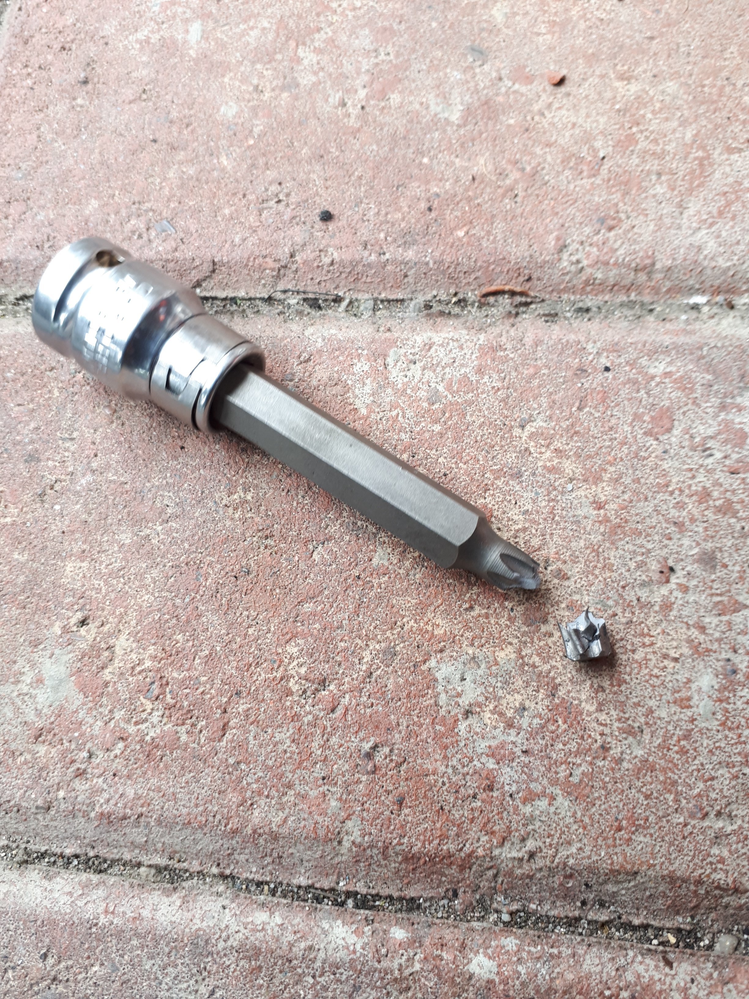

    Ps : don't buy cheap tools on Amazon!:mad:
