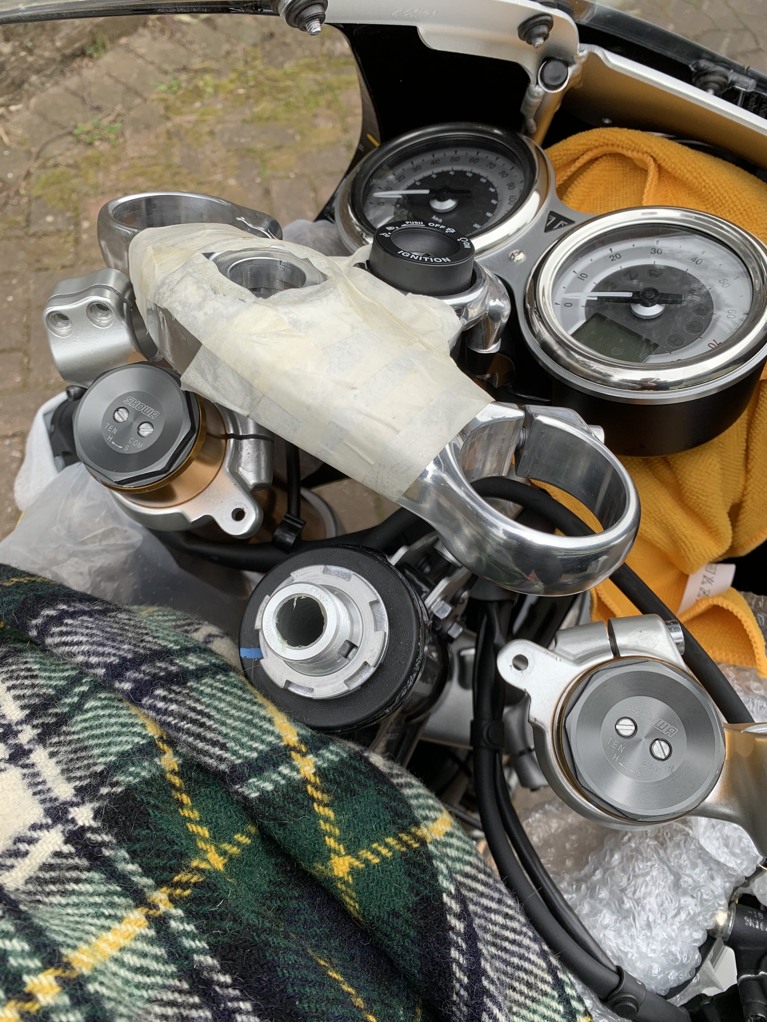

    My risers have arrived and I have borrowed a 38mm wrench. I can see the circlips but I’m unsure how to remove the bars. Does the circlip need to be removed before the bars will slide out? If so, do the bars need to be pushed toward the centre to access the circlip?
    Any suggestions before I start making a mess of things would be most welcome.
    Cooky
  3. andyc1
    Feb 4, 2017
    2,927
    N. Ireland
    You are 100 % correct!
    Go here,
    https://www.triumphinstructions.com/default.aspx
    And enter this number in the search box,
    A9638108
    You'll find the official instructions, they include the fairing kit but the risers are in there too, don't worry about any mention of the brake fluid reservoir bracket or speedo bracket, I've had high and low risers on with both the brackets and it works fine in any configuration.

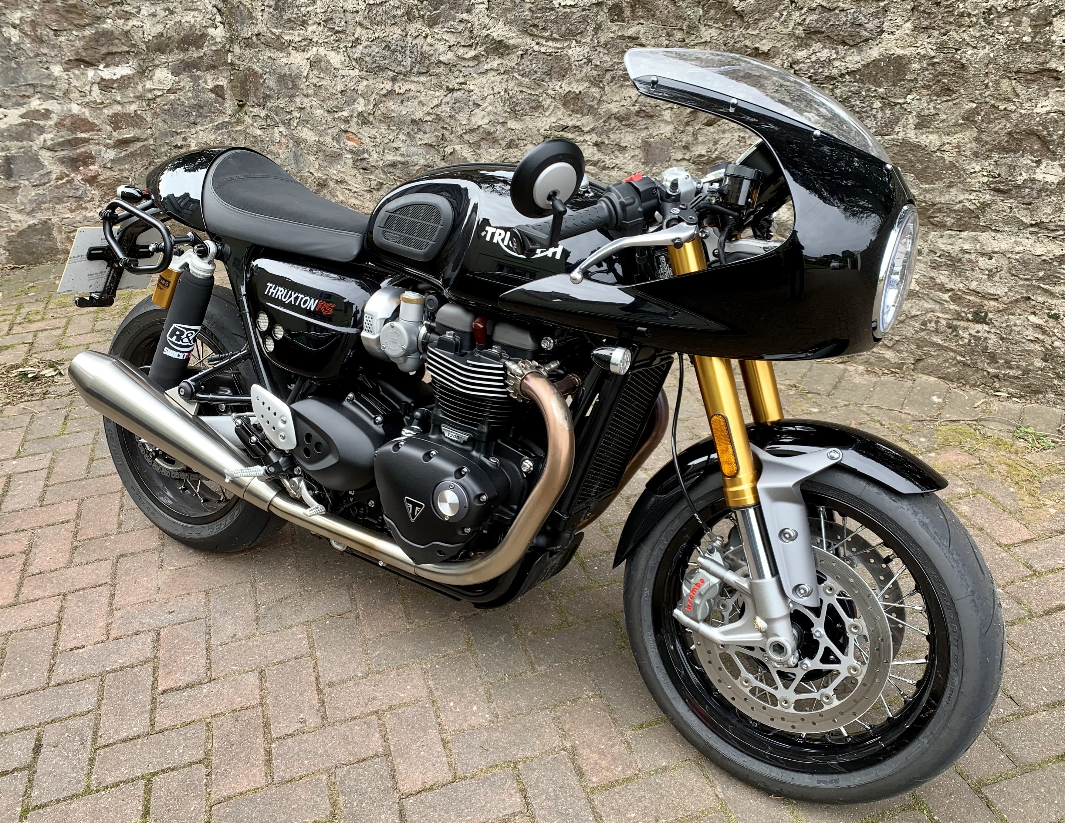

    Job done.
    Some fiddly tasks but if I can do this, anyone can!
    Did not need to drop forks, remove fairing or ease cables.
    I watched a chap bodge the job on YouTube, which nearly put me off but with the right tools it’s not a difficult job really.
    Radical change in riding position but still looks nice.
    Thanks Andy for your helpful advice.

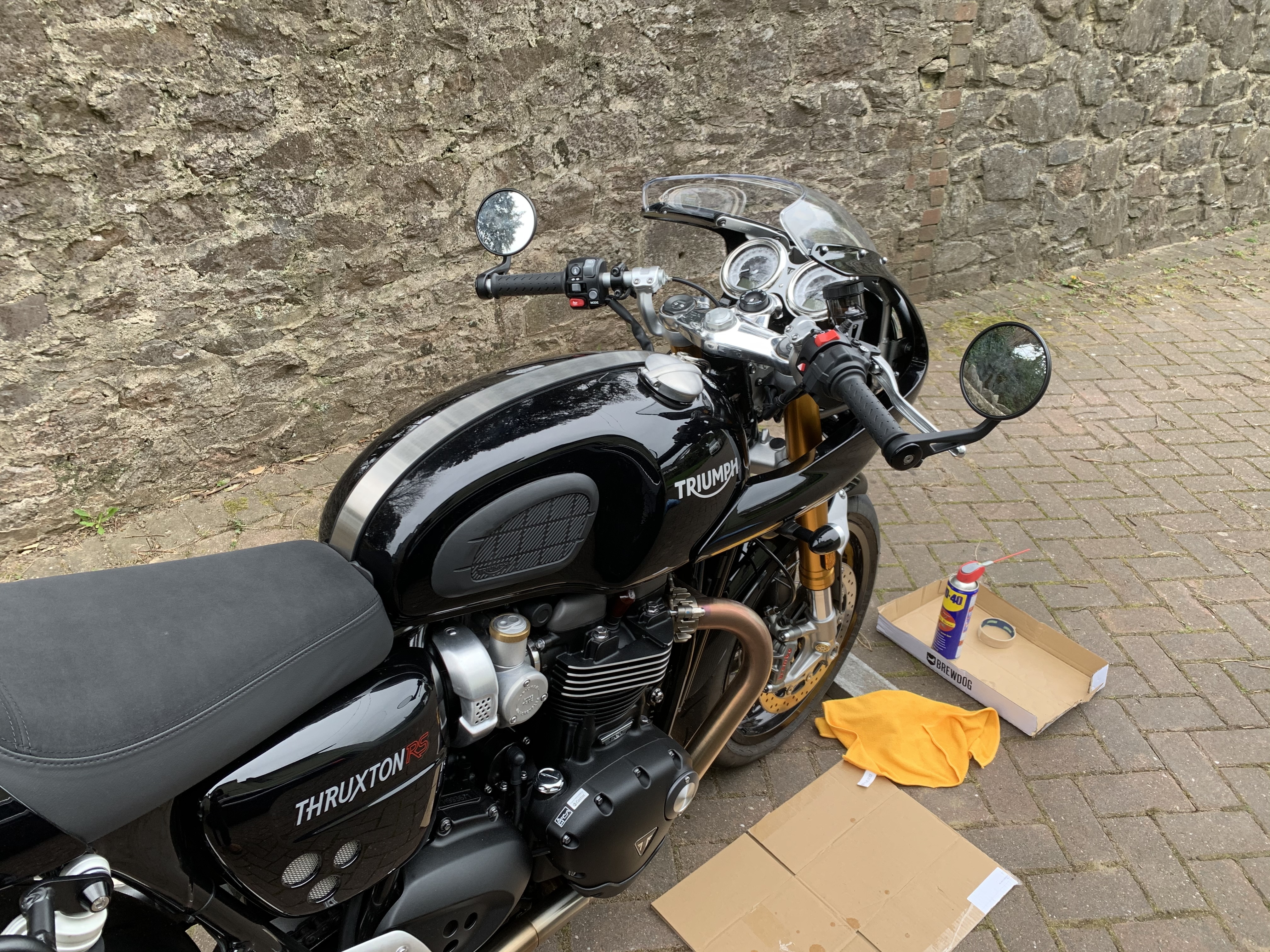

  6. Cooky Boy
    Cooky Boy Active Member
    Jan 25, 2021
    183
    Devon, UK
    Mid riser change. Point of no return.

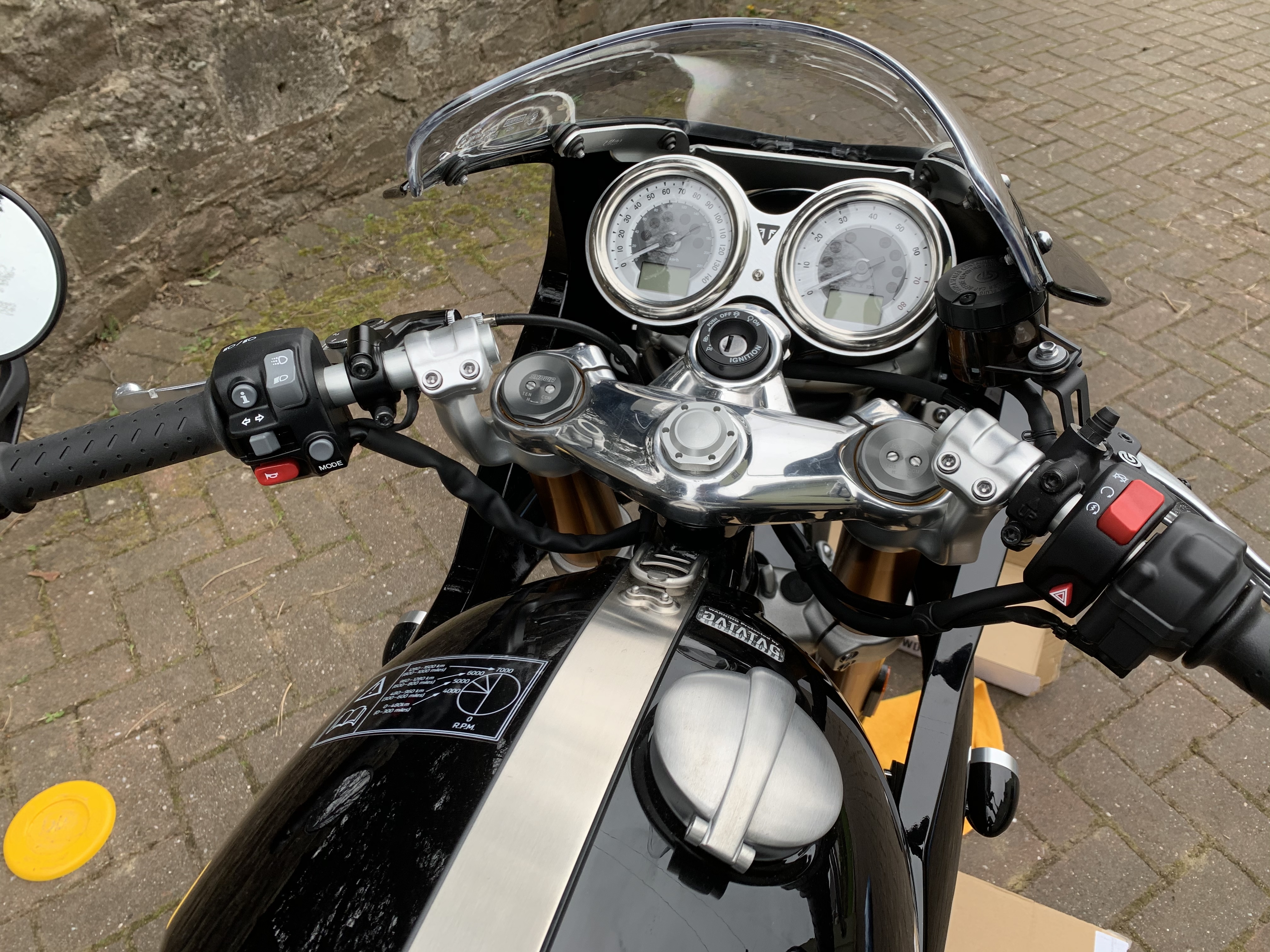

  7. Cooky Boy
    Jan 25, 2021
    183
    Devon, UK
    Pre and post op!

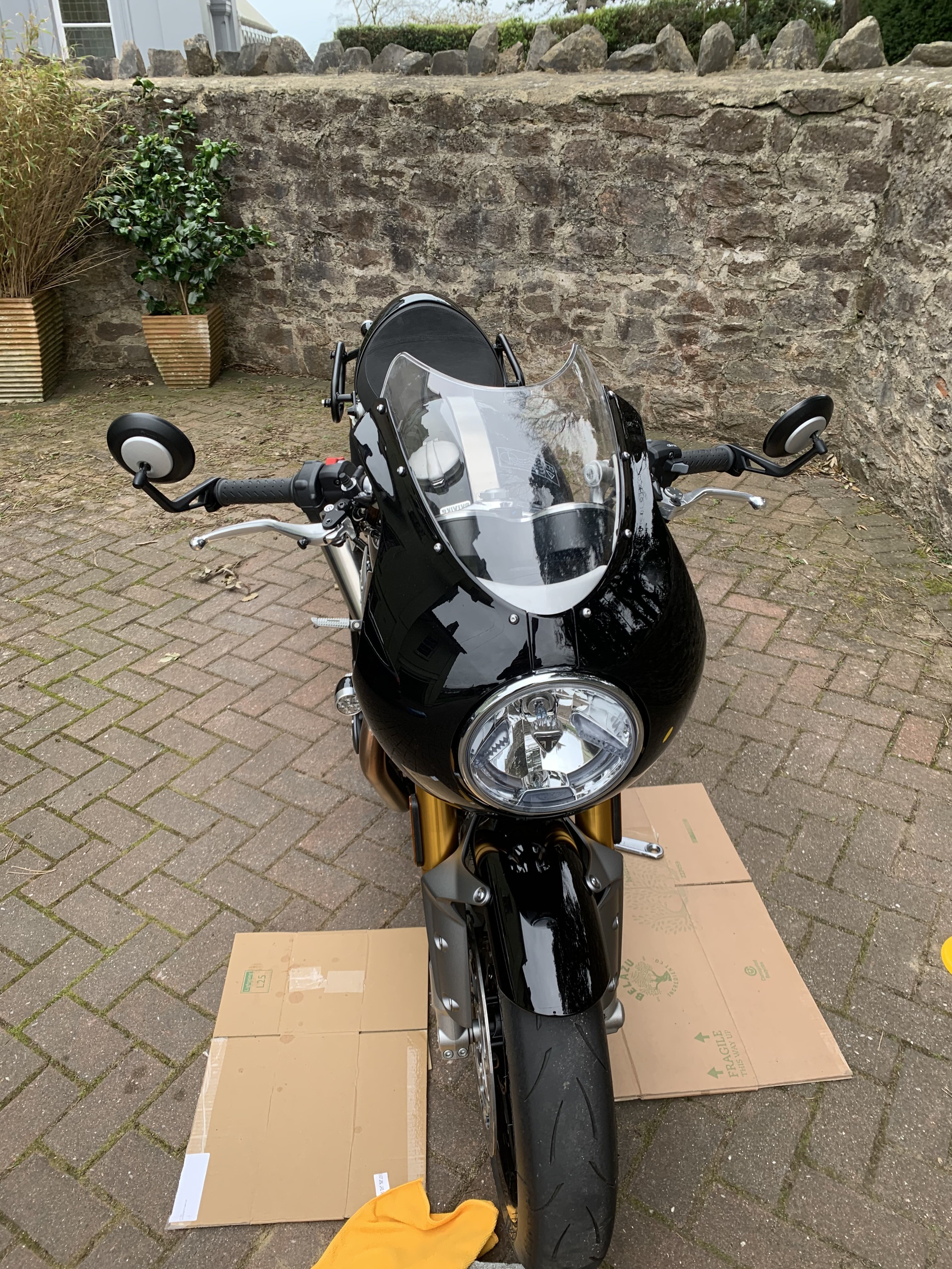

  8. Cooky Boy
    Jan 25, 2021
    183
    Devon, UK
    One more from in front.

    Road test complete.
    Bars higher and closer. This has completely altered the riding position which is far more comfortable but with slightly less front end feel as might be expected.
    Feels like a very different machine but looks have not been ruined. I think the higher bars are a functional improvement if not an aesthetic one.
    I’m sure it will be much better for the type of riding I do on undulating country lanes.
    Very pleased so far.
