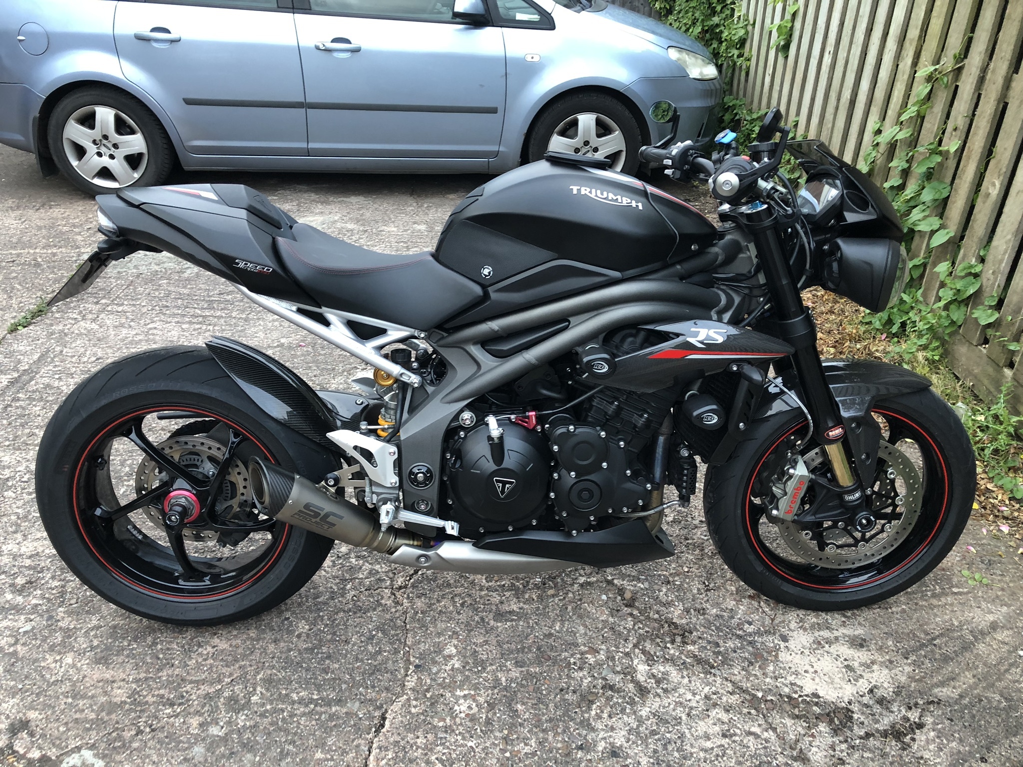

    So she’s back with me!
    Got on it earlier and it wouldn’t turn on, arsing around for 10 minutes with the key fob under the seat it suddenly kicked into life after numerous tries, then immobiliser fault on screen and key out of range!!!! FUCKING BIKE!!
    Eventually it started so I took it out for only about half an hour but the quickshifter blipper felt good, hopefully it’s fixed, stopped at Sainsbury’s and bought some new batteries for the key fob, problem solved! I’ve now got 2 spares and a tiny Allen key under my seat cowl !
    Hopefully I can now enjoy the bike,if the quickshifter plays ball otherwise if it happens again I’m gonna throw it in the sea!

    Hope its sorted mate, mine was spot on the other day, rode it for hours without fault...... quickshifter used over 6000 rpm.
    Ya bike looks class with that zorst on Andy! Good work, I'm still pondering on one myself.

    Cheers pete, when it’s working it’s a great bike, the exhaust really crackles and pops coming off the throttle, love it

    I may have to invest hahaha, i do love the look of the standard cans..... suppose it can be the best of boths worlds. Is it loud when the baffles in?
  13. Andybow
    Andybow Well-Known Member
    Jan 31, 2018
    160
    Uk Exeter
    It’s not obscene with the baffle in, although I have a extra longer baffle for quieter trackdays, I like a nice noise without it being antisocial

    yesterday was out all day, did 250 miles and danced on the quickshifter / blipper all day, smooth as silk now!
    Hopefully that’s the end of it as it’s a great bike when working right.
    Maybe need a bit more of a baffle in the exhaust as it’s a little droney cruising at motorway speeds.
