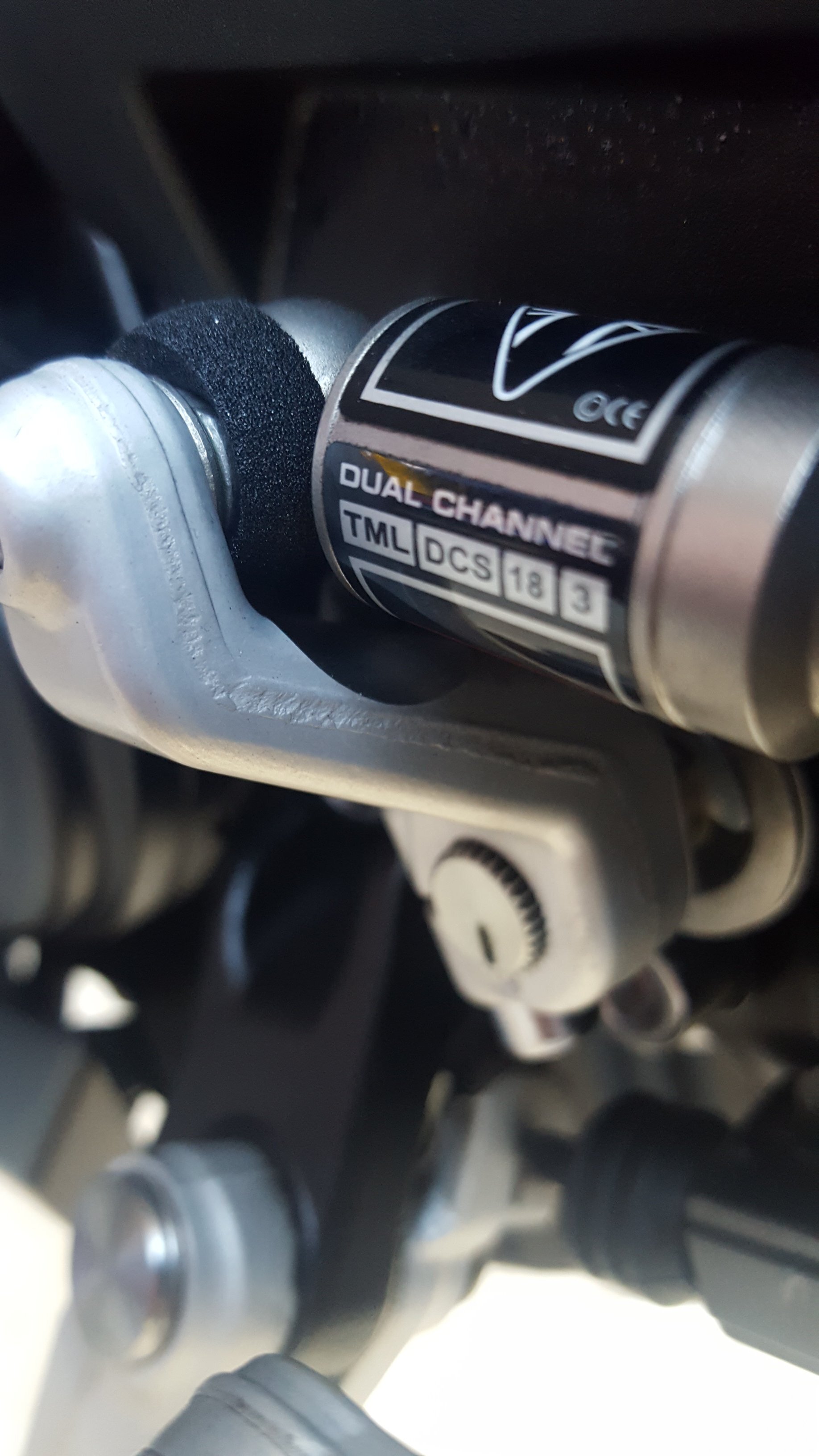

    Hiya matey, it's a triumph part, made by triumph UK, tell them to try better.

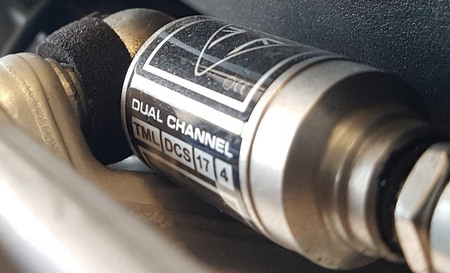

    Hiya MrTriple
    As promised this part was fitted to stop the shifter switch catching. Please see attached.
    First pic is in neutral.
    second pic is engaging 1st gear.

    Thanks for that pete. Did your dealer cut it out or was it from triumph themselves?

    Hiya Andy
    Triumph UK part, fitted by the dealer. :blush: after reading you post earlier it got me to thinking, how has your dealer delt with your problem? To me it sounds like they couldn't give a shit.

    That's brilliant Pete - many thanks for posting up the details.
    The existence of a modified part is obviously proof there's a problem, so it's really valuable to anyone attempting to challenge any less than helpful dealers.
    Even though mine appears to be OK, I'll register a 'potential problem' with my dealer when it's in for service on Saturday - that way it will be on record for any future warranty (or out of warranty) claim.

    Yes definitely do it, I think mine was the first to have that part fitted, just goes to show that the boys at my dealer are on it to try and get it sorted for me which I fully appreciate.

    I'm guessing that's after going from neutral to first?
    A pic engaging first from second gear, which is a longer movement, might be interesting......

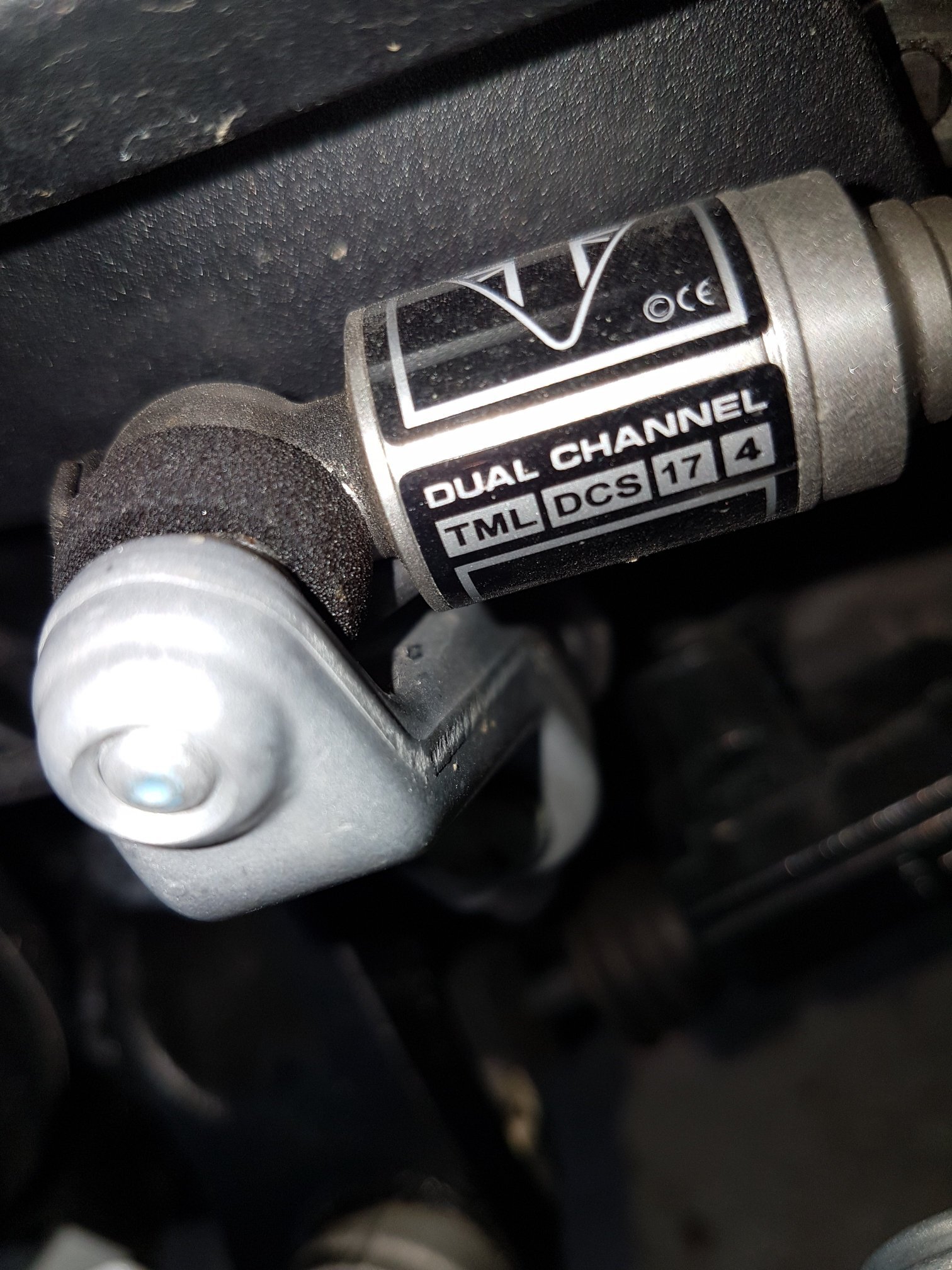

    Checked my QS, which is from early April 2018, no cut out on it, but I've had no problems either.
    Bike's being serviced today, I'll have a closer look to see if there's any marks to indicate contact when I get it back.

    Here's a couple of pics of my QS One showing the clearance on 2nd to first shift and one showing what is possibly a small mark on the shifter although I'm not convinced it's a contact mark.....
    QS was fitted on bike new in April 2018

    I had a closer look at mine (also fitted March/April 2018) and I have a similar mark that I hadn't spotted before (made easier to identify by your pics, together with the general info in this thread that helps with what to look for).
    I'm going to ask for the modified part to be ordered when I go for service on Saturday - it will be interesting to see how the dealer reacts, given that I'm not experiencing issues.
    I don't use the QS that regularly, and then typically only between 1st and 3rd gears. so I can't help thinking that if I were a bit more feisty with QS usage, I'd be having the same gearbox issues as others are experiencing.
