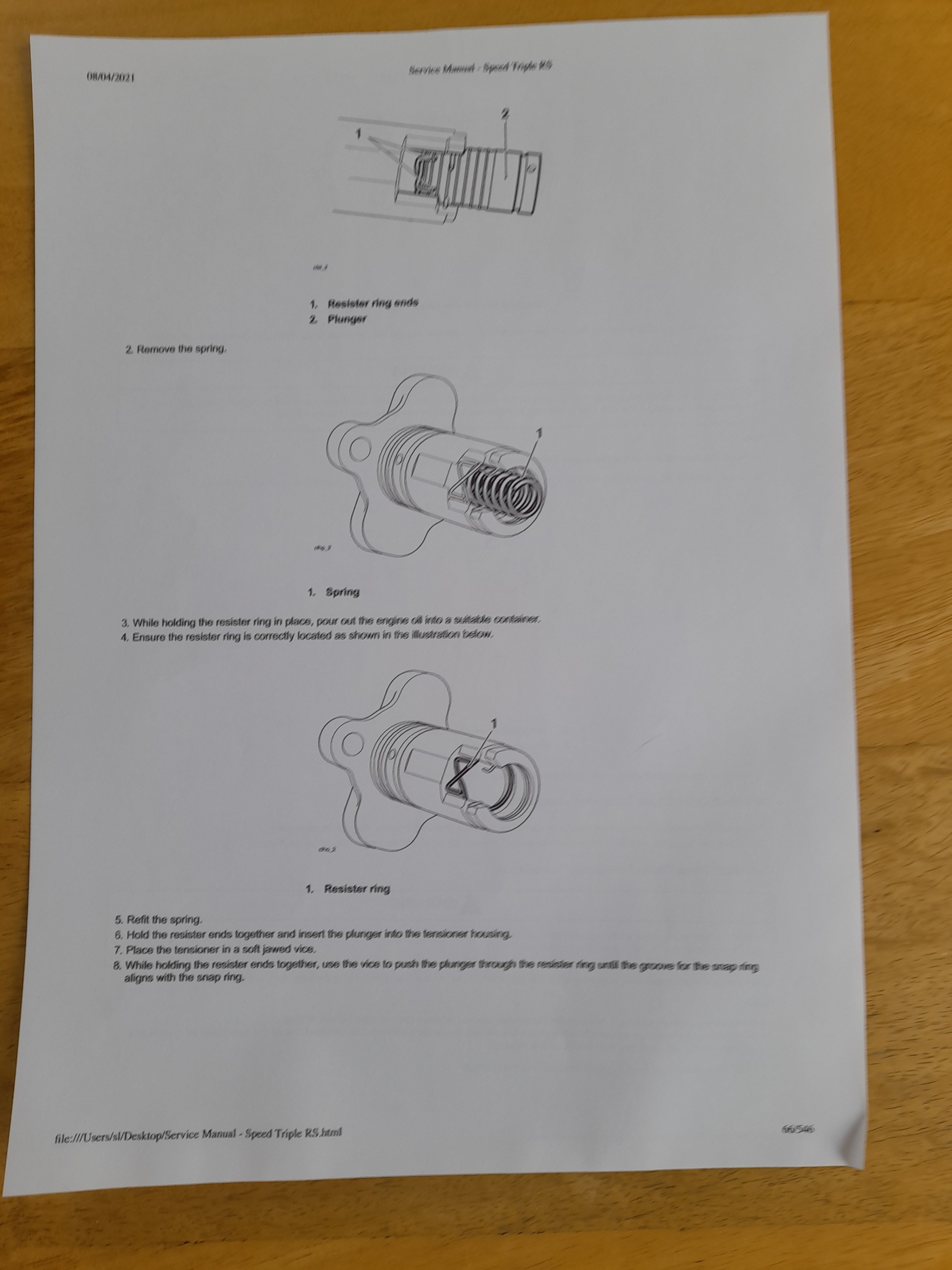

    It's unlikely that any damage has been caused as the camchain is still under spring tension until fully tensioned by the oil pressure. If you choose to remove the tensioner for inspection I've attached pages from the Service Manual outlining the procedure.

    I'm assuming the tensioner on the ST is the same as on the classic twins and indeed all the other hydraulic tensioners I've ever come across.
    If it was me I'd remove and refit the chain tensioner.
    Hydraulic tensioners have a spring assisted ratchet system which stops it fully retracting when the engine isn't running. When you remove the tensioner it will extend itself and lock in the fully out position which means you cannot refit it without following the reset procedure which temporarily locks it fully in. Once refitted, turning the engine over manually releases it and the spring/ratchet setup comes into play. Starting the engine will then apply further pressure from the oil/hydraulic function.
    I had a slightly noisy tensioner on my second Street Scrambler. I removed it, couldn't see anything wrong, reset and refitted it and the noise was gone! Go figure.
    My first Street Scrambler ALWAYS rattled for a couple of seconds after a cold start, something the second one and my current 1200 never did/do.
    Edit.......personally I don't buy the air lock theory. I always prefill a new filter on any vehicle I work on as a matter of good practice but that's just to limit the delay in pressure build up on restart. Starting the engine after an oil and filter change is not the same as starting a rebuilt engine for the first time IMO.
