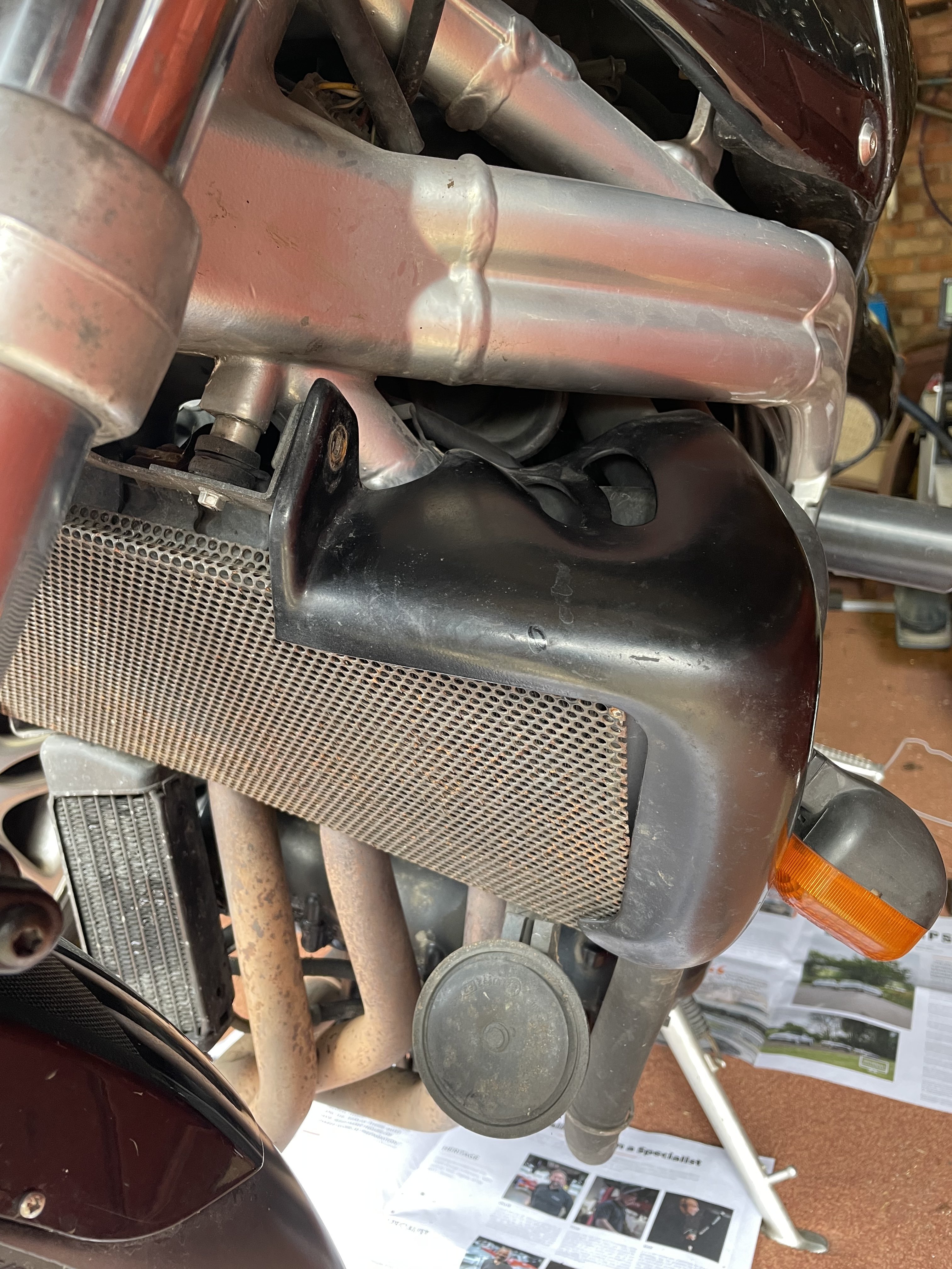

    With the indicator and top fastener removed the cover should easily be removed. I would not pull too hard as you might break the plastic. Try prising it carefully from behind or use dental floss or similar to cut through whatever is sticking it in place? Whatever you do don't break it :eek:
  2. Francis Robertson
    Francis Robertson New Member
    May 14, 2022
    11
    Northampton, England
    Sadly can’t get the indicator off because I can’t get behind to loosen the bolt… I think it’s the actual indicator that’s preventing removal of the cover.
  3. TRIPLE X
    TRIPLE X Senior Member
    Sep 1, 2021
    357
    Downham Market, Norfolk
    There is a nut securing the indicator which you need to remove with an open ended spanner. It should be accessible. It might be hidden under a rubber sleeve?

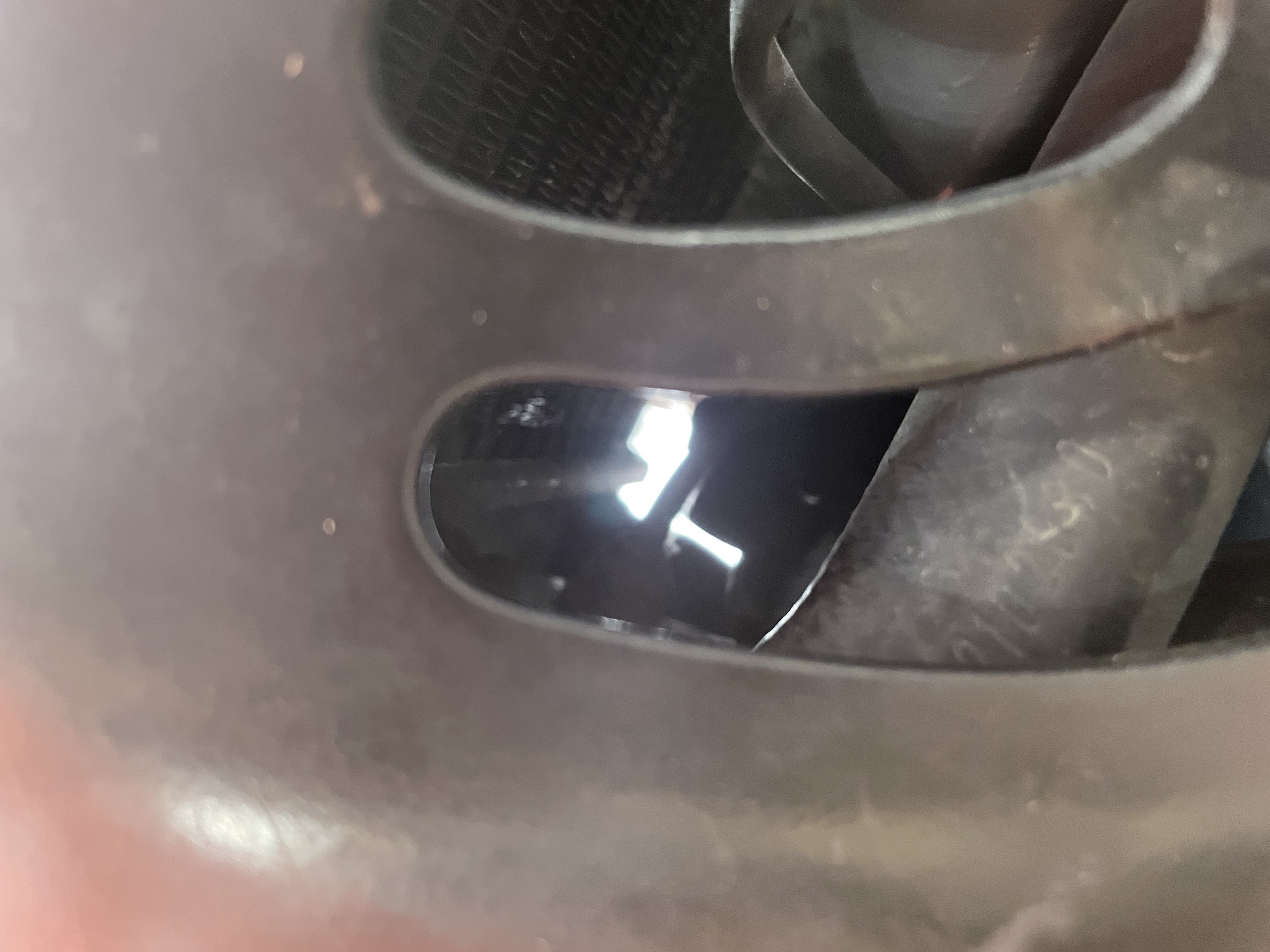

  5. Francis Robertson
    May 14, 2022
    11
    I can get a spanner on it but can’t manoeuvre it due to limited access. nightmare.
  6. TRIPLE X
    Sep 1, 2021
    357
    It should be possible? What is restricting moving the spanner?

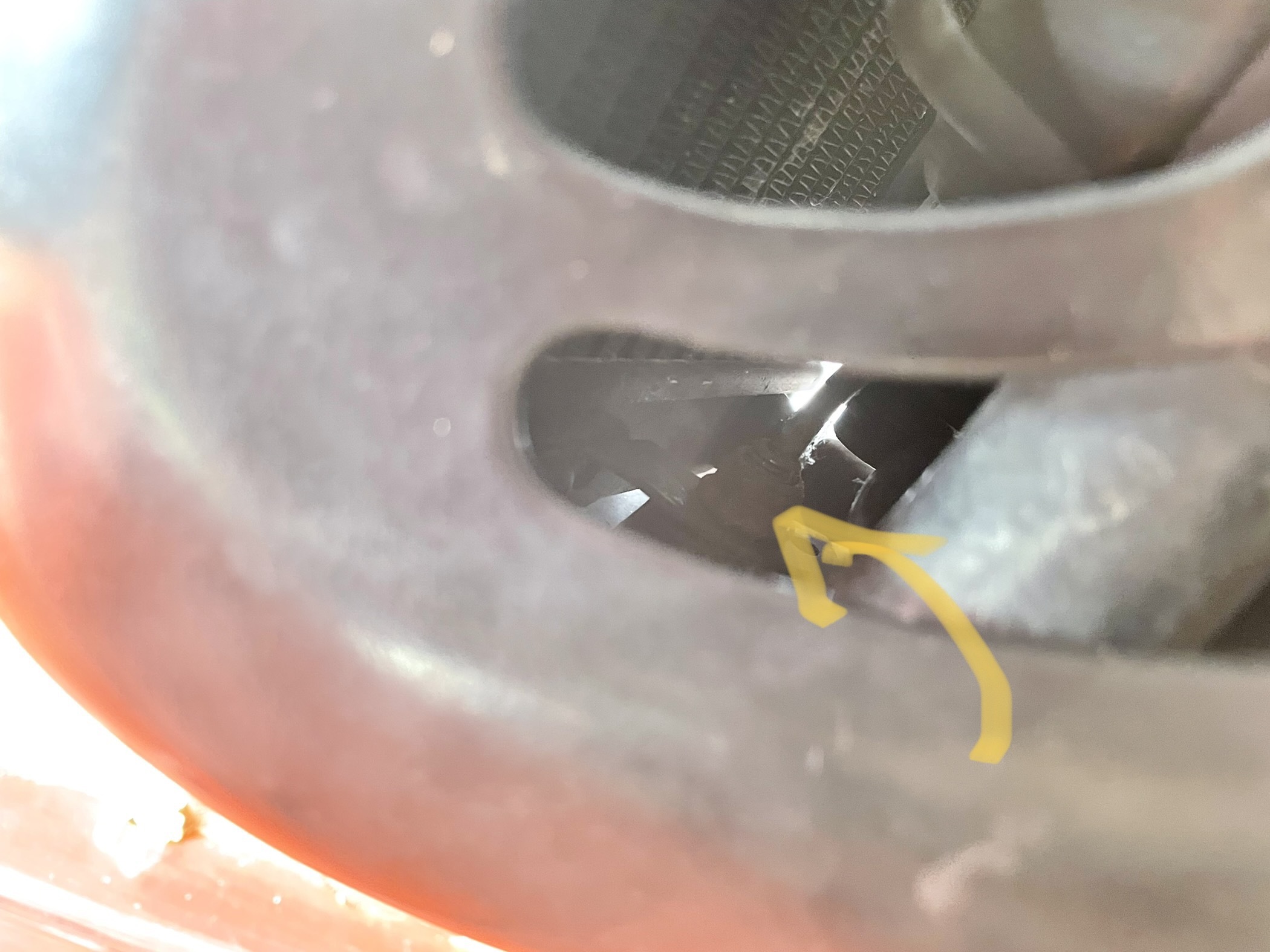

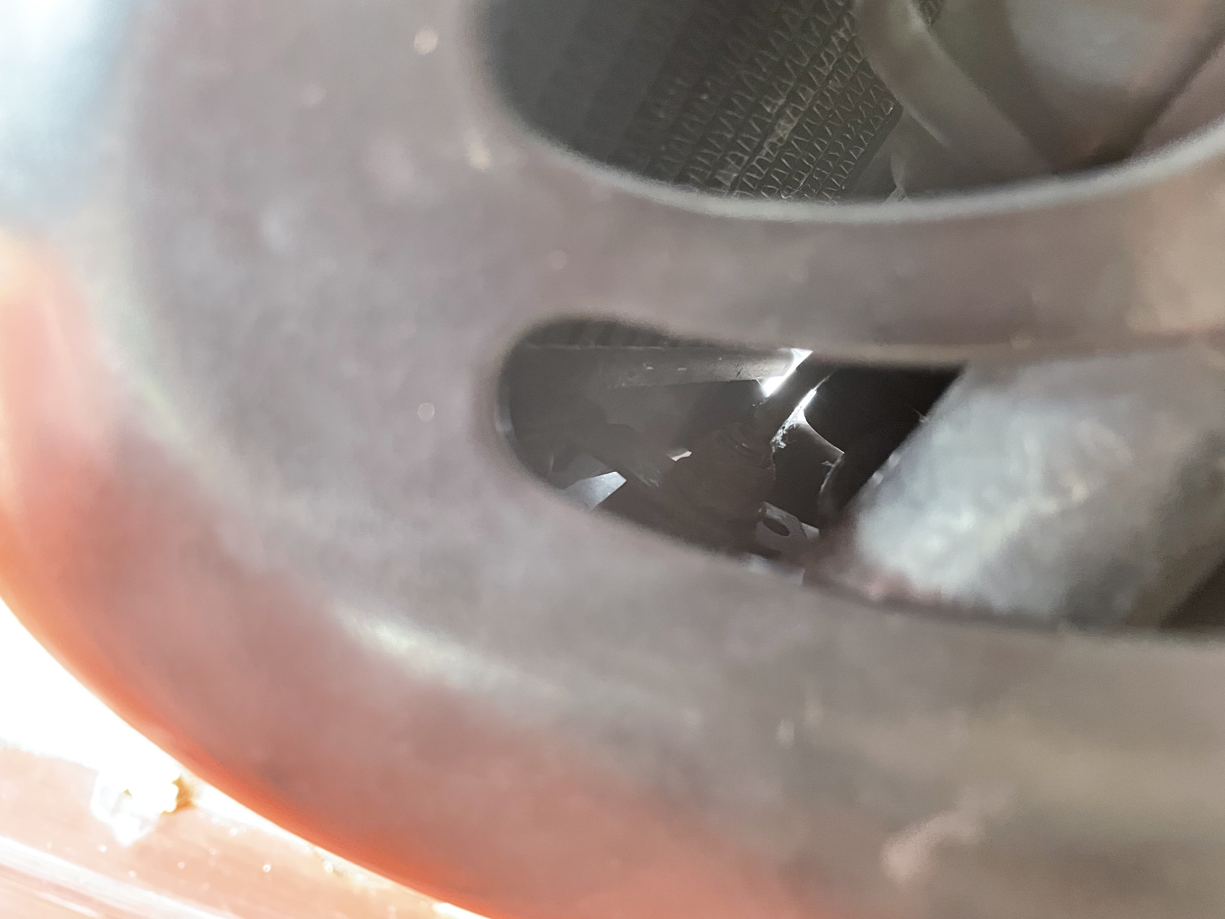

  7. Francis Robertson
    May 14, 2022
    11
    My only access is through this gap as there are pipes beneath the bolt. I’ve put an arrow showing the bolt. Any suggestions would be welcomed but I think it’s going to be a trial and Break things.
  8. TRIPLE X
    Sep 1, 2021
    357
    Access should be possible from the rear behind the plastic cowl, not through the slots. That cowl should come free anyway as the indicator is broken and hanging off.
  9. sprintdave
    May 25, 2014
    1,554
    Birmingham
    Yes you have a shroud fitted. Can't you get the nut from below? There's no way you will get it from through the gap, it is the wrong angle for a start, the nut is on the end of the indicator stem Otherwise as said before remove the shroud first.

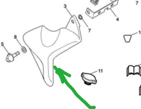

  11. DanielB
    DanielB Noble Member
    Jan 13, 2019
    881
    393
    Abingdon, Oxfordshire
    Hey Francis, I think a thorough dump of photos front and rear looking of this shroud, all possible angles, will help get a resolution to this question.
    I had similar fairings on my triple and it was possible/easy to get a spanner from the rear (going forwards) between the fairing and the engine, to get an open ended spanner in and on to the nut that holds the shaft of the indicator.
    But we dont know if you have that access...perhaps you don't.
    In which case it is likely just as easy to remove this piece of bodywork, indicator included...and once removed, then you'll see the retaining nut.
    You may also see an exploded view of it all on a parts diagram (worldoftriumph ?) that'll clarify it all for you?

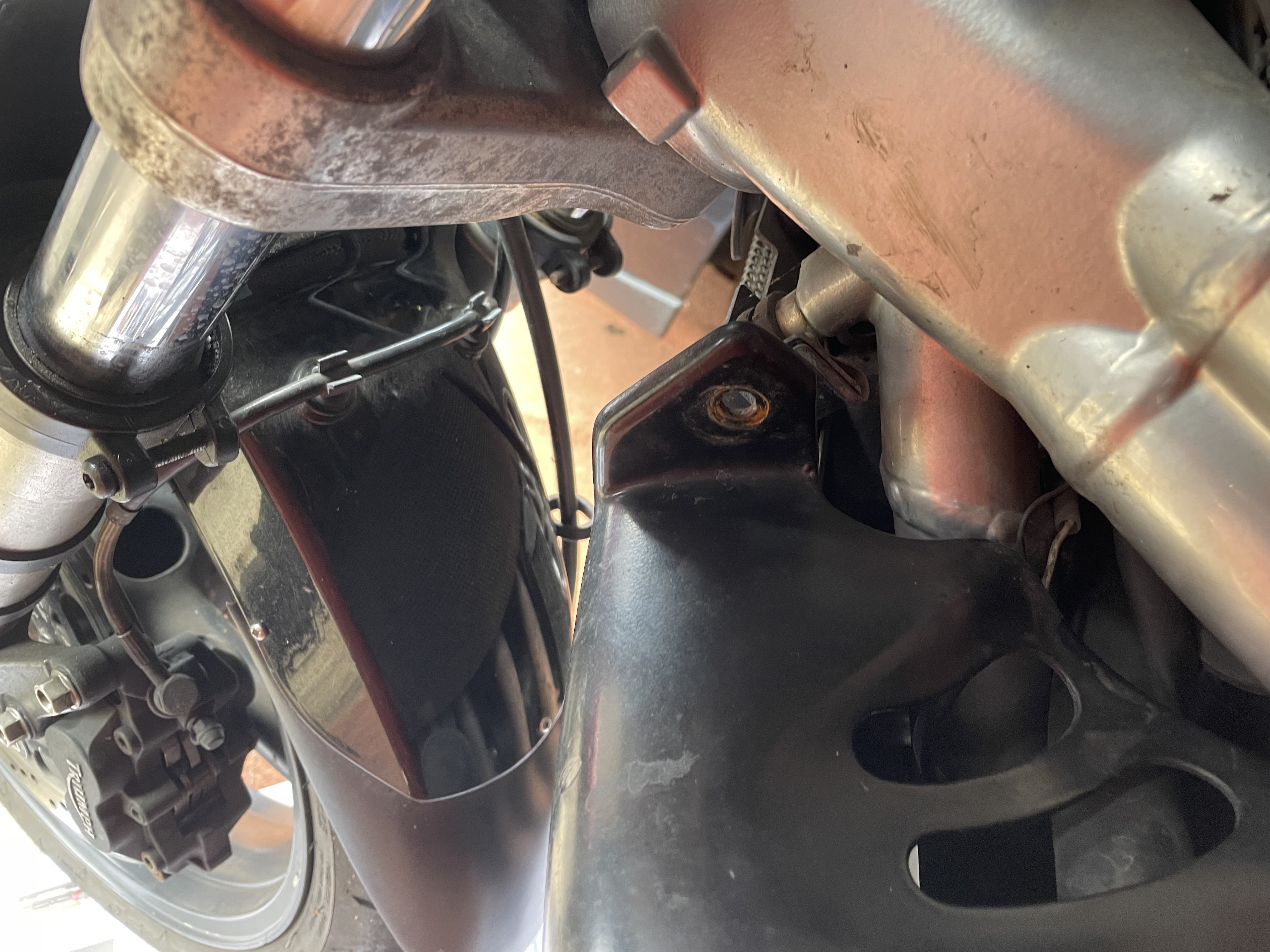

  14. DanielB
    Jan 13, 2019
    881
    393
    In which case you should be able to get a spanner up here...
  15. Francis Robertson
    May 14, 2022
    11
    All, I managed to get the indicator done. A right faff given that the replacement eBay wiring was not the right connector. I fitted the OEM wiring to the eBay light unit and managed to get it on. A whole Sunday that took… but worthwhile in the end.
